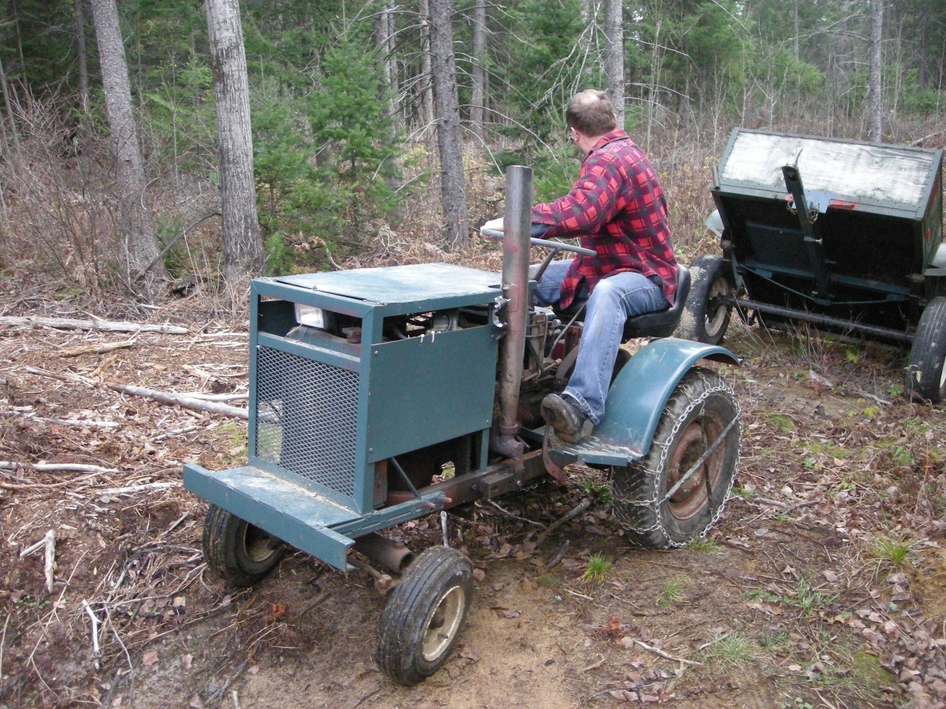

two things, great project and I would keep the auto tranny because the torque convertor gives you slip so you can move very slowly just off idle but will use your brakes alot to control speed on hills and such. Second thing is, when you plan to work your tractor and want to keep a certain speed, it will bog under load unless you have a method of adding more fuel. You will get tired of using the gas pedal. I had a gas Unimog and it had a hand trottle but no Governor and if you hit the clutch the engine would overrev. I received a neat homemade tractor. It has a very small 4Cyl, 4spd, gear reduction box with the output driving a chain to a ford 9" diff faciing backwards. It has a governor so I set the RPM and it stays there whether I step on the clutch or go up a hill. Can't find too many pictures as I robbed the Alternator for my MF135 a couple years ago. I added fenders, a hood and bumper, grill guard and a go-cart style disc brake on the Diff.
