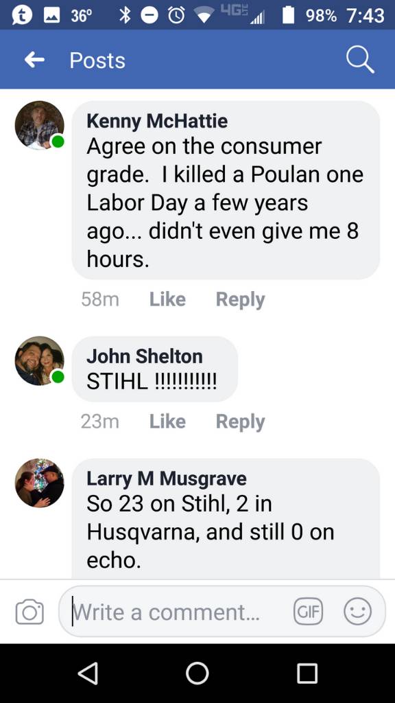

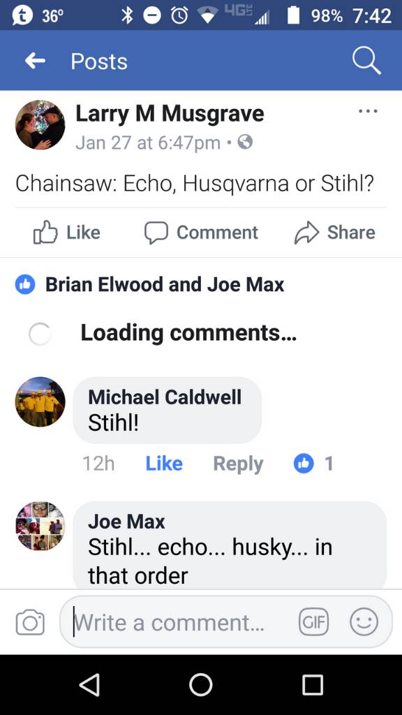

I went on Facebook last night to verify what I suspected, that Stihl just flat out out-sells any other brand by an extremely huge margin, at least in the Eastern Ohio / Western Pa area.
In just over 12 hours:
23 on Stihl, 2 on Husqvarna, and 0 on echo.
Stihl has pretty hard core market saturation over here. 1517143565-picsay.jpg1517143594-picsay.jpg
