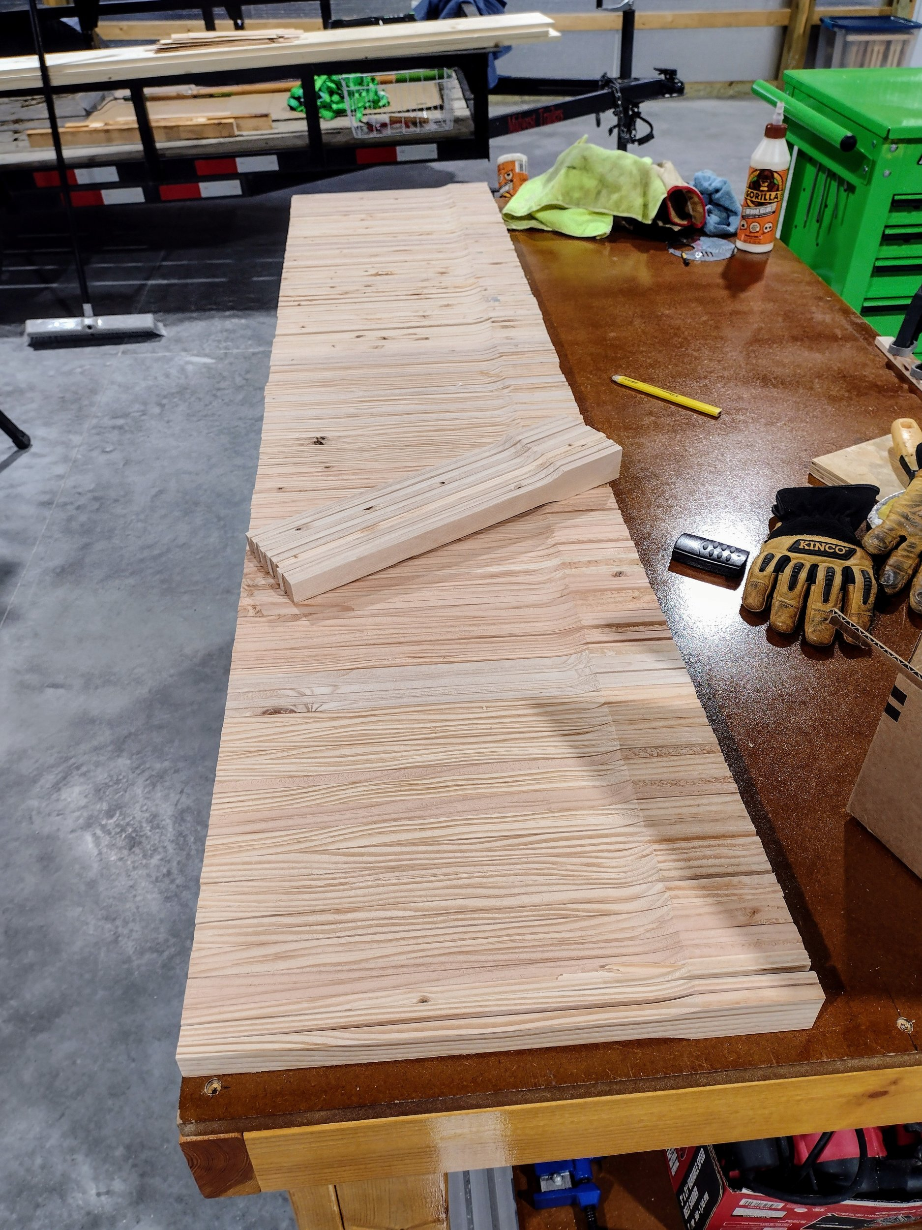

How do you make those sidebars efficiently?
All the best, Peter
I use 2x4s. Cut into 15 9/16” lengths. Then I lay them flat and use a 1” dado blade to create the taper on both sides of the 2x4s. Then I rip them all 3”8 wide. Basically zero scrap!
   / Honey bees #143
Thanks! I was having trouble imagining how to make the taper in an expeditious manner.

Some folks taper them individually on a router table, which is much more tedious
   / Honey bees #145
I use a jointer for the taper. Before cutting the ends out, I have a jig made to hold the 2x4 or 2x6 to cut the top & bottom bars notch using the dado blade.

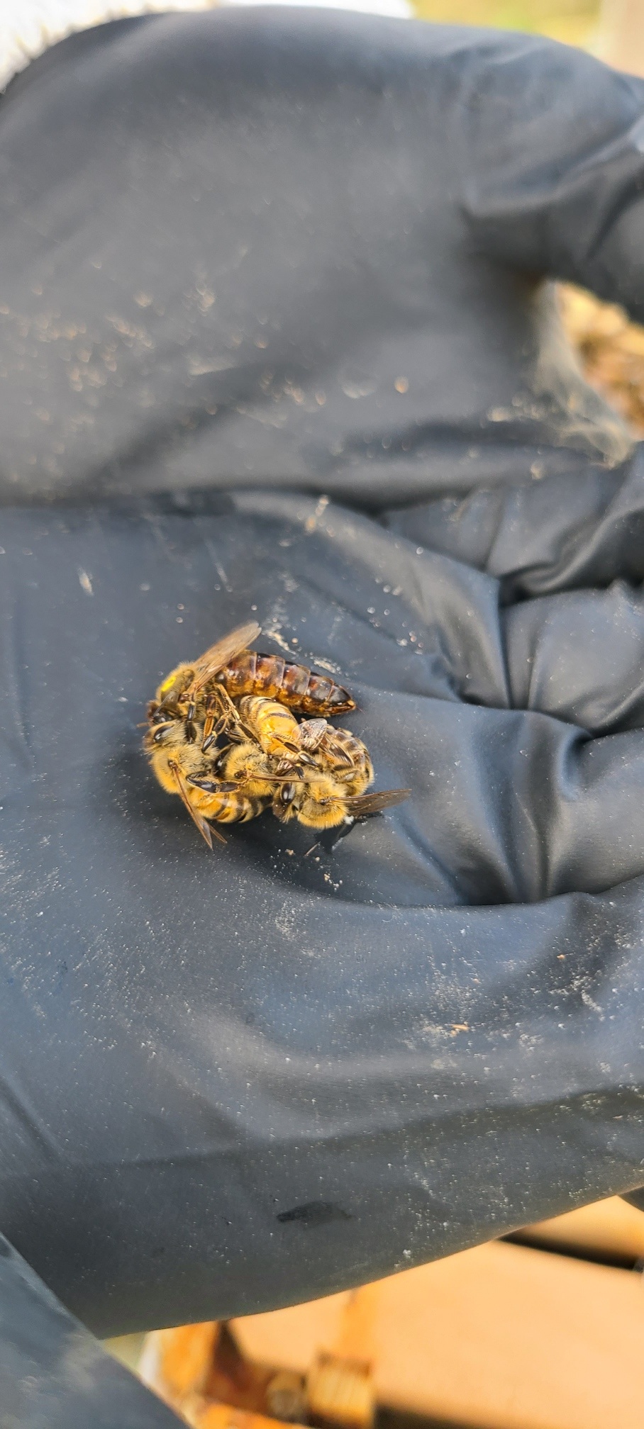

Didn't take many pictures but I did a deep inspection on my hives yesterday. I made 1 split on a large strong hive that had several queen cups. Also, messed up and killed a queen on a different hive. My wife was helping and I held a frame while she caged the queen and she squished the queen in the cage. It looked like she may not have gotten injured but when I released her the workers balled up on her, biting and stinging.

LBBJ
There are eggs in the photo of the Queen so they probably have queen cells started already. Check that hive in 6-7 days and be ready to make some nucs.

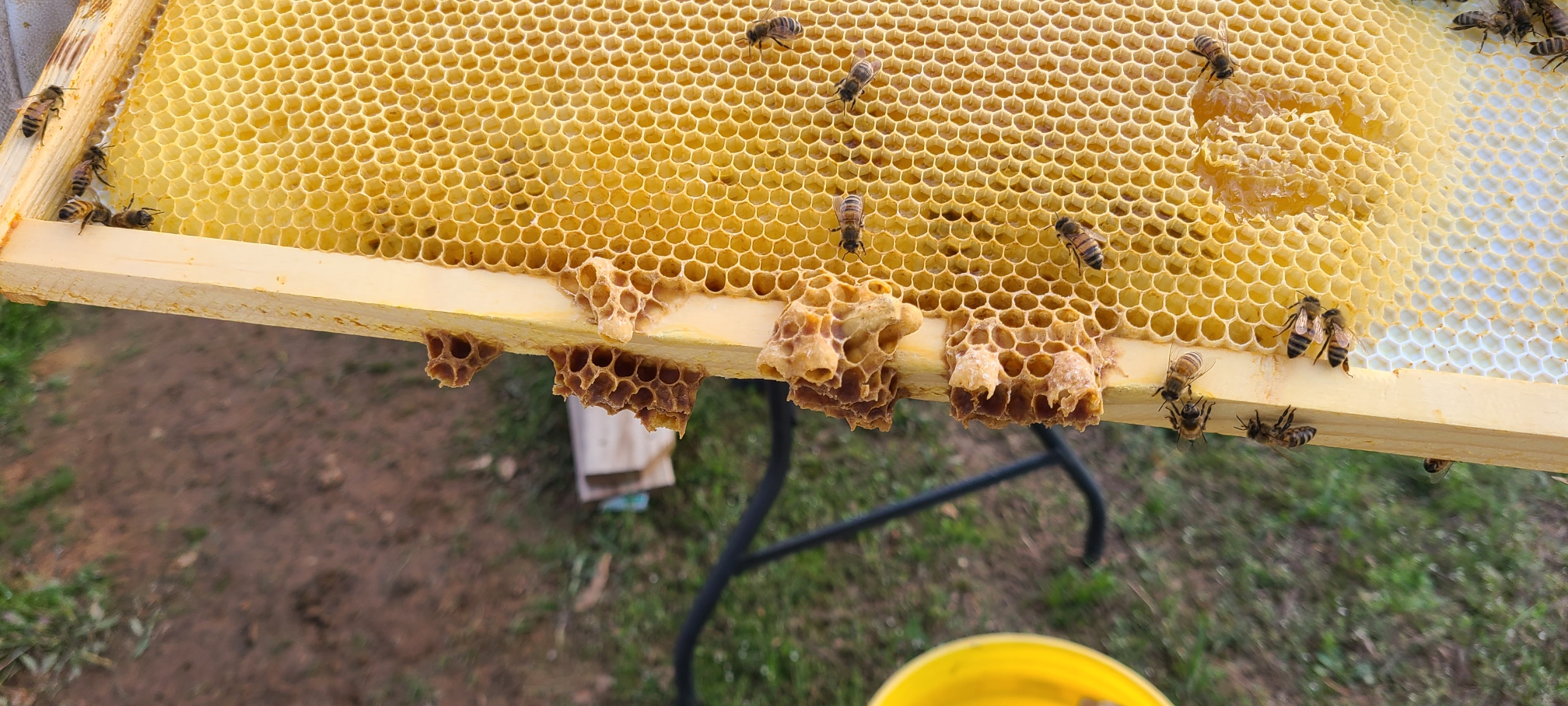

After the inspections and accidental queen murder last weekend, the girls got very angry. I put out a little bit of sugar water as there were a couple hives a little light from such large numbers and rain for several days in a row. They chased me off from the open feeding area. Then I stood 10 feet or so from the side of my hive stand. I got chased and stung in the back of the head...
I went ahead and re-queened yesterday. In doing so I set up 2 splits with emergency cells. Then I went ahead and inspected the remaining hive that was perfect last weekend just because I was there. Good thing I did. It had way over a dozen swarm cells. A couple were already sealed. I took the queen and several frames of brood and food and made a strong split with it also.
Just like that I went from 3 hives to 7 in less than a week. hopefully they all survive. 3 are currently queenless with multiple emergency cells or swarm cells. I've got my fingers crossed. I'll check back in on them in a week or so.
