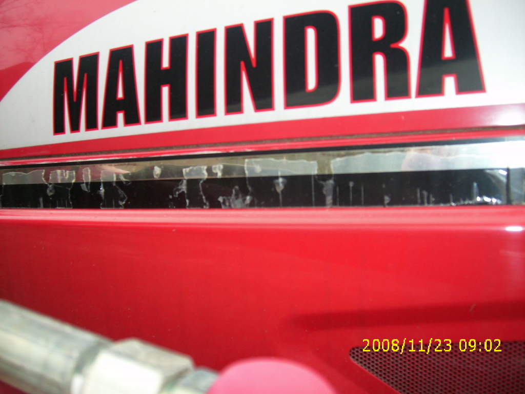

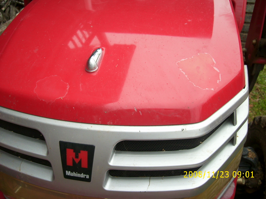

I noticed on the hood of my 3215 that there are three spots that are starting to peel. It looks like the clear coat is coming off. I also included a pic showing the stripe decal under the Mahindra logo on the side of the hood. This has always had a film which has been peeling off since new. Always thought this was just the protective cover for the decal. The tractor sits outside 24/7. :( What do you all think?

Acid rain and weathering will take it's toll. Do you have it covered with a trarp or anything ? If not I would do that for sure and the few times I have had to leave my tractors outside overnight I always worry about mice getting in under the hood or cowling and chewing wires that could cost a fortune to find and fix.

The technical term for the hood problem, is delamination of the top, (apparently clear), coat. If this is indeed the original factory paint, there was a defect in the product. This type of delamination, (between the color and clear coat), is more common in a part that was repaired incorrectly. An area which was not repaired, but clear coat was applied over part of the existing finish. The bond between the color and clear is very difficult to break when the products are applied properly and together. Even if you bought this tractor new, it is still possible, even at the factory level, this has been repaired before you received it. Which would be another possible explanation.
The decal does look like it had a clear liner that was supposed to be removed, but was not. That, or it was very poor quality.

It's an '06, bought 12/06. I've never seen peeling like this before so wasn't sure if it was the clear coat or some other type of finish. The paint underneath is duller in comparison. I've had many cars older than 3 years that sat outside 24/7 and have not seen peeling like this. Took the photos this morning. Sorry about the wrong picture dates again. Really need to fix that.

I am actually quite surprised that it may have been clear coated. It is really not necessary on a tractor. And in the end, it has actually created a problem.
It is going to have to be stripped, and refinished. Spot repairs won't stop future peeling.

Since it's occuring on both ends of the hood I'm thinking it was just a poor factory finish than a refix later. The whole hood surface would have had to been redone. I'm more inclined to say the finish is flaking off now rather than peeling. It's more brittle and flakes rather than a thin cohesive skin that can be peeled. Wondering if there is something to aid in removing this without hurting the paint underneath? Or should I just apply some carwax to the exposed areas and let nature remove it little by little. I don't forsee me entering the tractor in a beauty contest any time soon.:D
Any trick to removing the skin over the decal completely and easily? It's never seemed like it wanted to be removed completely. It sticks real good in some spots and other areas is just begging to be removed.
Peeling like that, (sorry, that is what we call it), is exactly what would happen, if the hood was say repaired and painted with color in the middle, and a clear coat finish was used, (improperly), on the whole piece. I have seen, and repaired this on cars, hundreds of times.
Unless the clear blows off entirely, with a pressure washer, or air hose, (this almost never happens), you will have to strip it. Even if it all comes off, you will still need to sand the color, and very likely reapply color, or the same thing could happen again.

Just wanted to post an update. Thought I would contact Mahindra directly about the hood so went to the website and tried access through the 24/7 customer care. Wouldn't accept my serial number so I e-mailed Mahindra asking for help with the website. Brenda from Mahindra e-mailed me back saying they had updated my serial number in the system. I tried again and it worked!:) Some interesting information there but nothing really applying to my situation so I e-mailed Brenda back with an explaination and pictures of the hood. She e-mailed me back saying that she forwarded the photos to the Mahindra service manager for my area and the next step for me was to contact the dealer to start the process taking care of this under "Goodwill" since it was no longer under warranty.:cool:
So I decided to take a drive to my dealer with copies of my photos and the e-mail. When I arrived at the dealer I took notice that there were very few tractors on site - a couple of New Hollands and 1 Mahindra. It's a small dealership so I usually just talk to the owner. He said his whole tractor business had been so bad last year he and Mahindra had parted ways, but he was still willing to listen to my situation and help.:thumbsup: When I mentioned the "Goodwill" option he chuckled and said that means it was up to the dealer to decide to pay for it! I told him I didn't think it was the dealer's fault and wouldn't hold it against him if that was the end of the story but he said the Mahindra service manager was a good guy and he would give him a call. So he called him on his cell phone right then and even though I was just overhearing the conversation I got the sense that the service manager had indeed received my photos from Brenda and they were going to work with my dealer and have my dealer get some bodyshop estimates on the refinish of the hood.:)
That was indeed the conversation, so the owner said he would give me a call in a couple of days and let me know what's up for sure. Don't know how the cost is going to split up so I will wait and see, but have been pleased with the responses and sincere concern from everyone involved so far!

I have one of the very last 3215s before they went to the 3316. My hood is not clear coated, so either Mahindra changed the finishing process that was done or your hood was repainted before you received your tractor.
