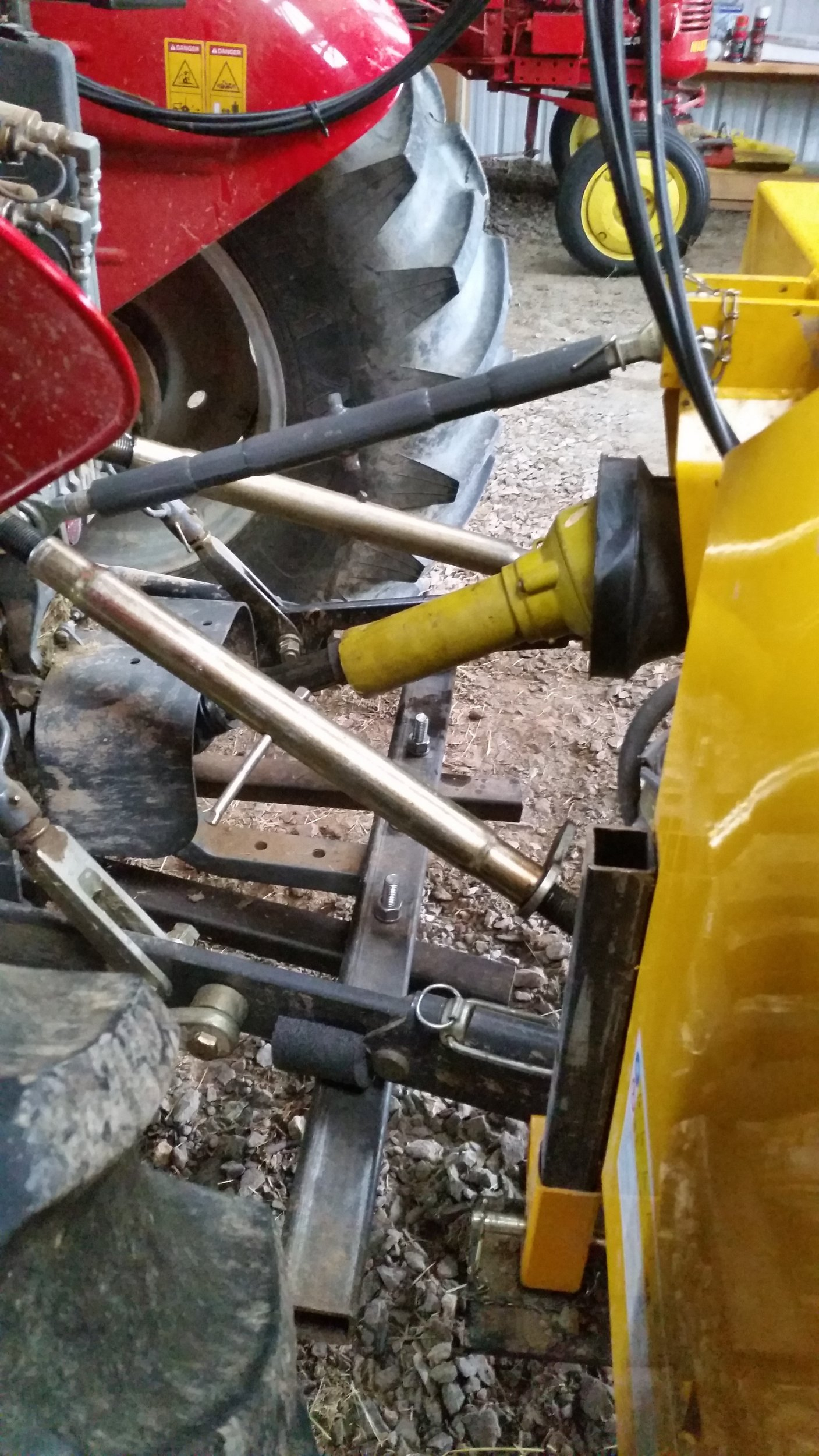

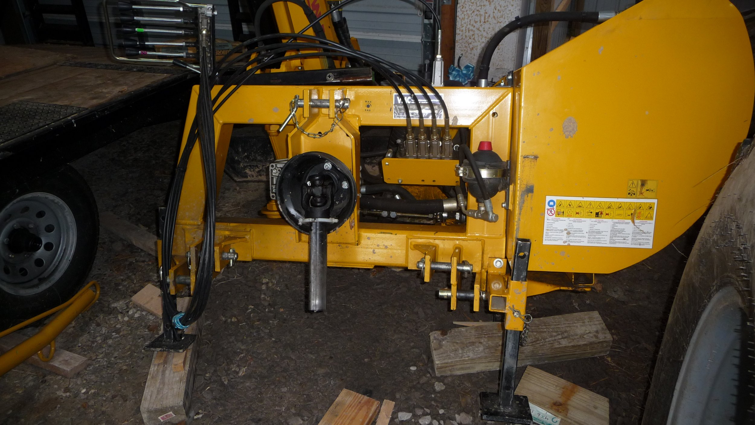

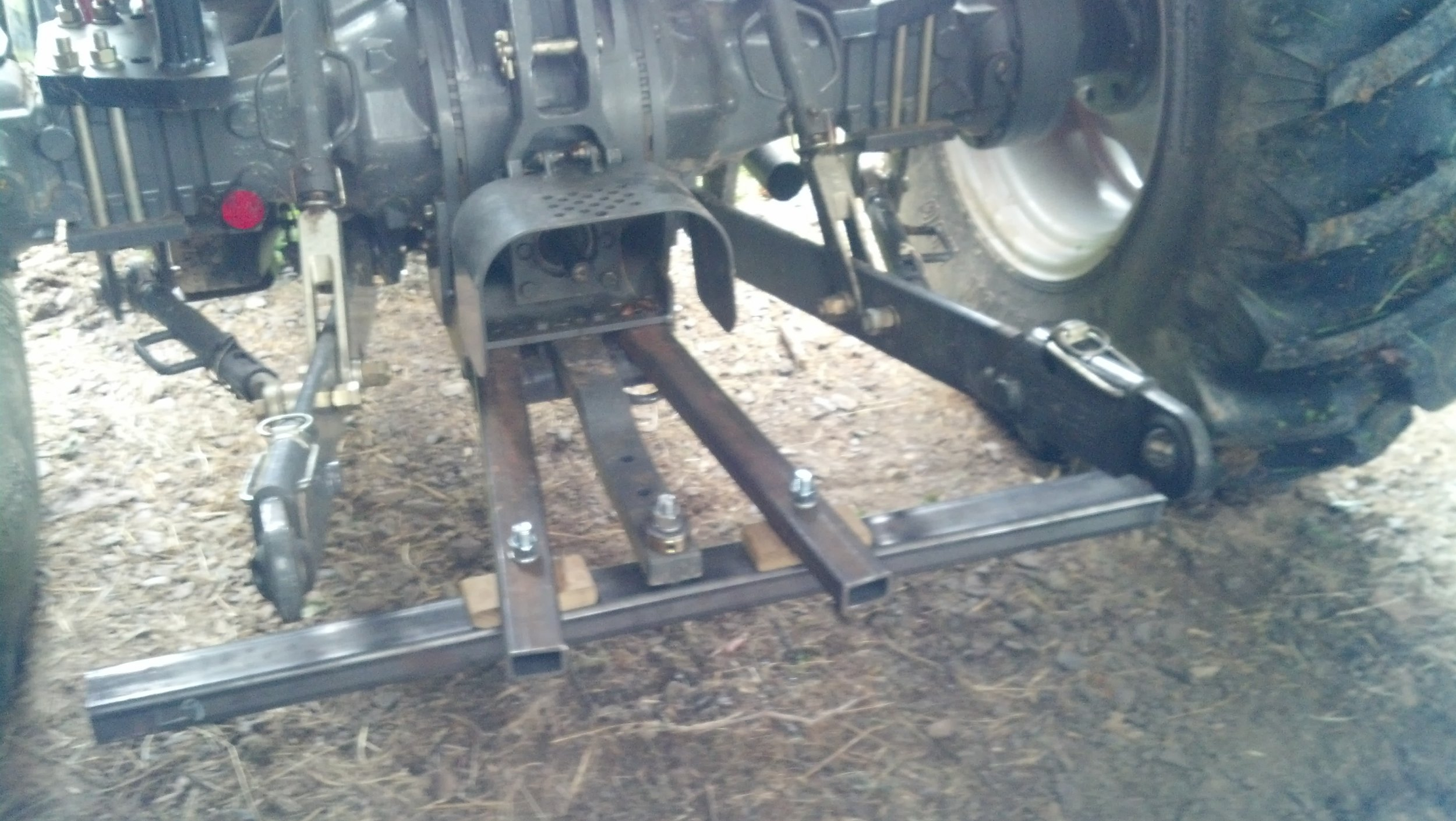

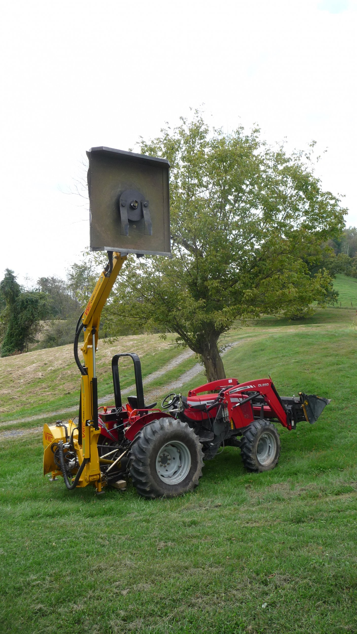

I have an Italian-made ORSI arm mower but it has a 4ft bush hog on the business end. It weighs around 2700lbs and is a serious load on a 9000lb tractor. Mine reaches 17ft. I see you do NOT have stabilizer rods on yours. ?? Mine would wobble all over the place relative to the tractor without 2 heavy stabilizer rods. BY THE WAY, is you top link attach point ion the tractor stout enough to hold that thing stationary? My top link and stabilizer rods all hooked to the top link attach point on the tractor. When the hyd pressure bled off the thing wa heavy enough to bend a good sized hunk of 1/2" thick steel plate on my tractor and I had to go repair that !!!
Lesson learned: Have to put a support structure under the ORSI that rests on the drawbar , etc. or else do damage to the tractor. The dealer failed to tell me that... a few pictures follow.

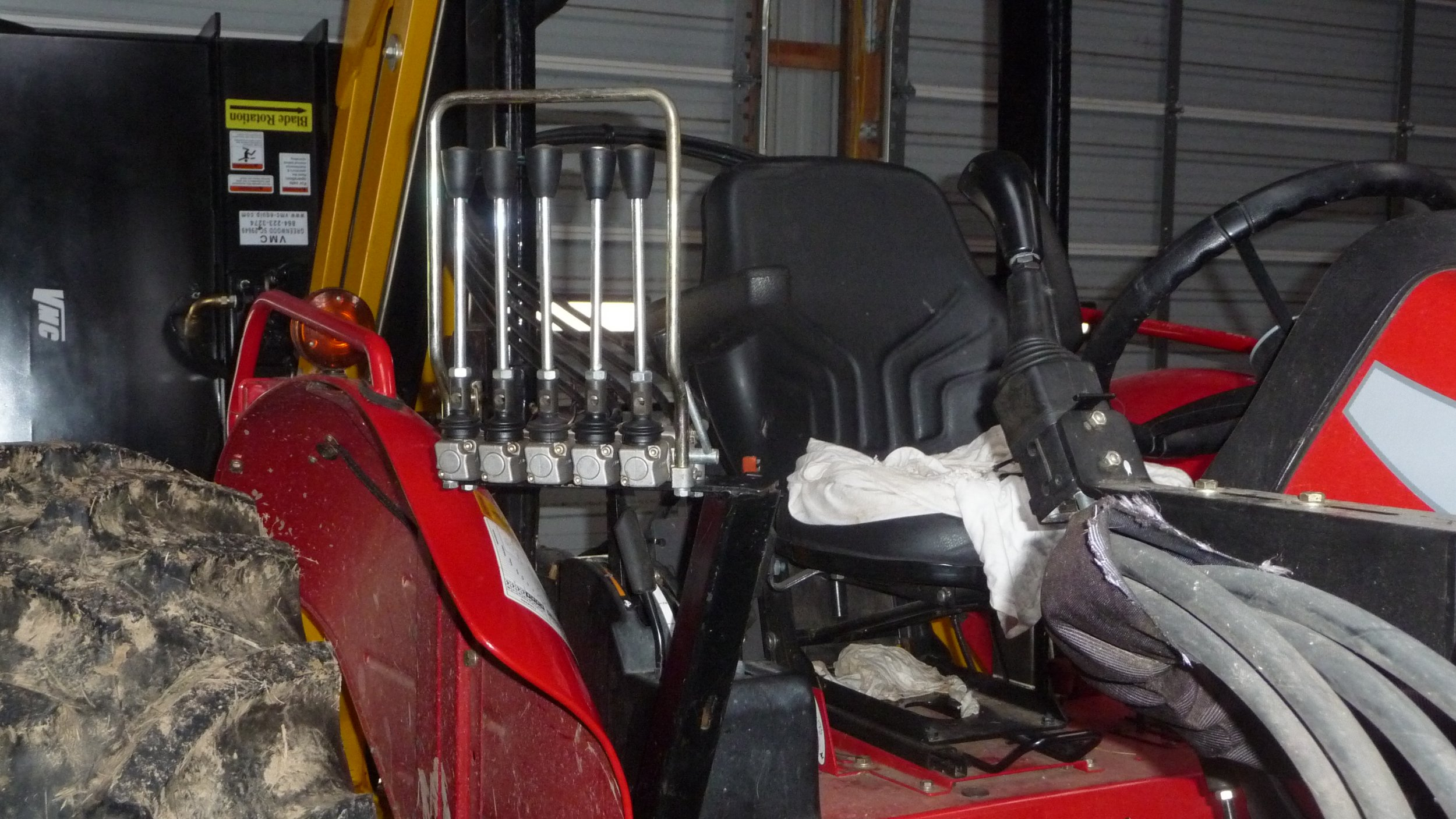

Following up on post # 15: About the ORSI...
Note that the support structure goes UNDER the lift arms so that the load rests on the drawbar and related steel, not really on the 3pt hitch. With the stabilizer rods installed the 3pt hitch is never under prseesure and is just stationary.

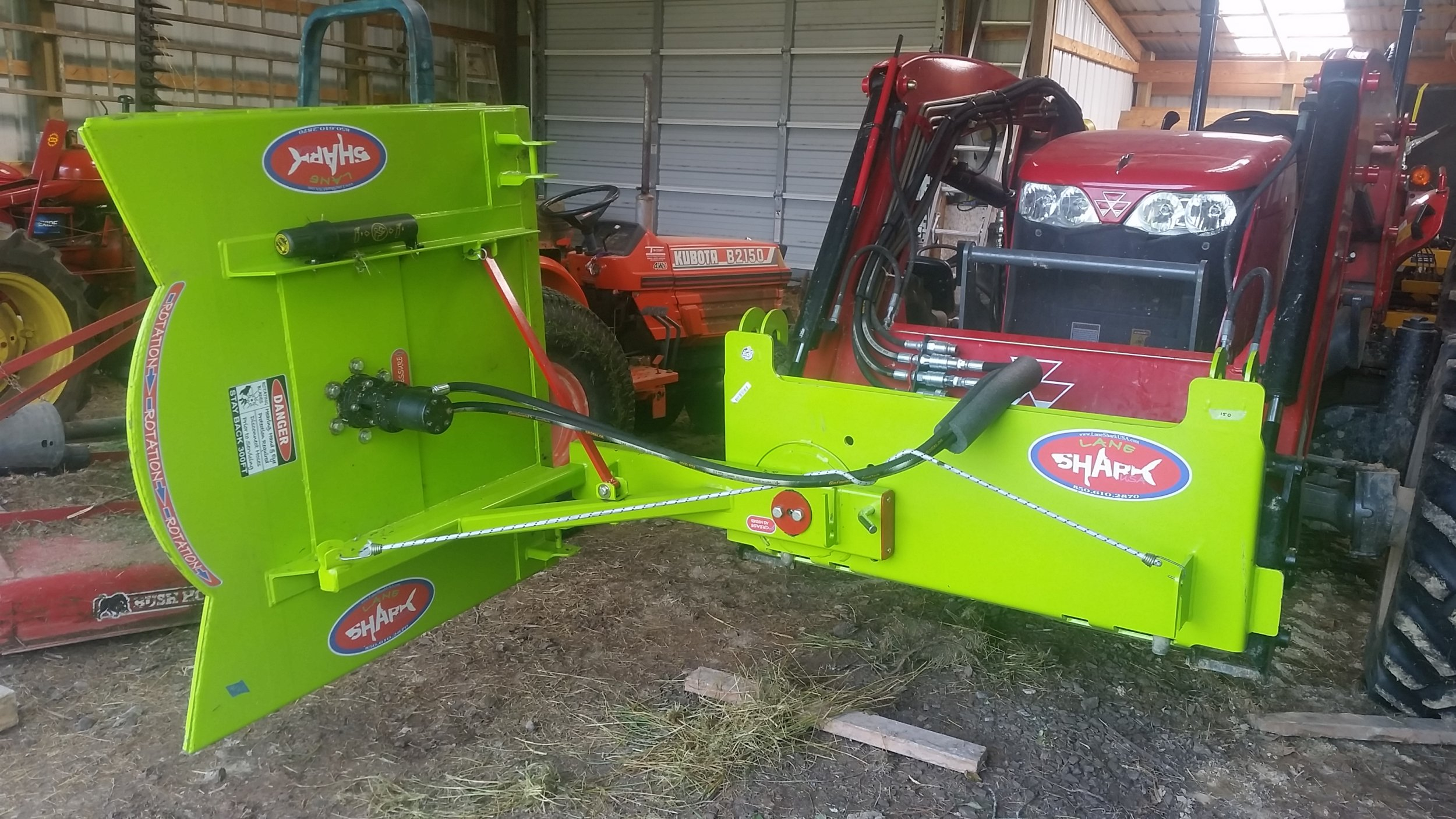

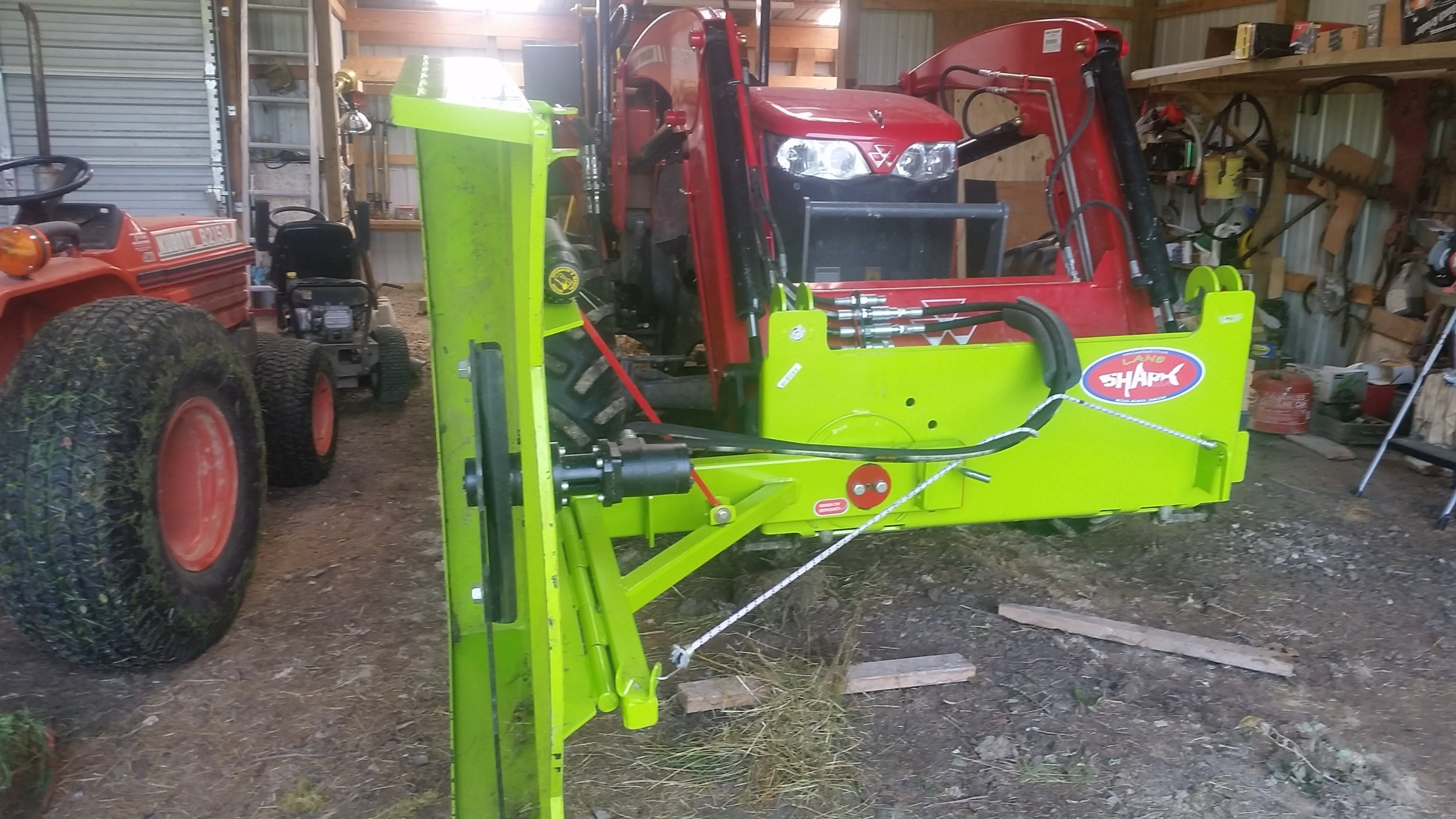

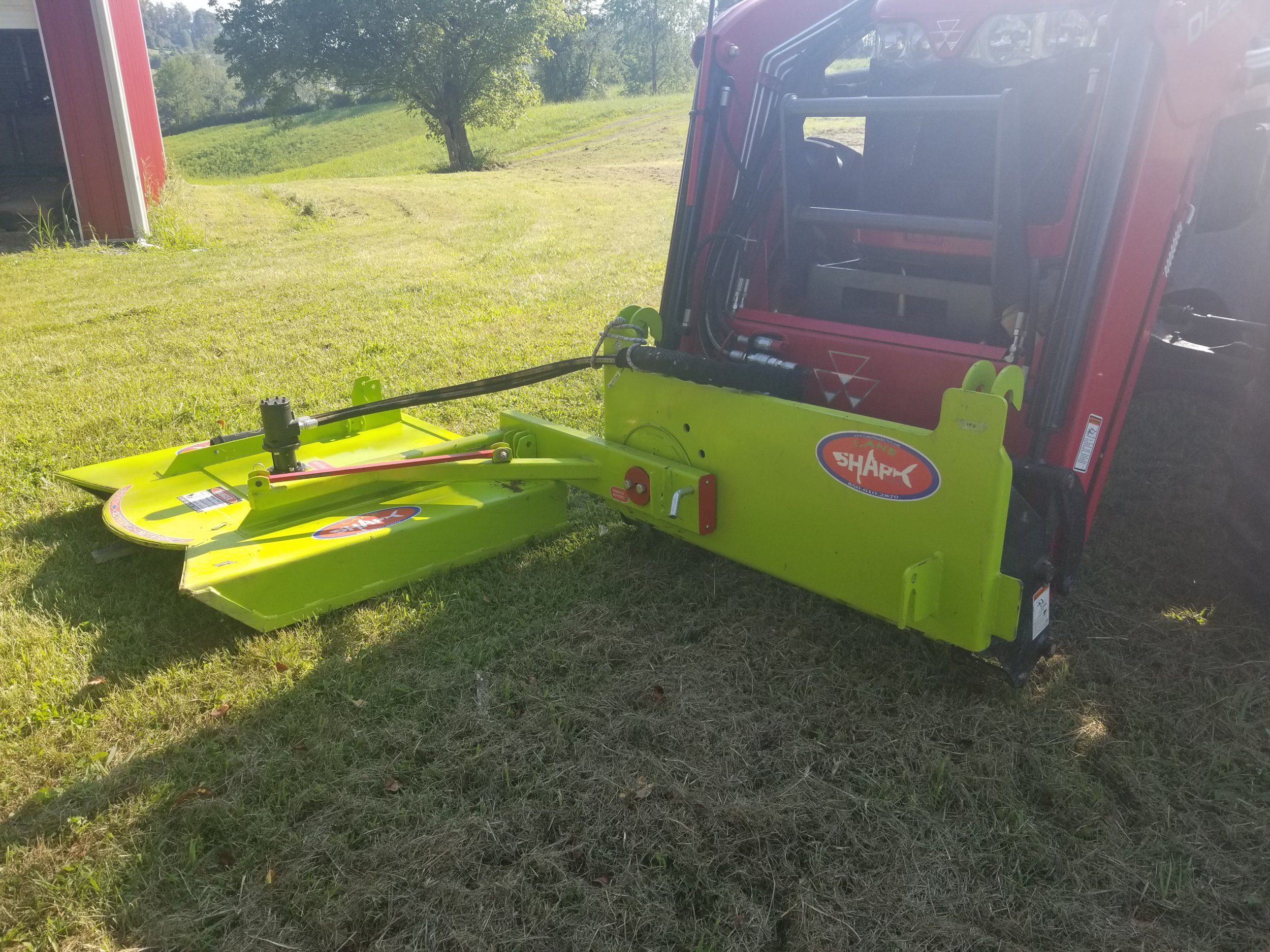

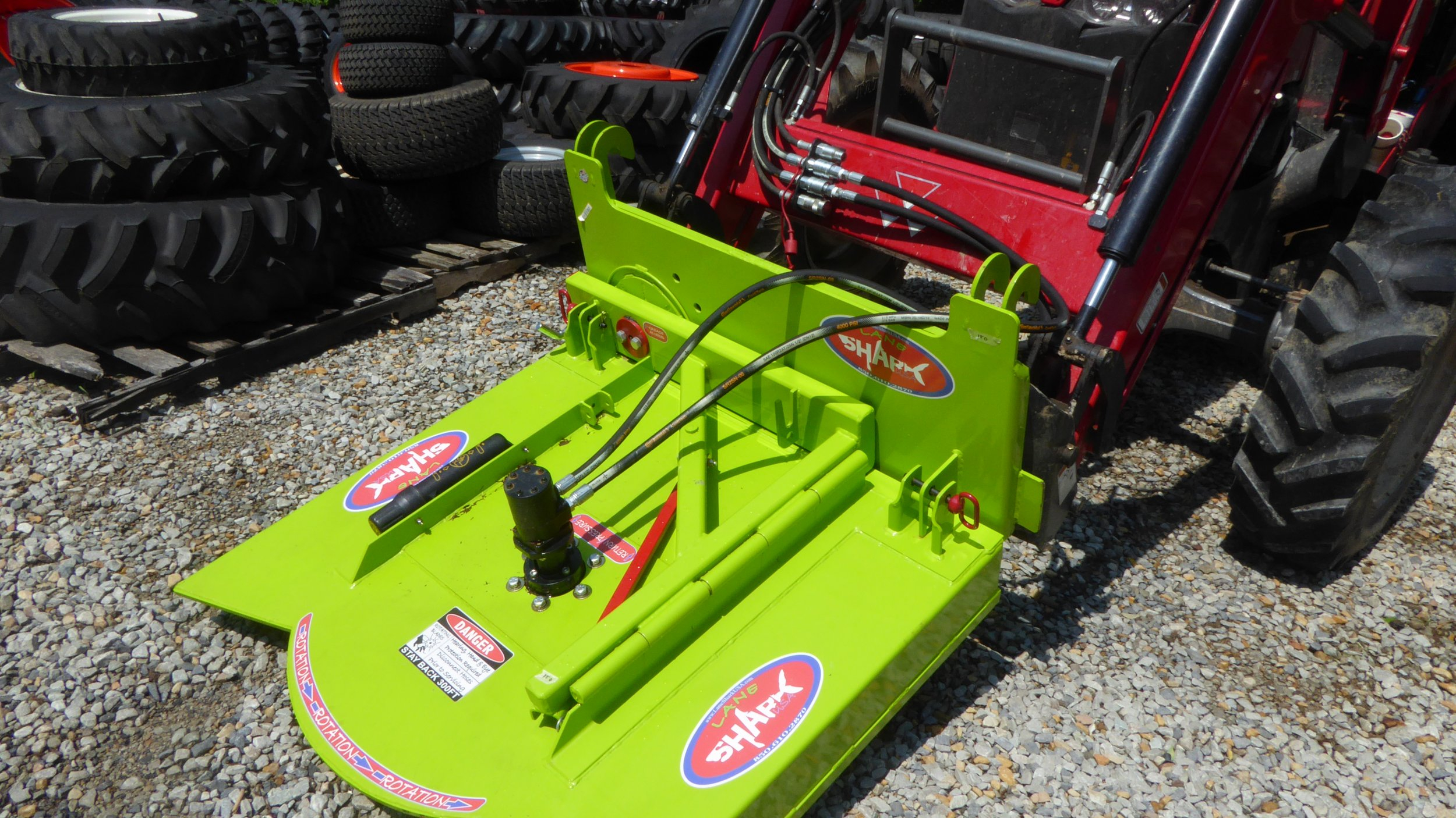

Because the ORSI is hard on an old man to hook up and remove, takes me at least 2hrs, I got a Lane Shark which will do enough of my overhanging limb trimming and ditches and cutting over sink holes so I will not be using the ORSI that much from now on. I can fully understand the OP's title of "Least favorite implement" and maybe he could use a Lane Shark too ? It will never have the reach of the ORSI nor cover as much territory nor cut as heavy a material,,, but it goes on and off easily in a short time and an old guy can do it...

What 3PH lift weight is your tractor rated for? I've never seen a boom mower supported like that.
   / Hooking up my least favorite implement #20
I bet that thing is a PITA to hook up. You need to be a contortionist to get the PTO attached.
