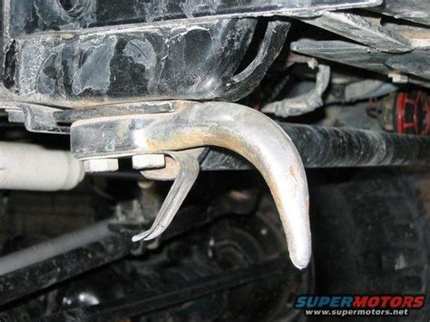

Those may not be as strong as the Horrible Fright specs say that are-imagine that LOL. And yes that's the hooks that bent, not the bucket:
/ Hooks on Bucket #62
There have been many copiers of the original Toyota hooks. I wonder if the originals are stronger than the copies.

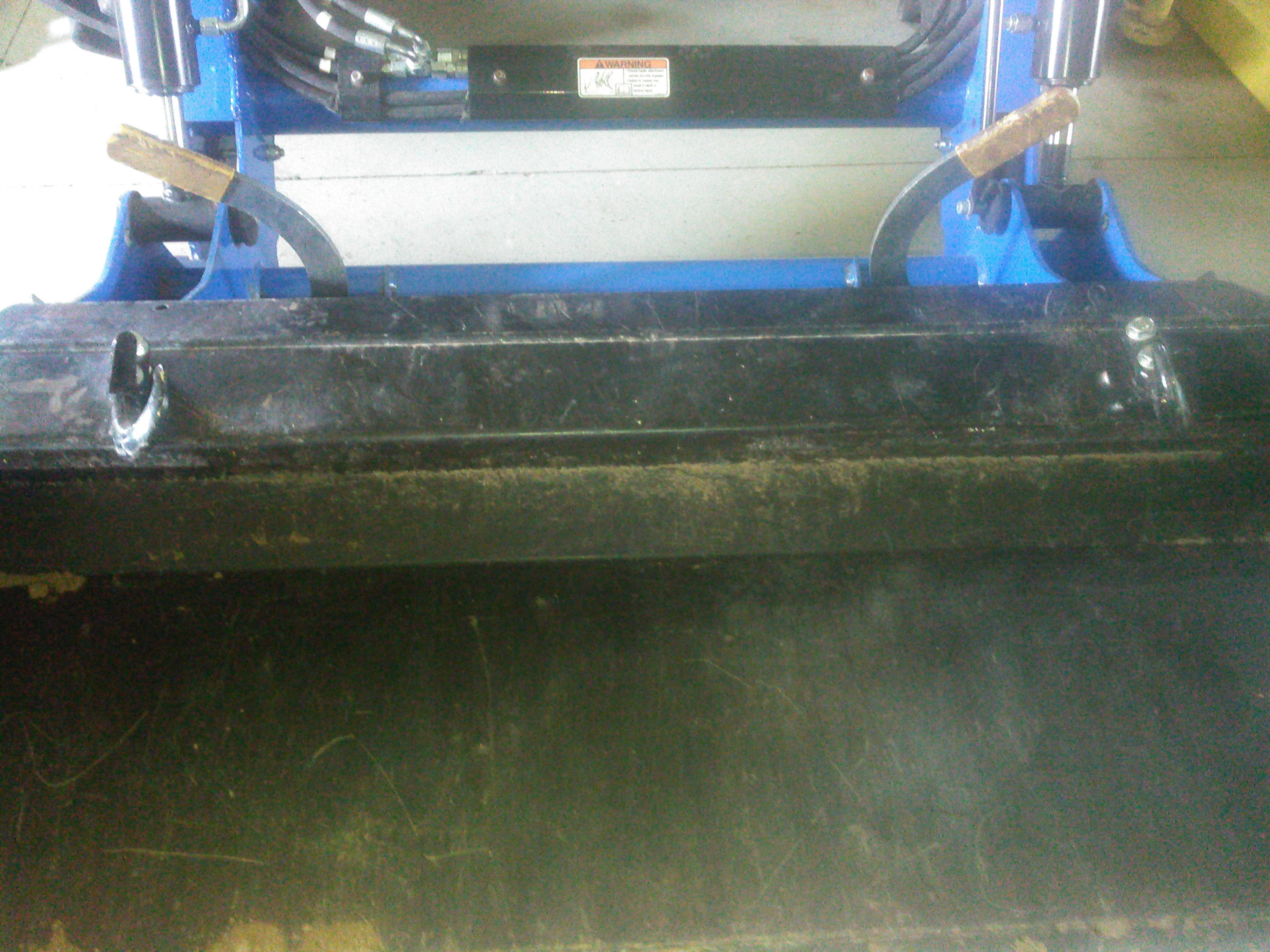

/ Hooks on Bucket #70
I sort of did my own thing.... I could make these for about 1/3 the cost of "other" options...
About 2 feet of 2 X 1/4 inch angle iron, 6 bolts (grade 8), 6 nuts, 12 flat washers, 6 lock washers...
Dale
Very nice Idea

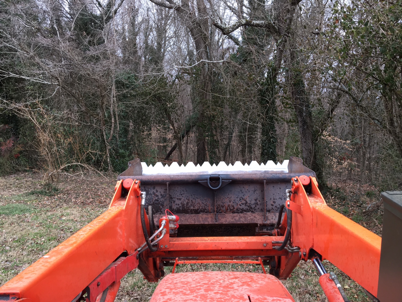

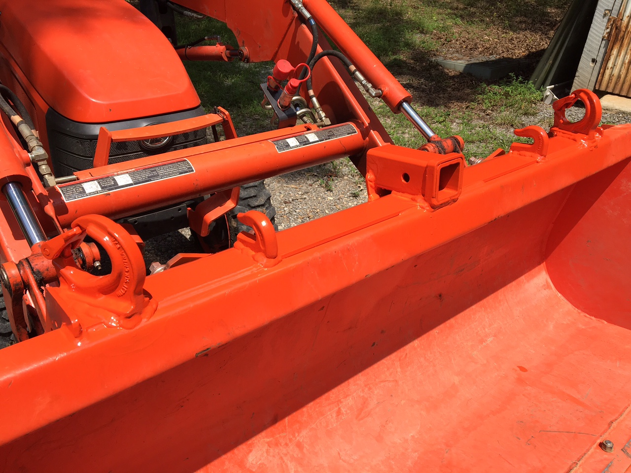

/ Hooks on Bucket #71
About 12 years ago I beefed up the top edge of fel bucket with angle iron, and added 3 weld on hooks and a hitch reciever. One of the most useful things I've added to my tractor. Here is a pic of using the center hook today.IMG_20200509_124450440.jpg

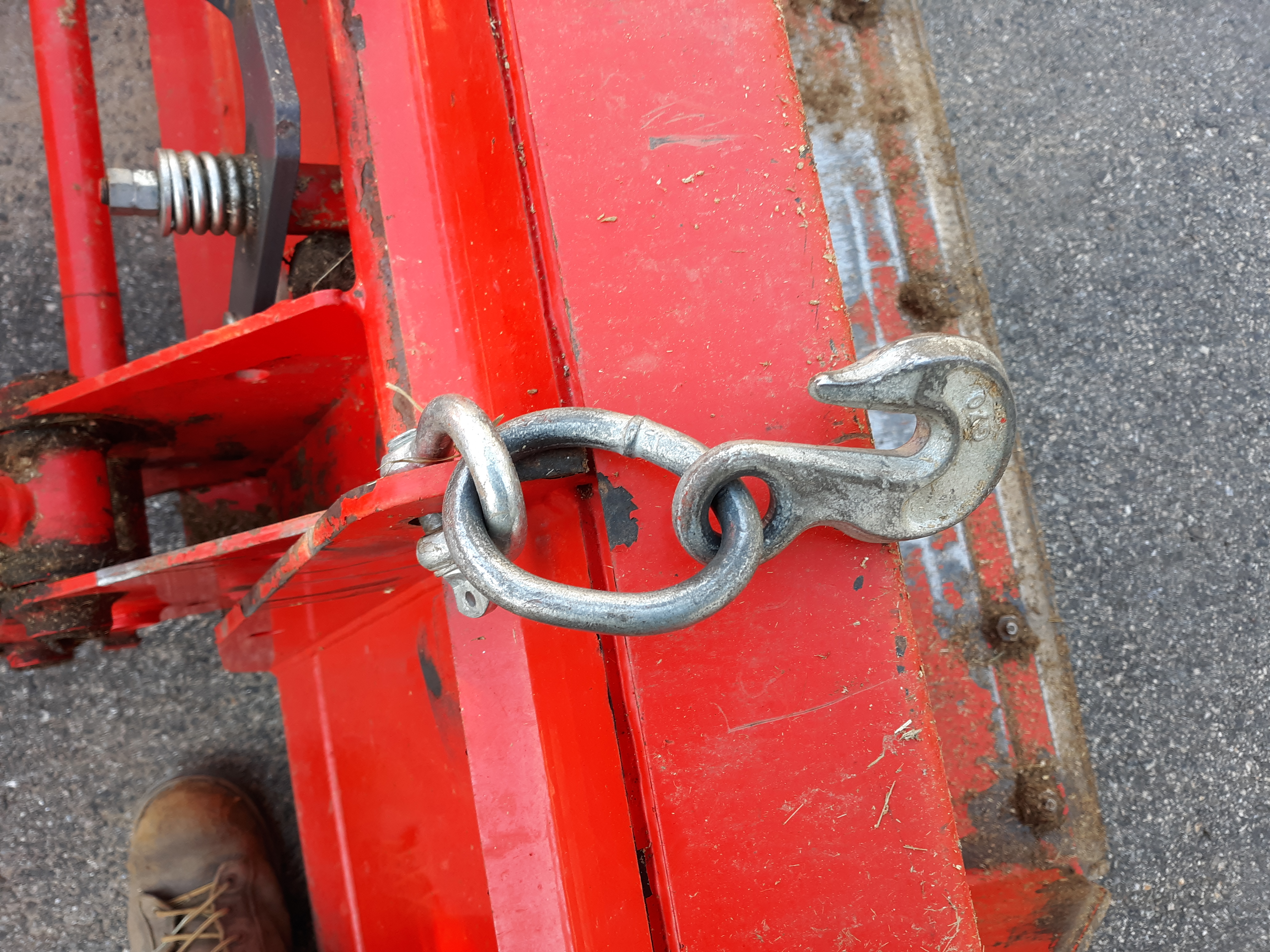

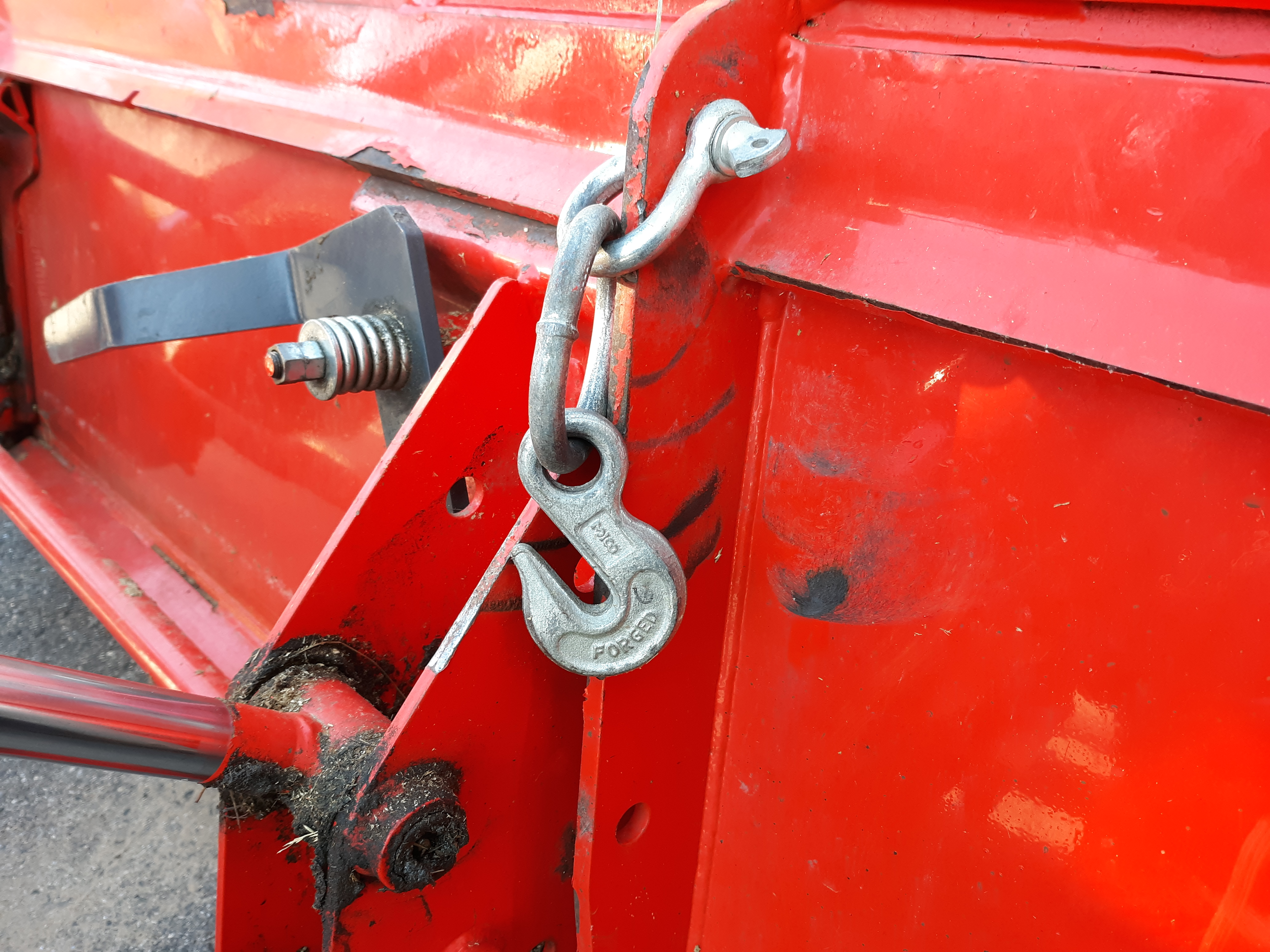

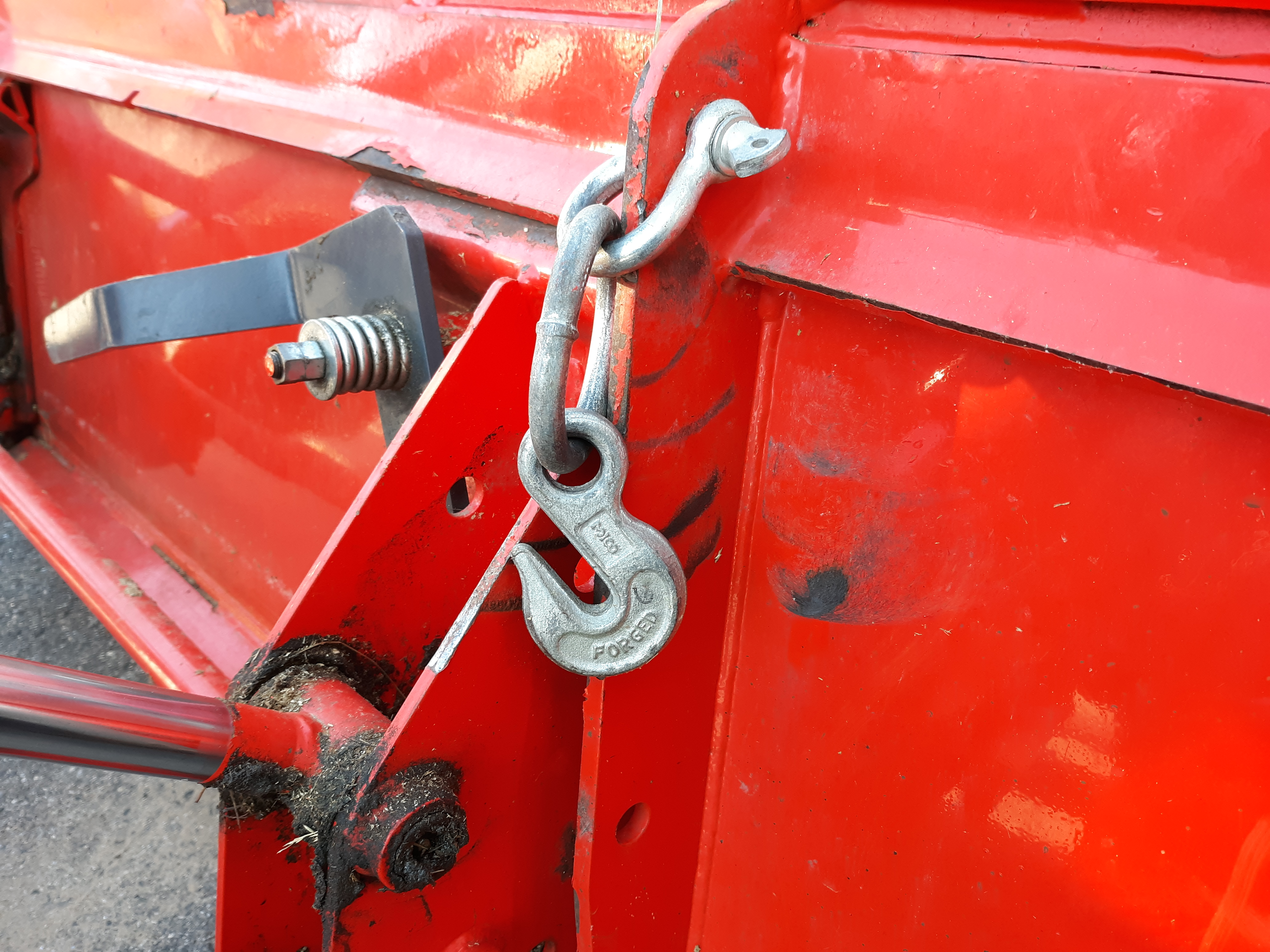

/ Hooks on Bucket #72
