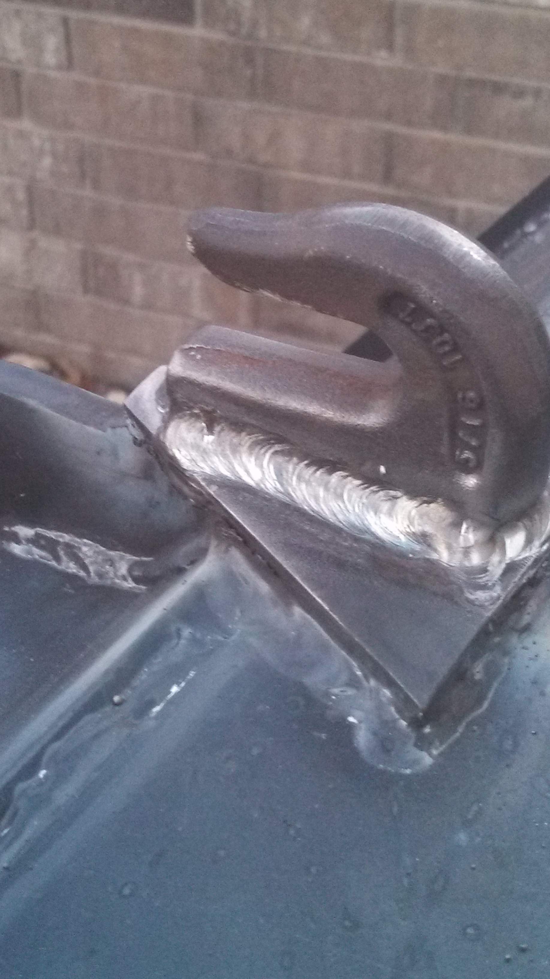

I would suggest welding hooks onto a solid steel plate then bolt the plate to the loader. That way if you ever needed to you could remove them very easily. I welded 3 hooks onto some scrap 3/8" steel plate that already had some holes in it and bolted it in place with 4 Grade-5 bolts I already had. I have used these hooks more times in the last 6 months then I can count ! Them and a piranha bar completes my FEL.
View attachment 633936View attachment 633938View attachment 633937
Very nice job. My Kioti came with plates factory welded on to weld hooks onto. If I say so, my stick welds look better than the factory MIG welds of the plate.

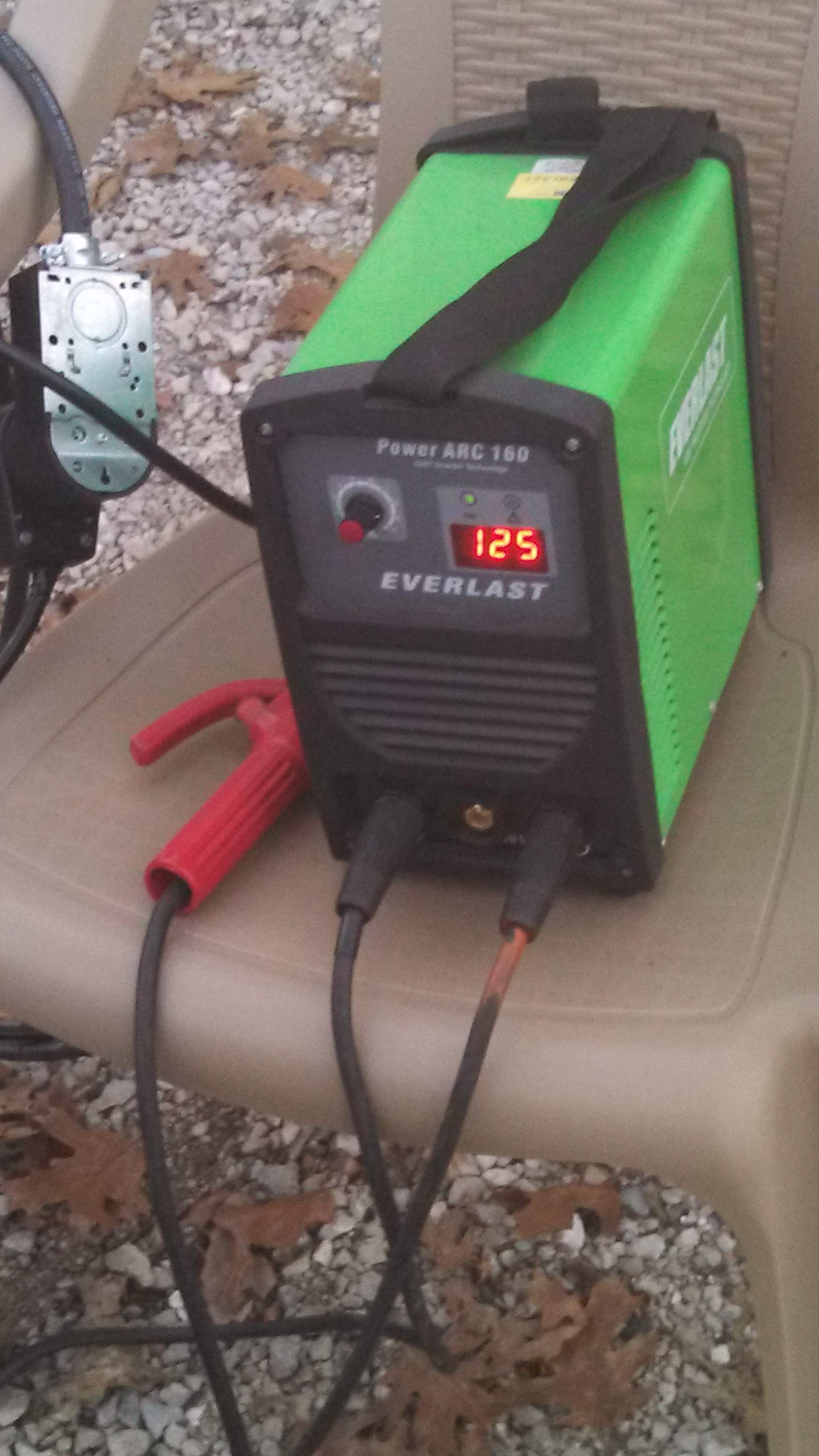

Sweet ! Yeah I have to use an old buzz box here so I get more splatter.
   / Hooks on Bucket #45
This is the little DC jewel that welded those.

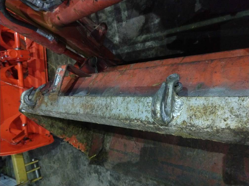

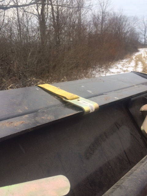

I have a Kioti CK30 and instead of permanent hooks I'm using a strap that comes with a flat hook on one end and a sown loop at the other. The strap is used by the tow industry to attach onto the rear axle of fwd cars. In the loop I insert either a D-ring or hook as shown in picture. The flat hook just hooks over the back edge on my loader or the cutting edge of the bucket. Easy and cheap and temporary and versatile HookA.jpgHookB.jpgetc. Dutchy

I have a Kioti CK30 and instead of permanent hooks I'm using a strap that comes with a flat hook on one end and a sown loop at the other. The strap is used by the tow industry to attach onto the rear axle of fwd cars. In the loop I insert either a D-ring or hook as shown in picture. The flat hook just hooks over the back edge on my loader or the cutting edge of the bucket. Easy and cheap and temporary and versatile View attachment 634300View attachment 634301etc. Dutchy
I like it
