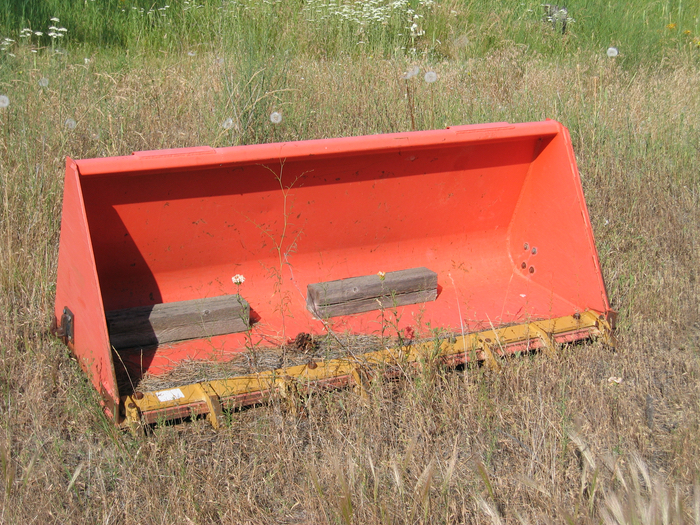

Bolt on hooks - bolt on tooth bar.

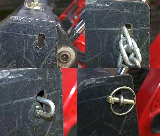

Actually.... You could use the ovals...

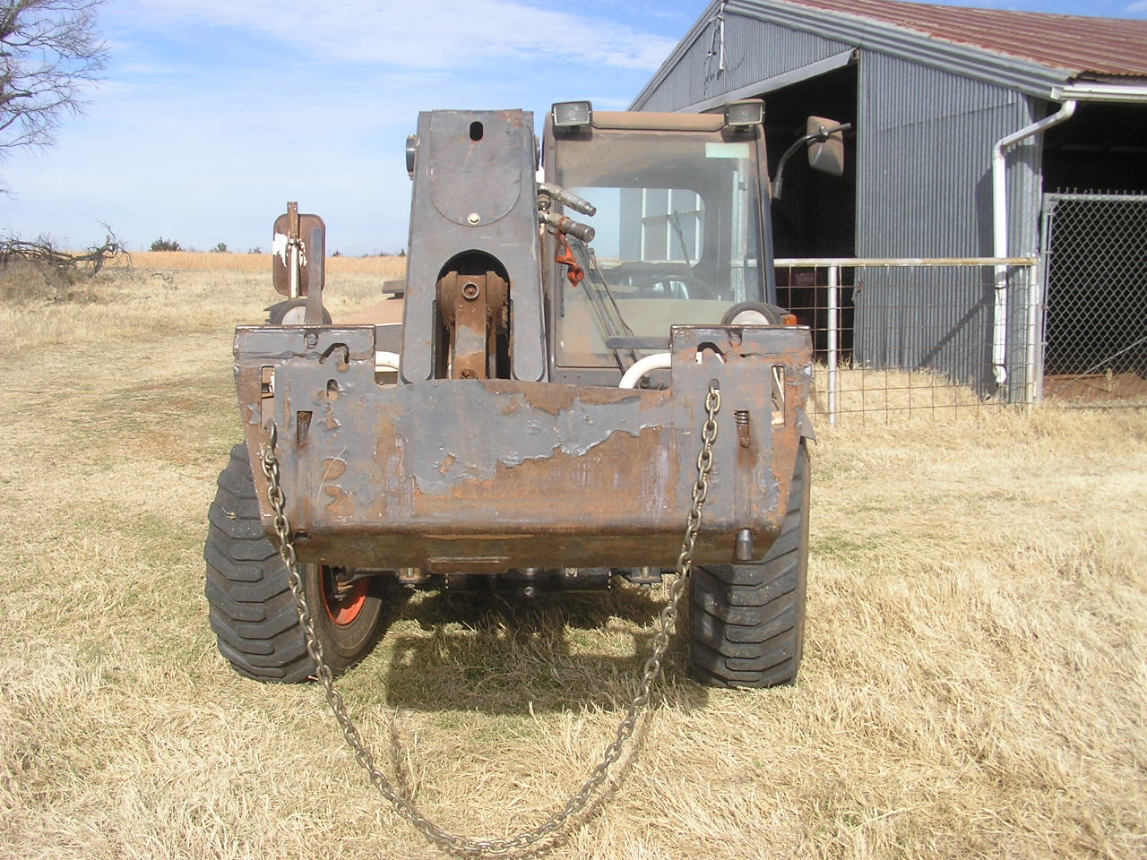

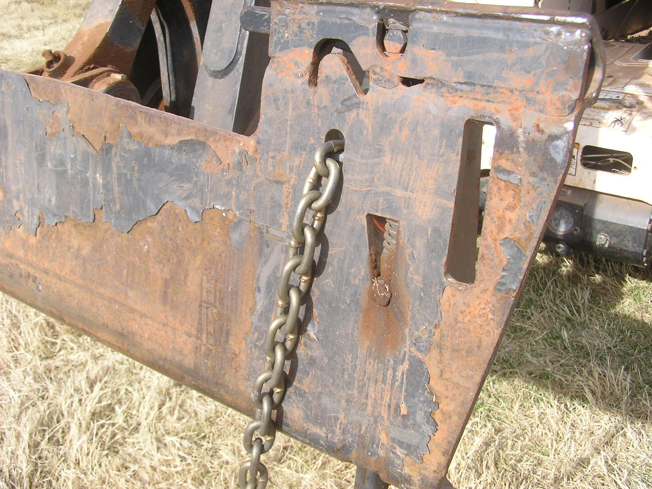

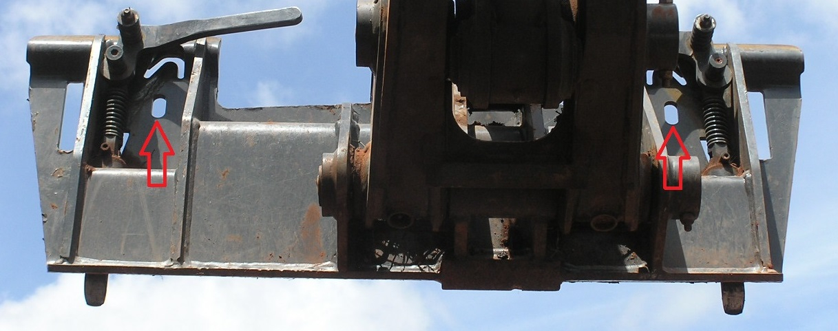

The ovals will work, thanks for the tip. Found a picture of the backside that shows the oval holes:

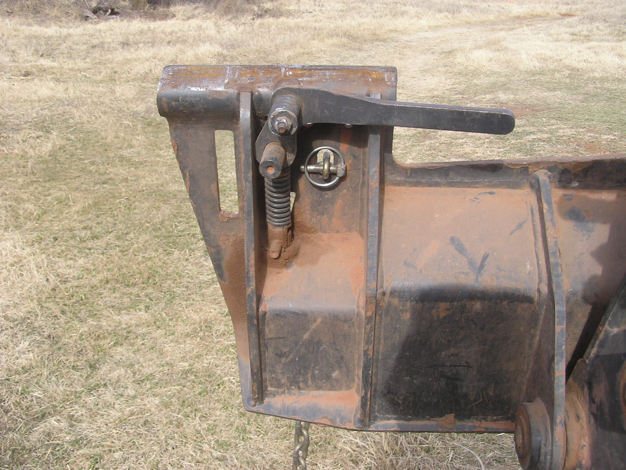

Tried DL Meisen's idea of putting the no hook end through the oval hole in the SSQA:
Works gooder-un, gonna be real handy (y)
