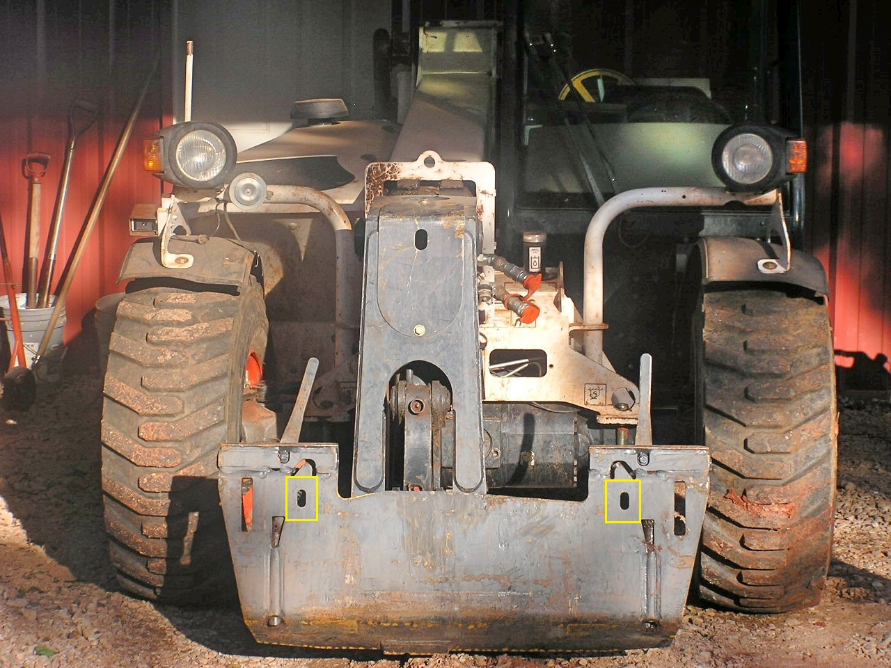

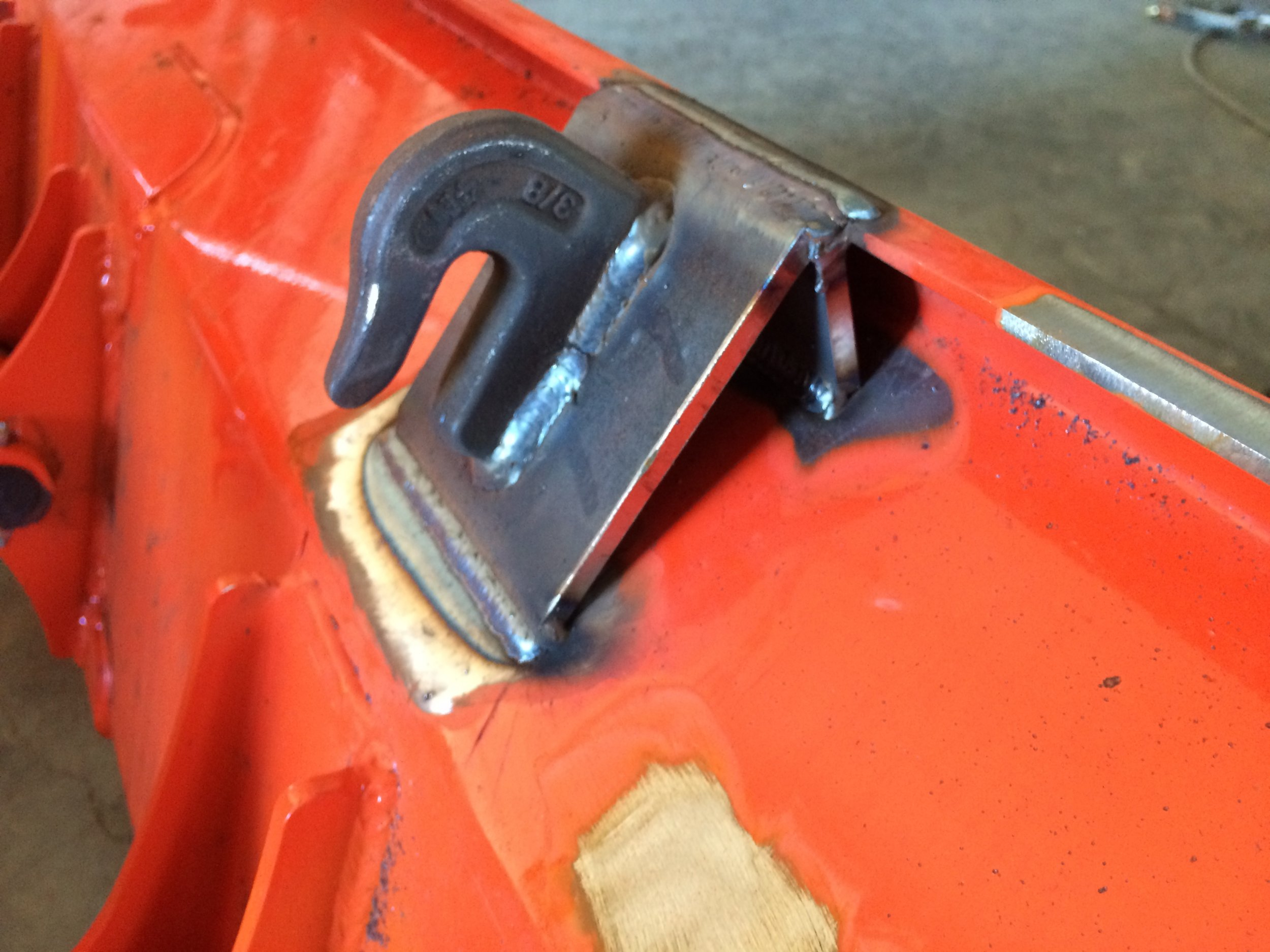

Did you mean these....

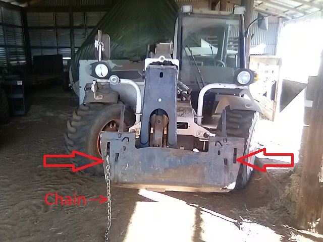

No, I meant the longer slots with a chain hanging in one of them:
   / Hooks on FEL Bucket #54
Actually.... You could use the ovals...
There are on sides of my FEL bucket, took a while to figure out what they were for........
   / Hooks on FEL Bucket #55

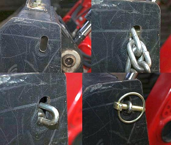

Good idea, I will look on the backside to see if it is flat.
That would be perfect for the chain in the picture since it only has one hook (y) .

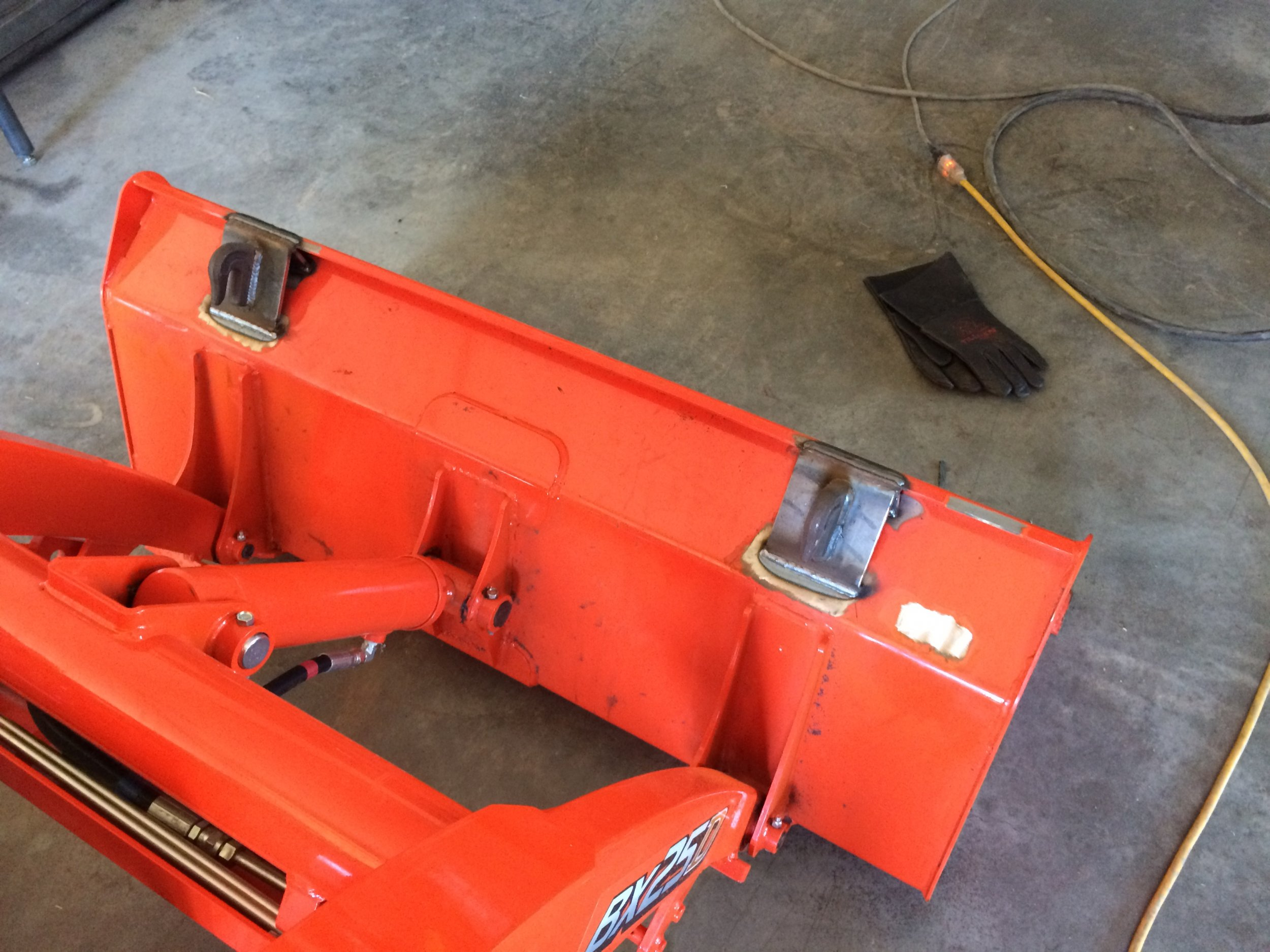

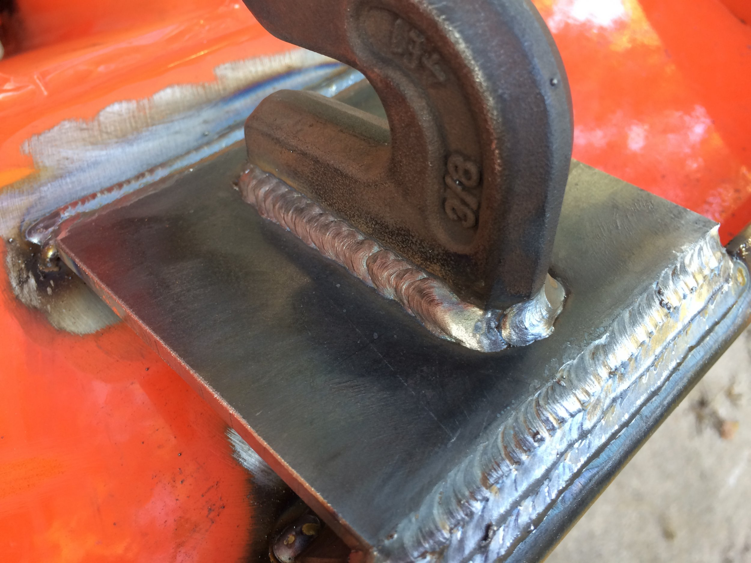

Talking hooks. Who and why would you choose one style over the other? chain grabbing hooks or just regular ,car towing, type hooks? I can see advantages to both.
I think one of the big things about a chain hook is that since you can hook it anywhere on the chain, you can set the length more easily than if you had a large hook or ring where you would have to double your chain back and hook it to itself to shorten it. Or if you have a bare chain or chain with hook on only one end. I think it's useful to have chain hooks and one larger hook/loop/d-ring etc.
Also, for those with a sturdy enough bucket, i swear these things from harbor freight are by far the cheapest piece for sale that gives you the functionality it does. ATV Hitch Adapter
It gives you the 2" receiver (which also lets you just run a pin through a chain link fed into the receiver), a large and sturdy hoop/loop, can be bolted OR welded, or if you turn it backwards you also get a clevis pin hole. I have it mounted backwards on a 3pt a-frame on my Case garden tractor and most 2" drawbars will still go into it from the bolt hole end. I shaved that end down a bit on mine since some of my drawbars would not fit into it from that direction.
In my case having the bolt hole end sticking out is mostly to pull pin-type attachments for garden tractors, but you could also put a shackle through it just as easily.
Could also mount it upside down beneath top bucket lip if you had a reason to. It puts in a lot of good work for $11.
The ovals will work, thanks for the tip.

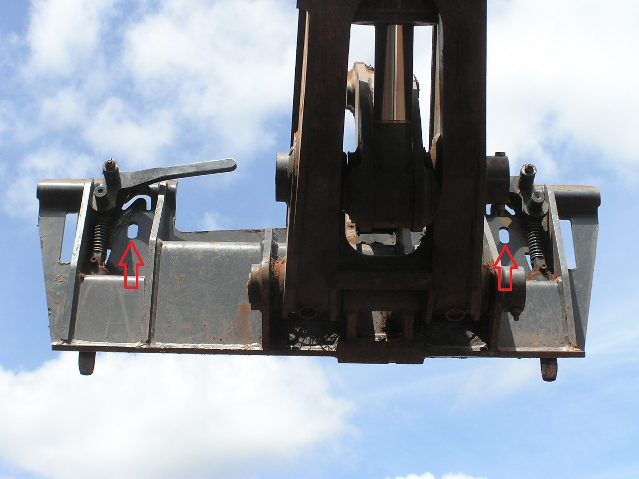

Found a picture of the backside that shows the oval holes:
