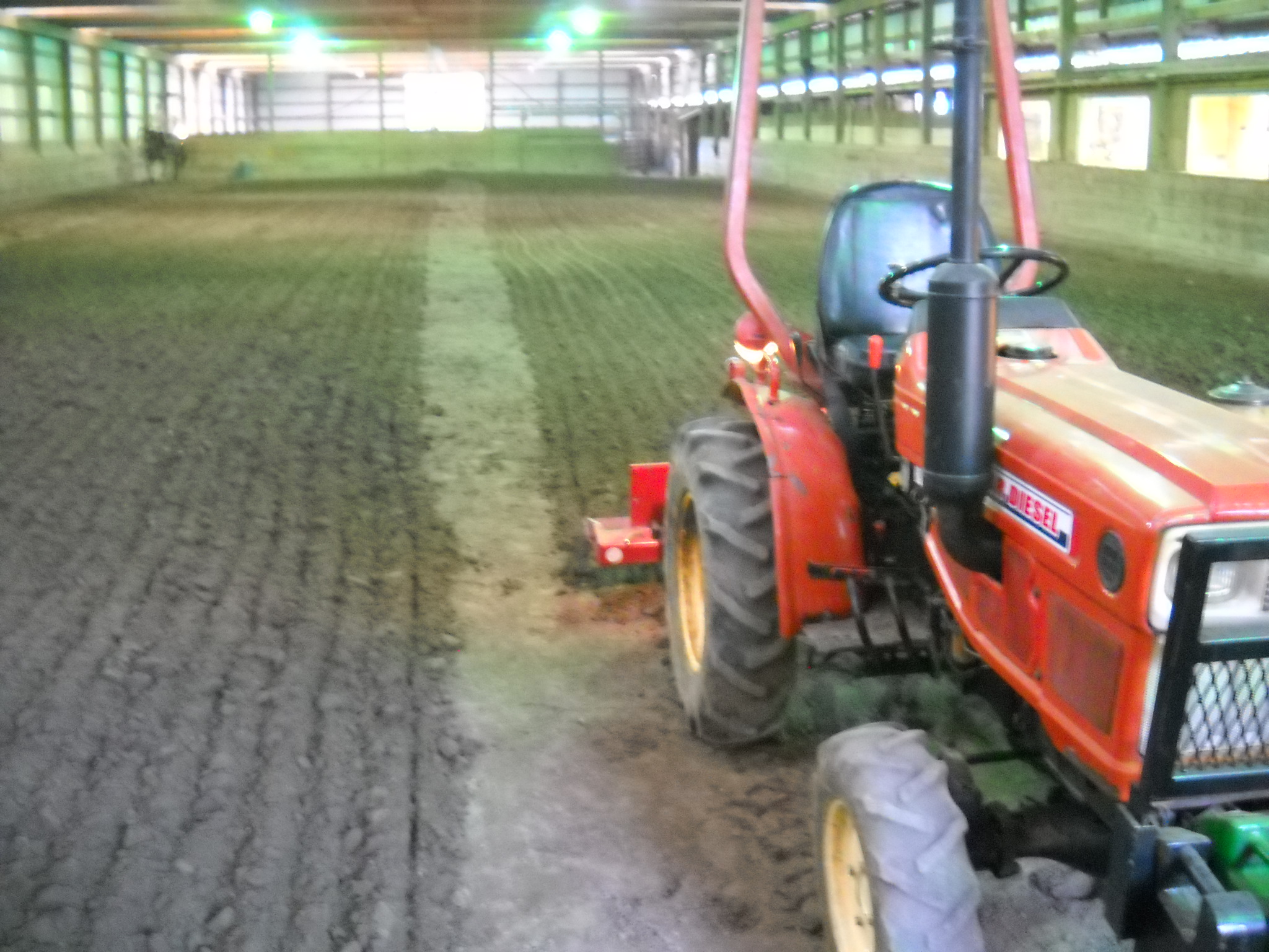

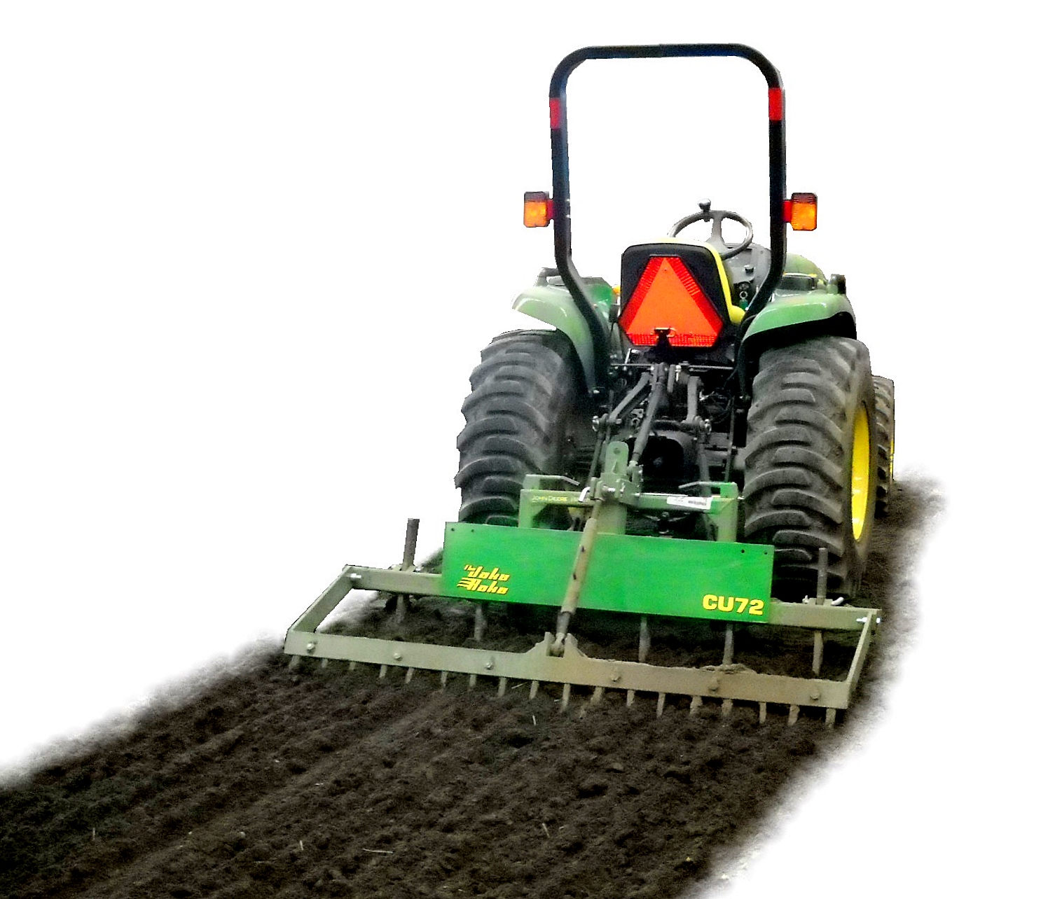

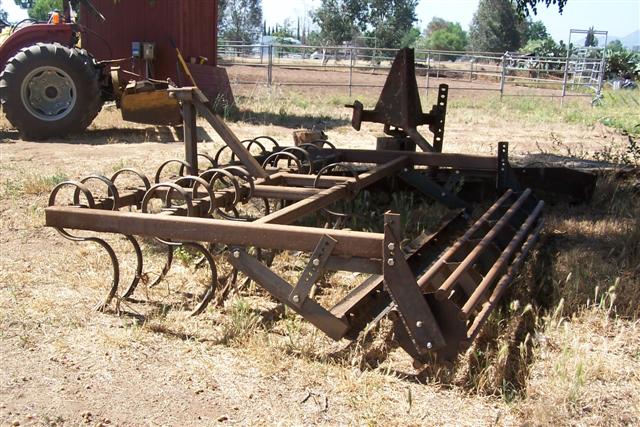

this is what i made works awesome levels very well kinda looks alot like an arena-vator. s tine spring teeth dig real well the leveling blade smoothes it nicely and the roller firms up the ground.

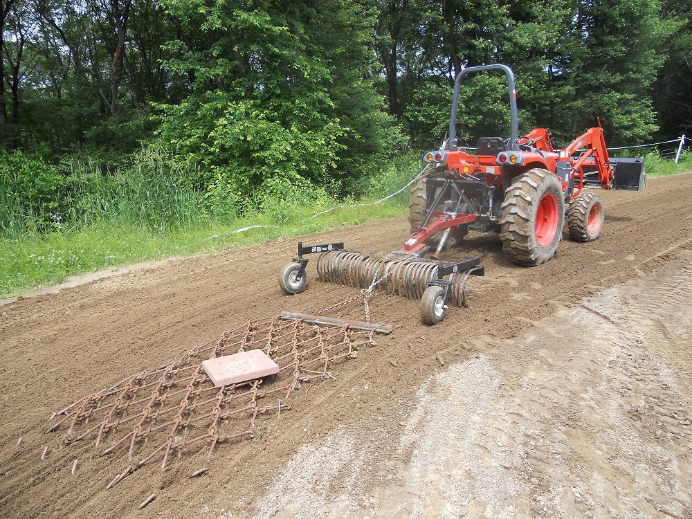

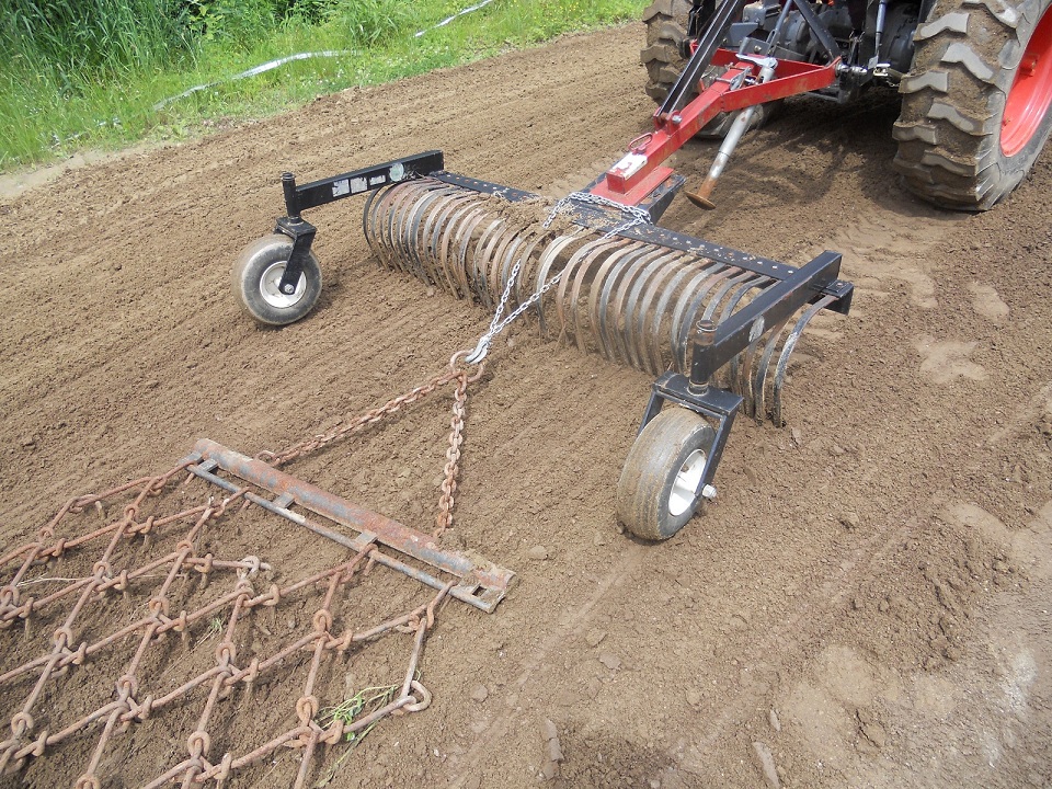

John, can you post a picture of how you have that set up? Thanks!
Nothing special. Just wrap a chain around the rake and hook it to the drag. A full width piece of chain link fence chained to the rake wheels would be better since the drag mat we have is only 4 ft wide and doesn't cover the whole width. We don't really use it this way any more since the wife got a quad that she uses to pull the drag mat around. Usually, this is enough to do a quick grooming. When the conditions are really dry and the surface gets hard, I use the rake to fluff it up
