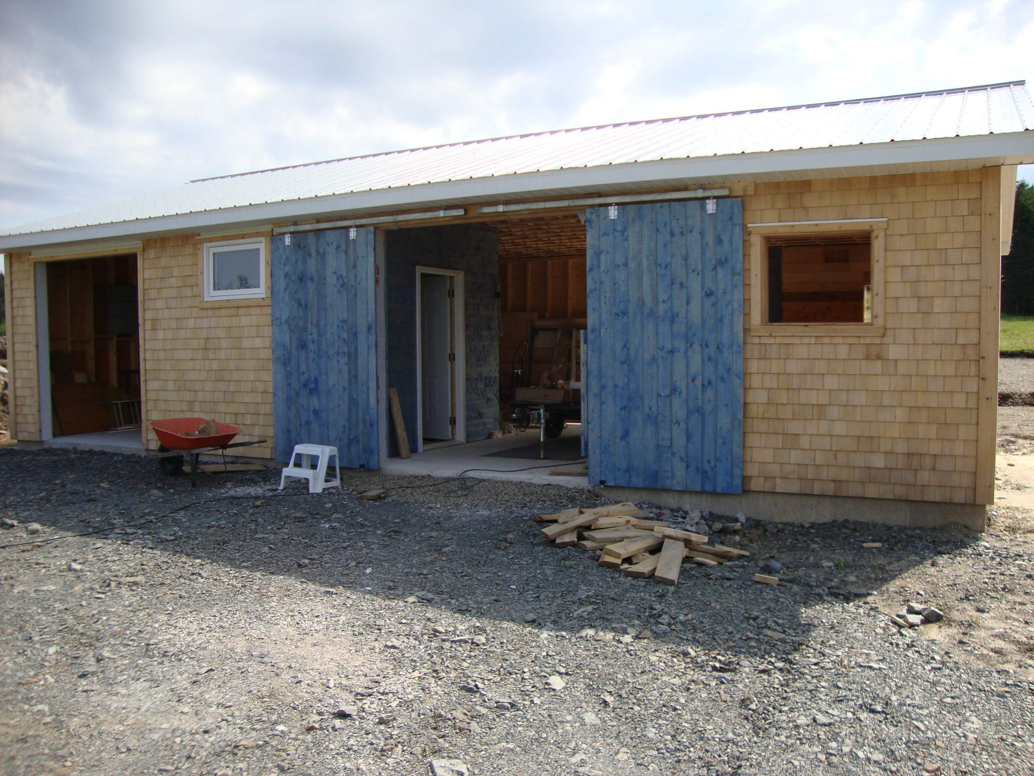

It's soon time for more pictures, we started painting the tack room tonight. I'll be building the sliding main doors starting tomorrow or Thursday, the tracks got mounted today between rain showers. We REALLY need rain gutters...
I pick up the overhead door for the hay storage tomorrow too, as well as cedar trim boards for the faces of the door openings and windows, and one more 6x6 for the second set of cross-ties. Frieze boards will be the last thing we do, along the tops of the walls and along the roof rakes.

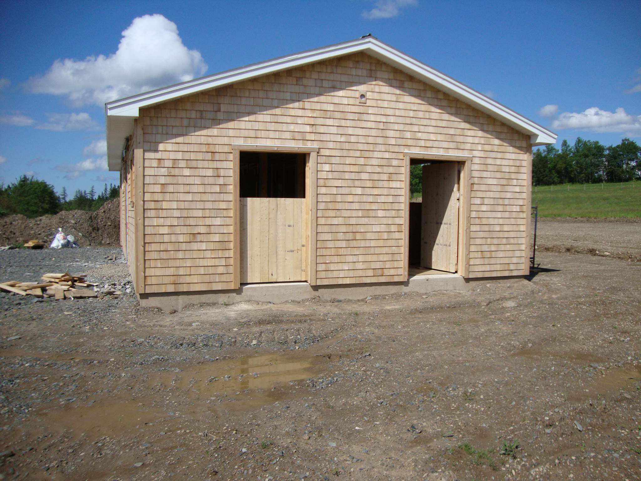

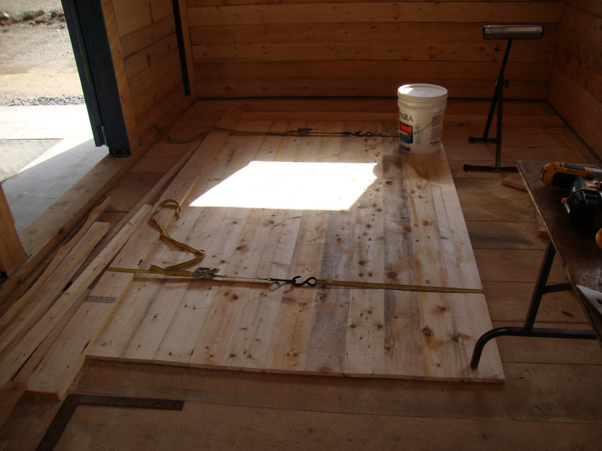

Sliding doors are finished and hung, and the dutch doors for the stalls' in-and-out doors are finished and hung. We built those in one piece, then cut the top off.
I finally wised up and built an L-frame for building the sliders, it kept everything square and I could put a ratchet strap around the boards and squeeze 'em up tight before putting screws in.
The overhead door is going together now, first one I've put in myself. Not nearly as bad as I thought.
Electrician should be here momentarily, which means I've got a few loose ends to tie up before he gets started.
Sean

Very nice barn project there Chilly :thumbsup: I have one question though.. shouldn't the dutch doors on the stalls swing out from the stall with the plain board side facing in? That way bored or mischevious ponies don't have as much opportunity to chew or tug the door.
