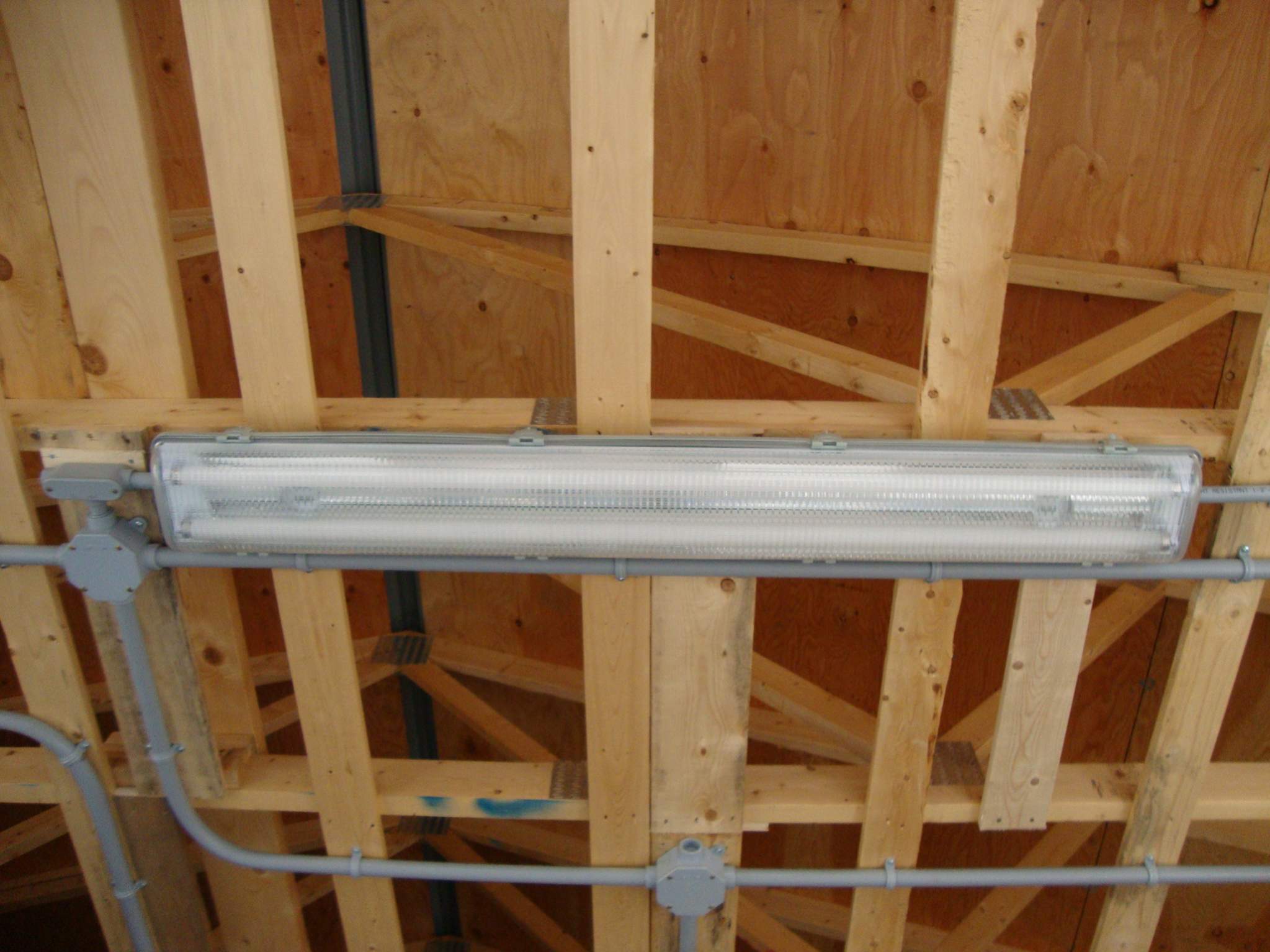

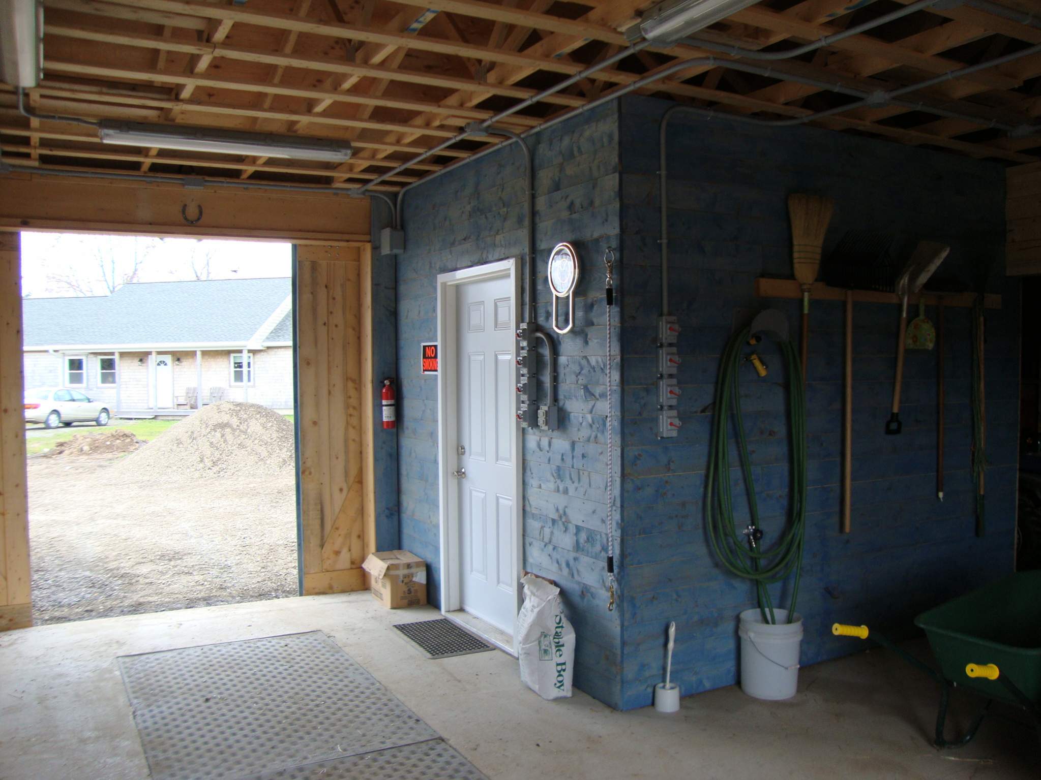

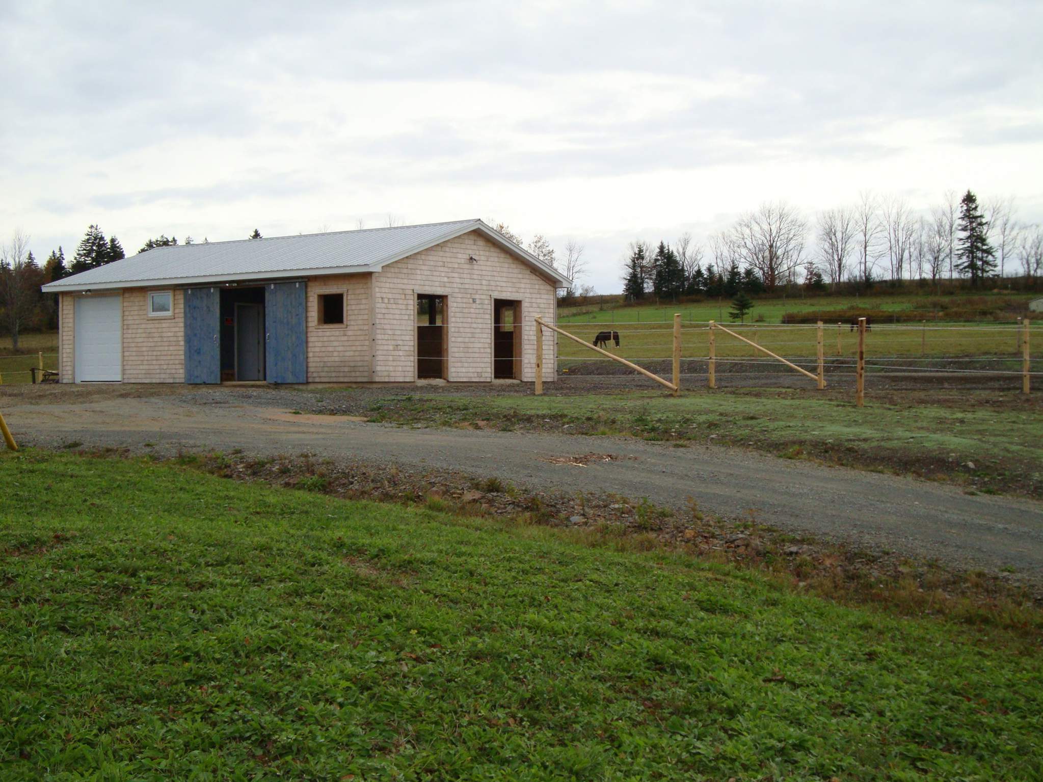

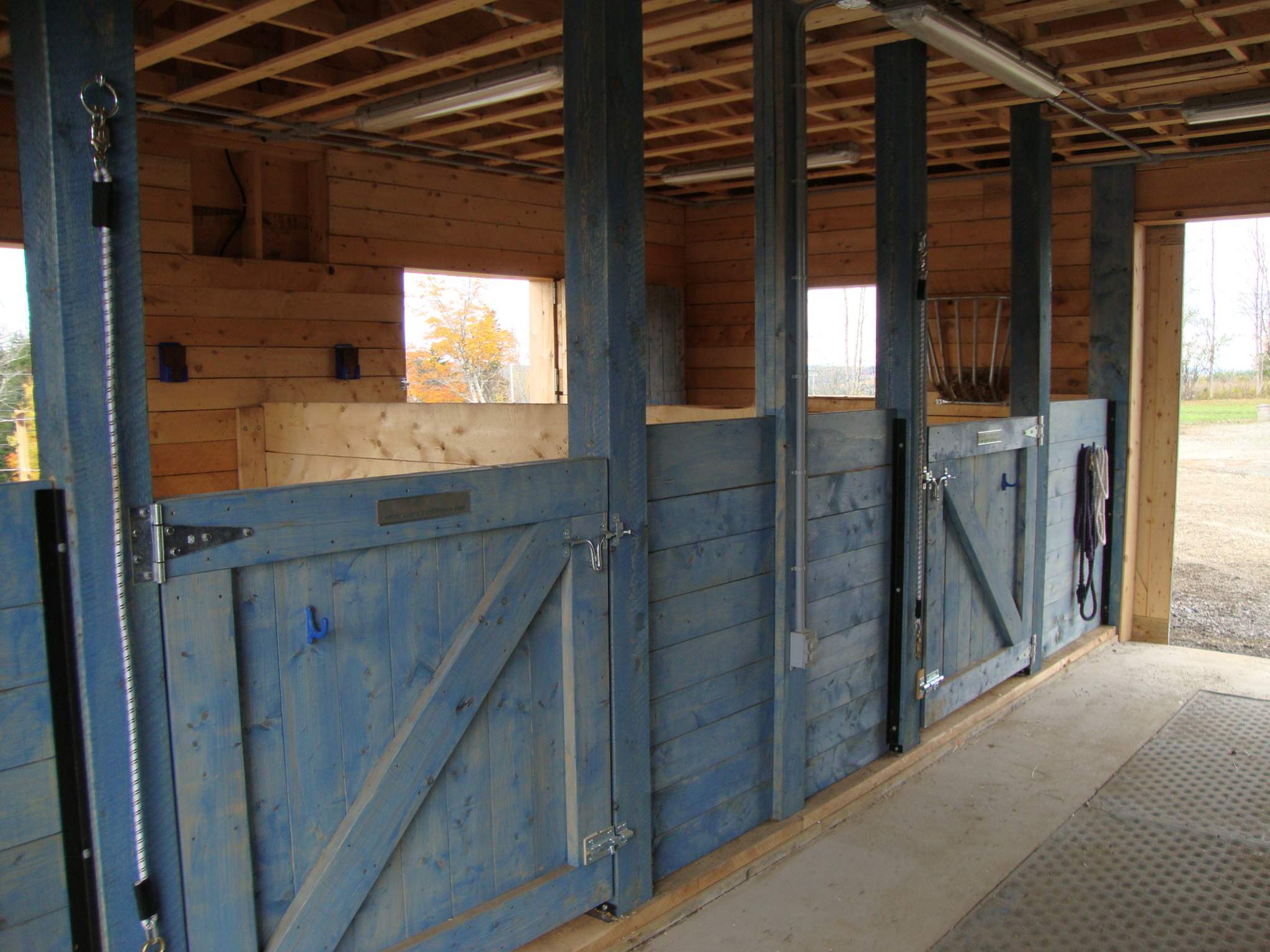

We have the critters moved in, finally. Fencing was the last hurdle, and we're over it.
The electrical turned out really nice, we used PVC conduit or Tec cable throughout as well as weatherproof switches and plugs, and T8 vapor tight fluorescent fixtures.
Sean

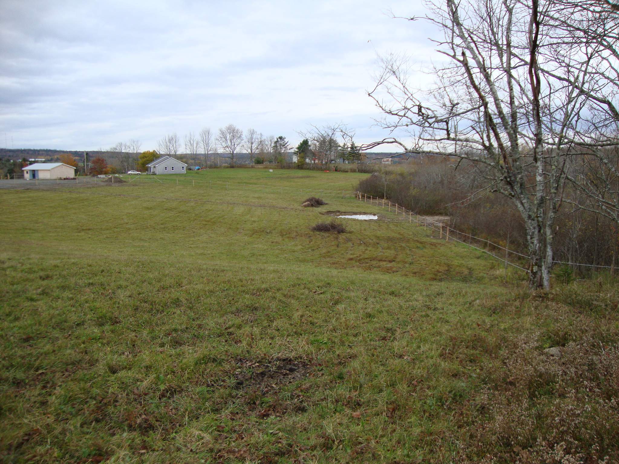

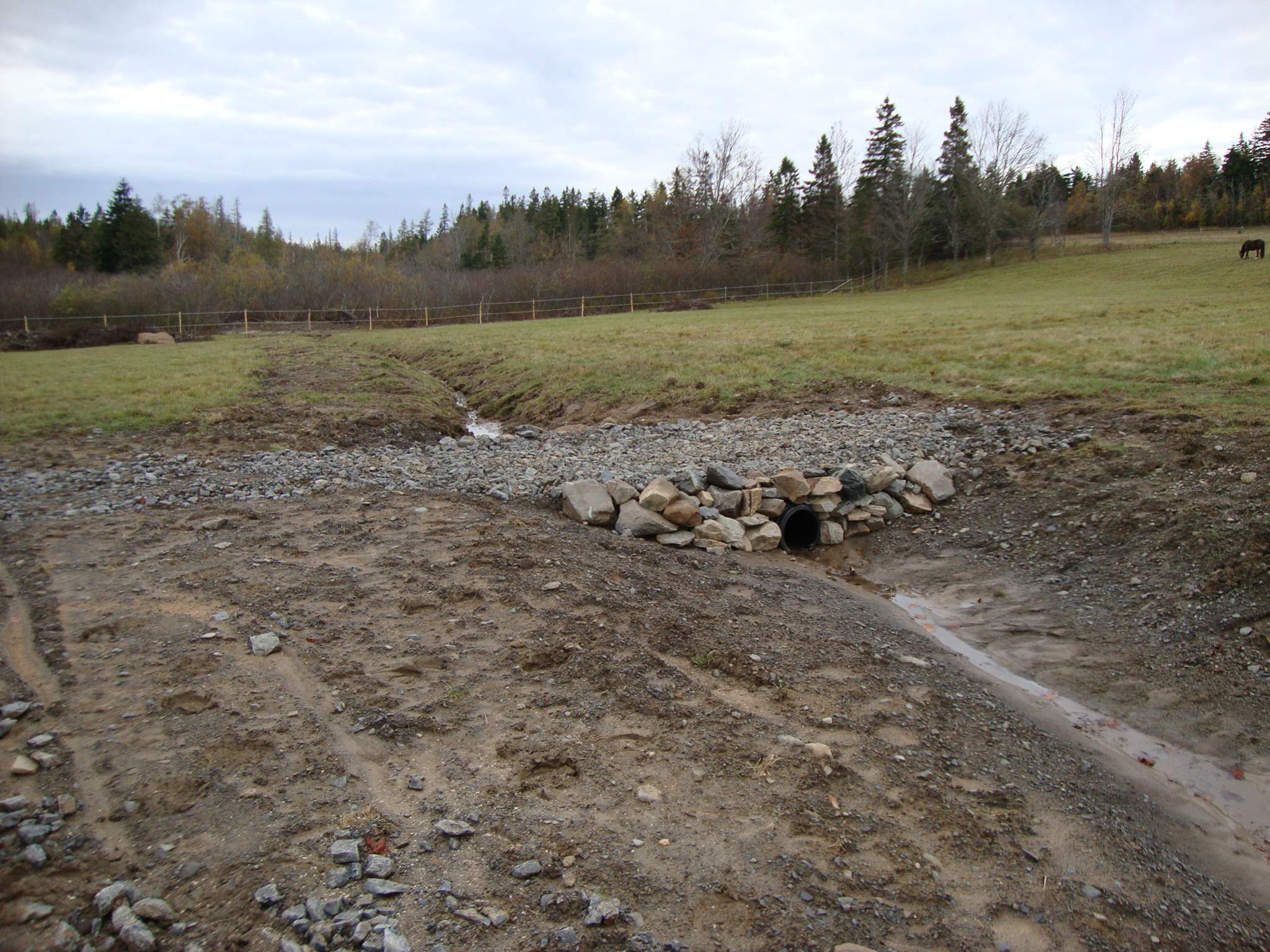

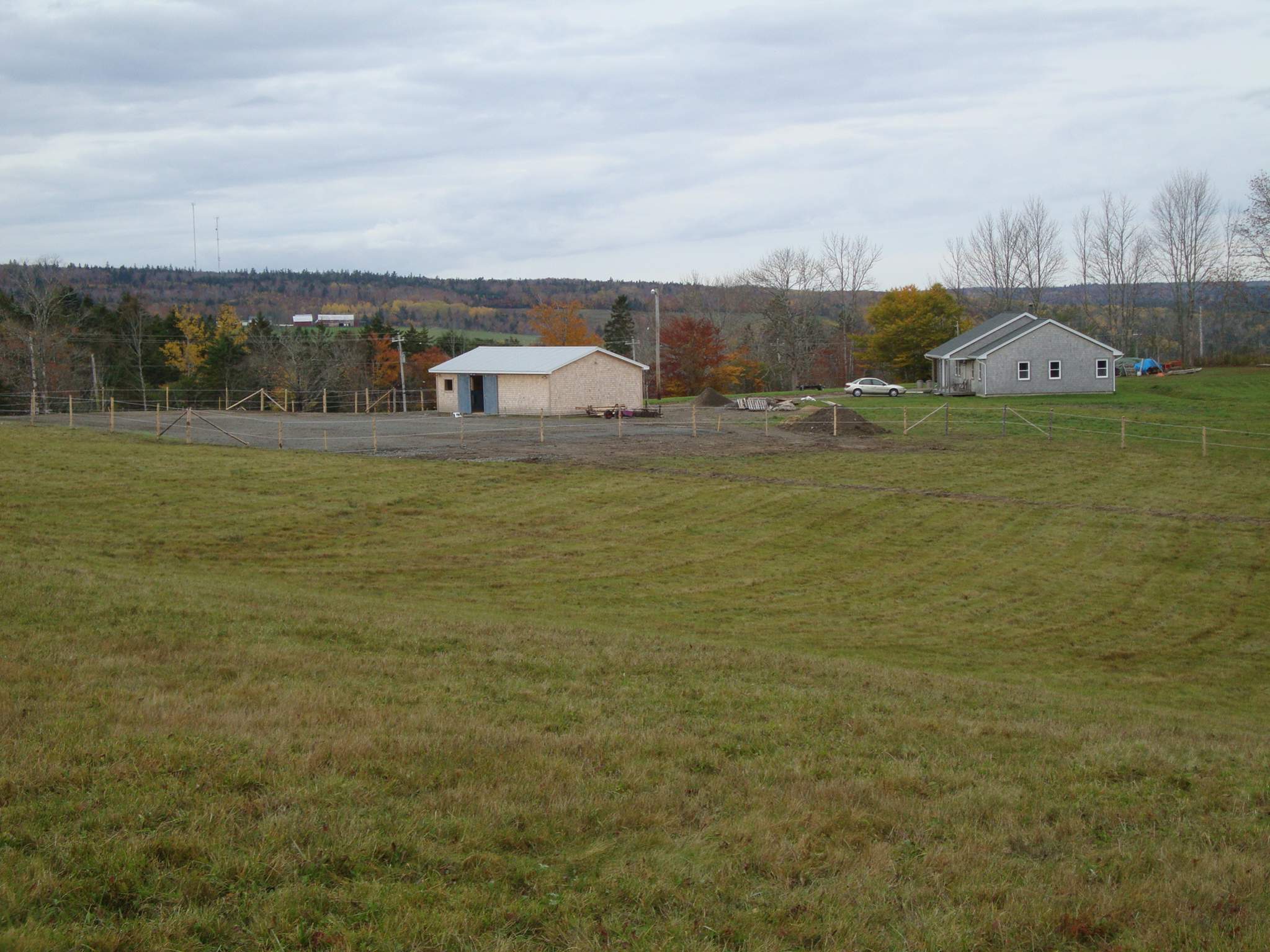

We added a culvert to the swale that feeds our pond, from the amount of rain we've had I think it was a good choice.
The inmates seem pretty happy with the new digs, they spent a good part of the day yesterday napping in the field. When they relax like that, they're at home.
