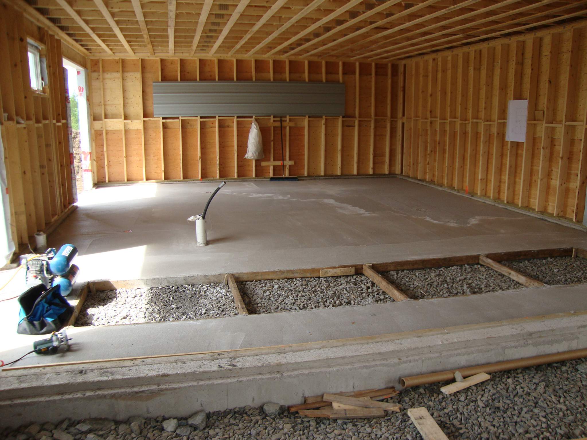

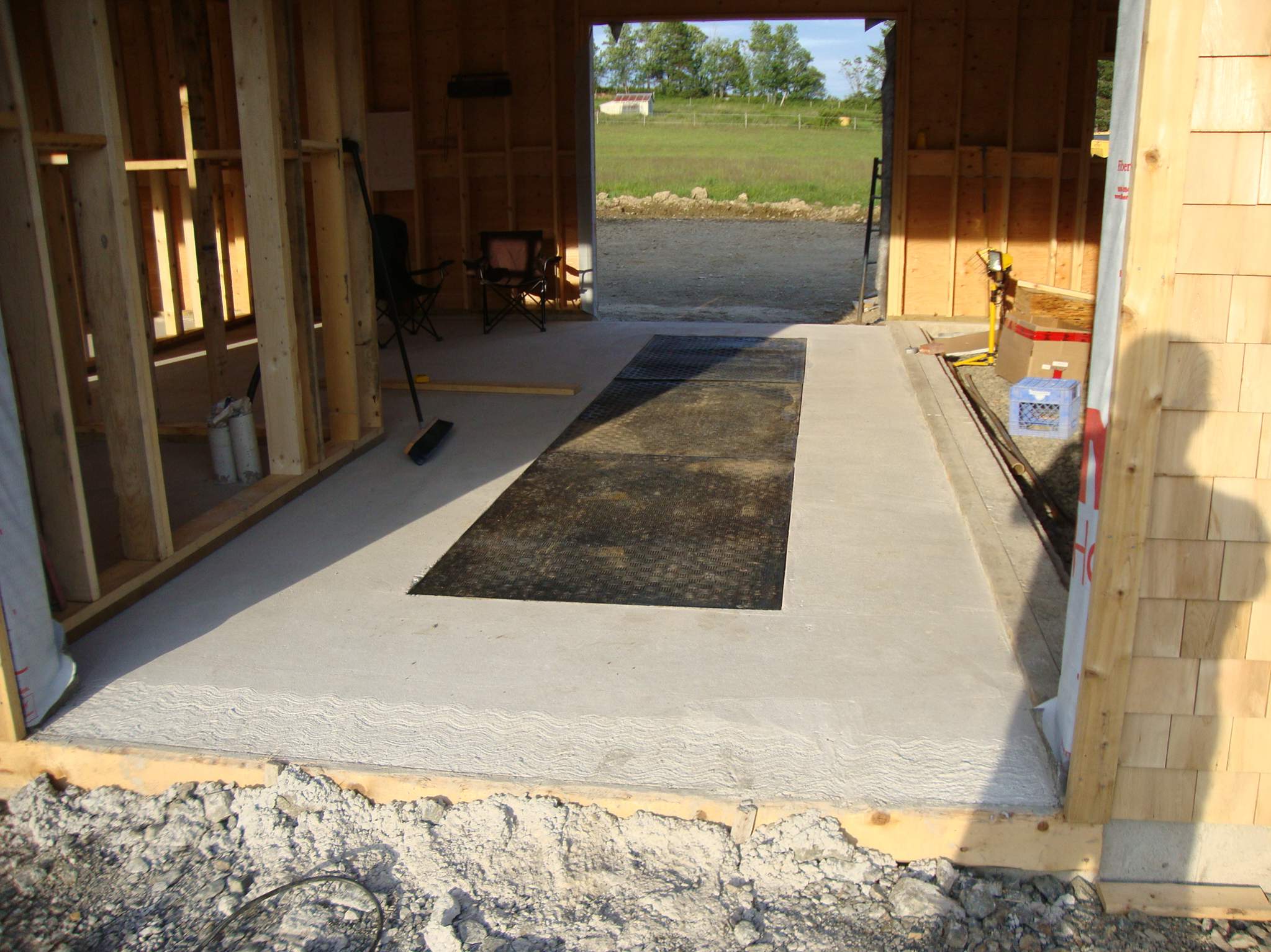

The first pour of concrete is in, and the second pour to put a bottom layer under the rubber aisle mats is due this morning. I have a couple drains to put in first.
The mats are about an inch thick, and will be set into a recess in the floor.

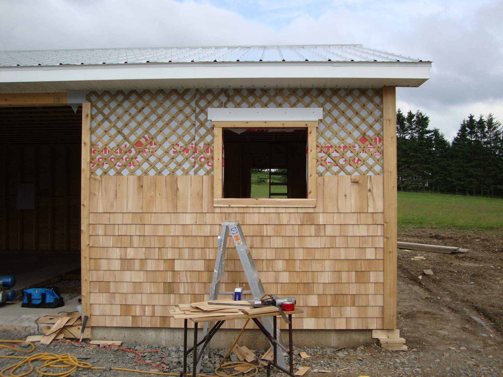

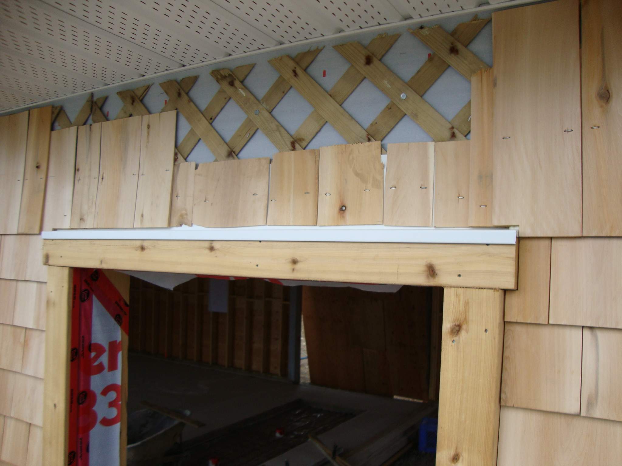

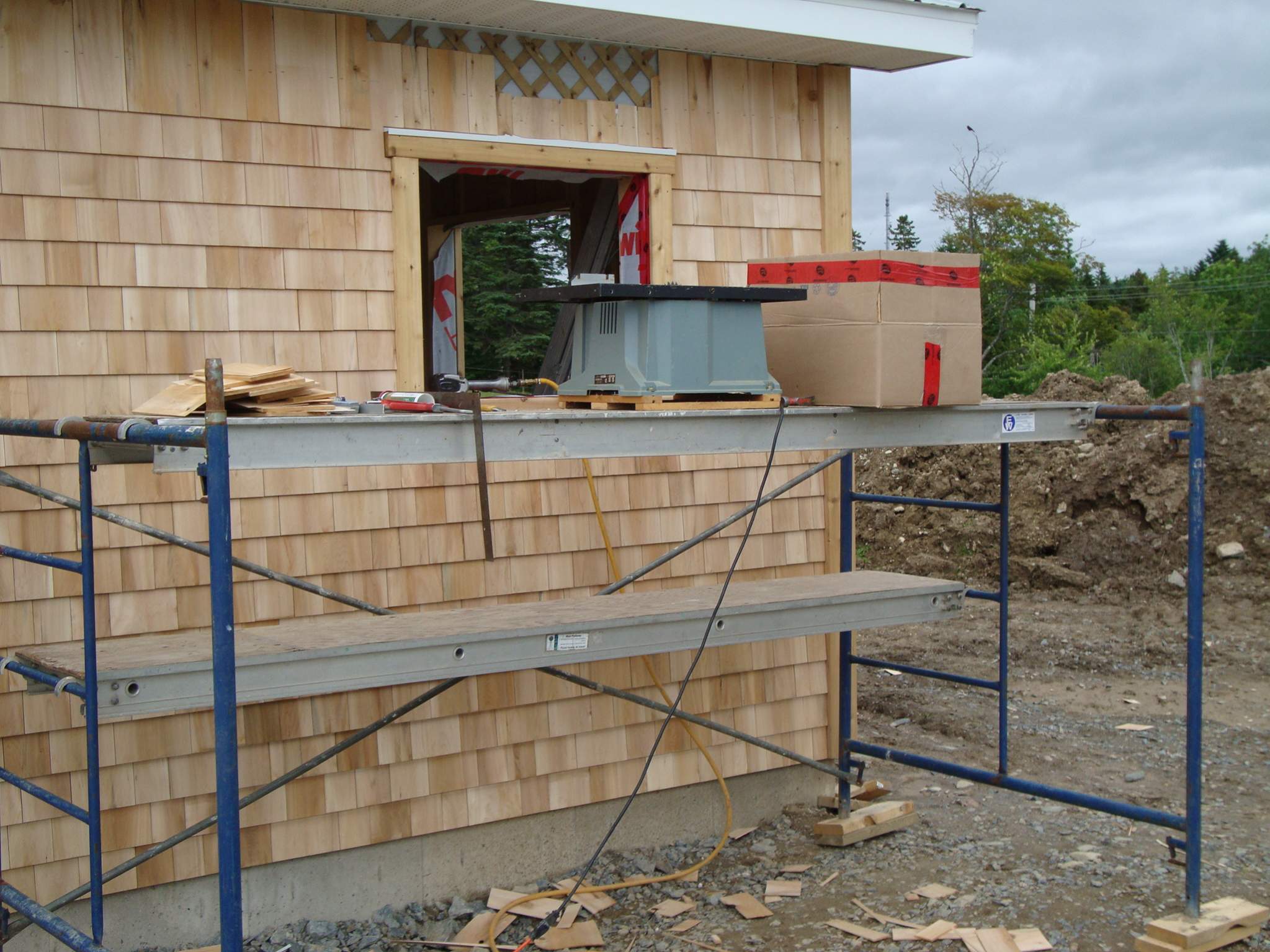

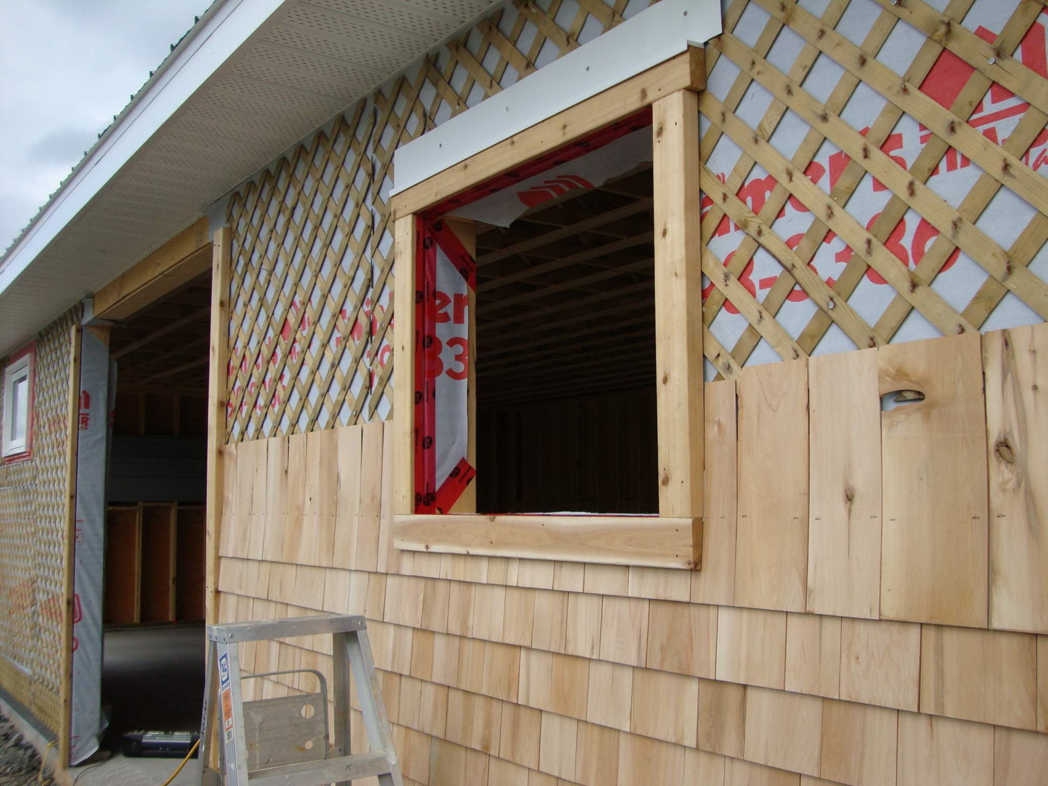

I started shingling the front yesterday, and worked on some window trims. It's 2x4 cedar, ripped on a 5 degree bevel to fit over the shingles on the bottom and blend with the same line of the side frames, which are set into the shingles. A good table saw makes a huge difference here. I have the old portable saw I used for the house, but that one is relegated to shingle duty only now, I picked up an older Beaver table saw a few years ago for more precise work.
We did the same thing with the house window trims, turned out well enough to do a matching job on the barn.

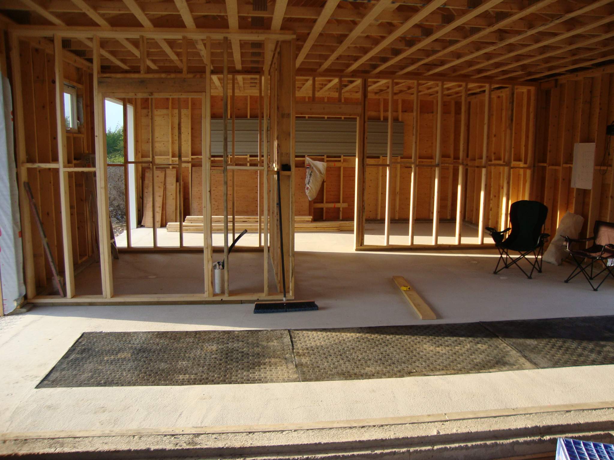

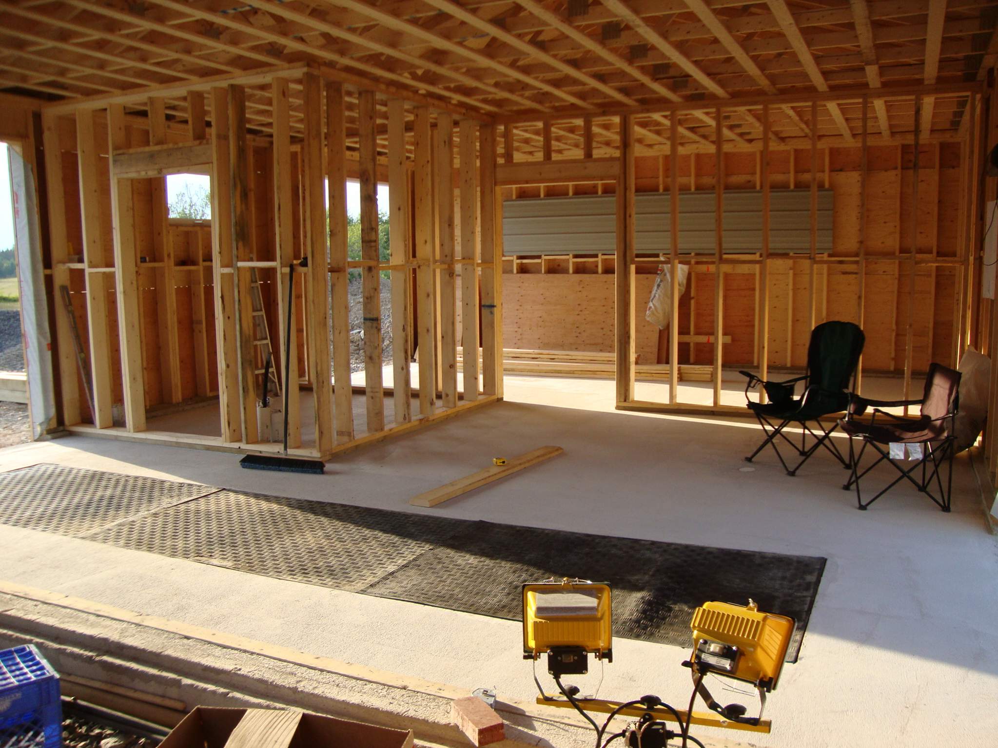

Concrete work is finished, I did a little more work on the shingles around some of the windows, and we started framing the interior partitions this weekend.
The rubber floor matting is in place in the center aisle way, tomorrow looks like more exterior trim and shingles if the weather holds.

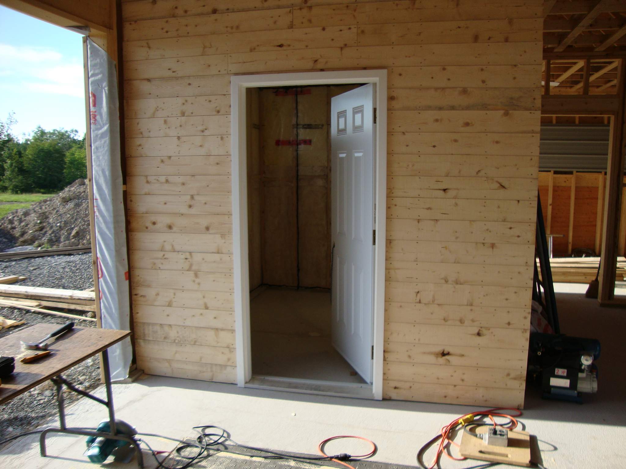

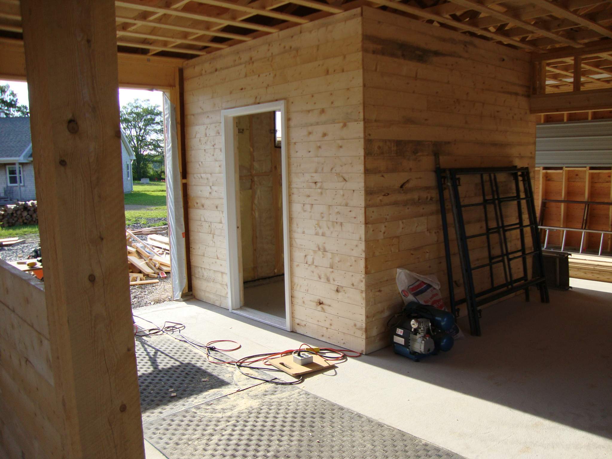

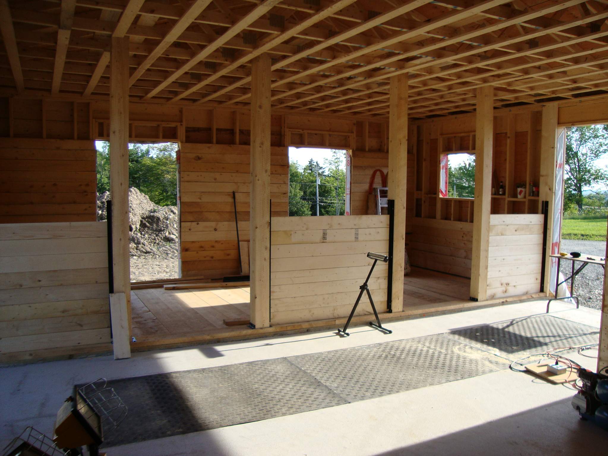

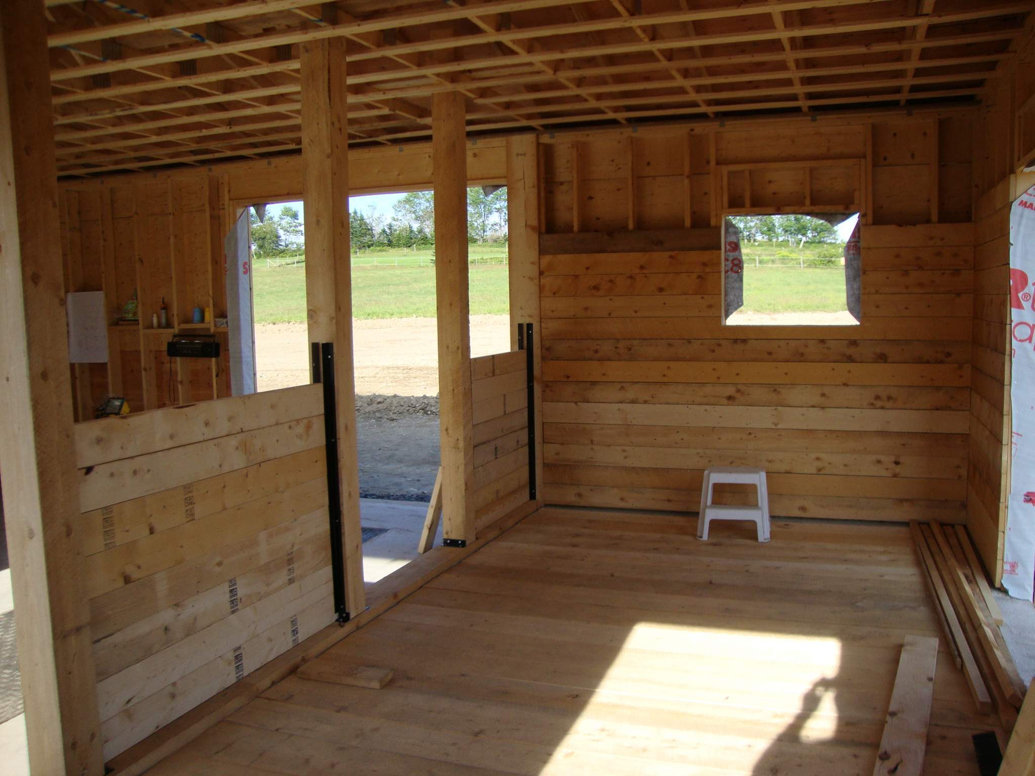

We finally finished the shingling last week, it took 37 bundles of shingles and about 12,000 staples. The interior framing is complete except for a few finishing touches on the stall walls and one more wall to board in with 1x6 tongue and groove.
We used rough 6x6 posts for the stall wall uprights, collared at the top with 2x6 and braced at the bottom with angle iron and lag bolts.
The tack room has been insulated and covered with vapour barrier, sealed with acoustic sealant and has the door installed.
The roll-up garage door is ordered, should be here in about a week or so. I have the barn door tracks, trolleys and hangers, it's soon time to start building the sliding doors.

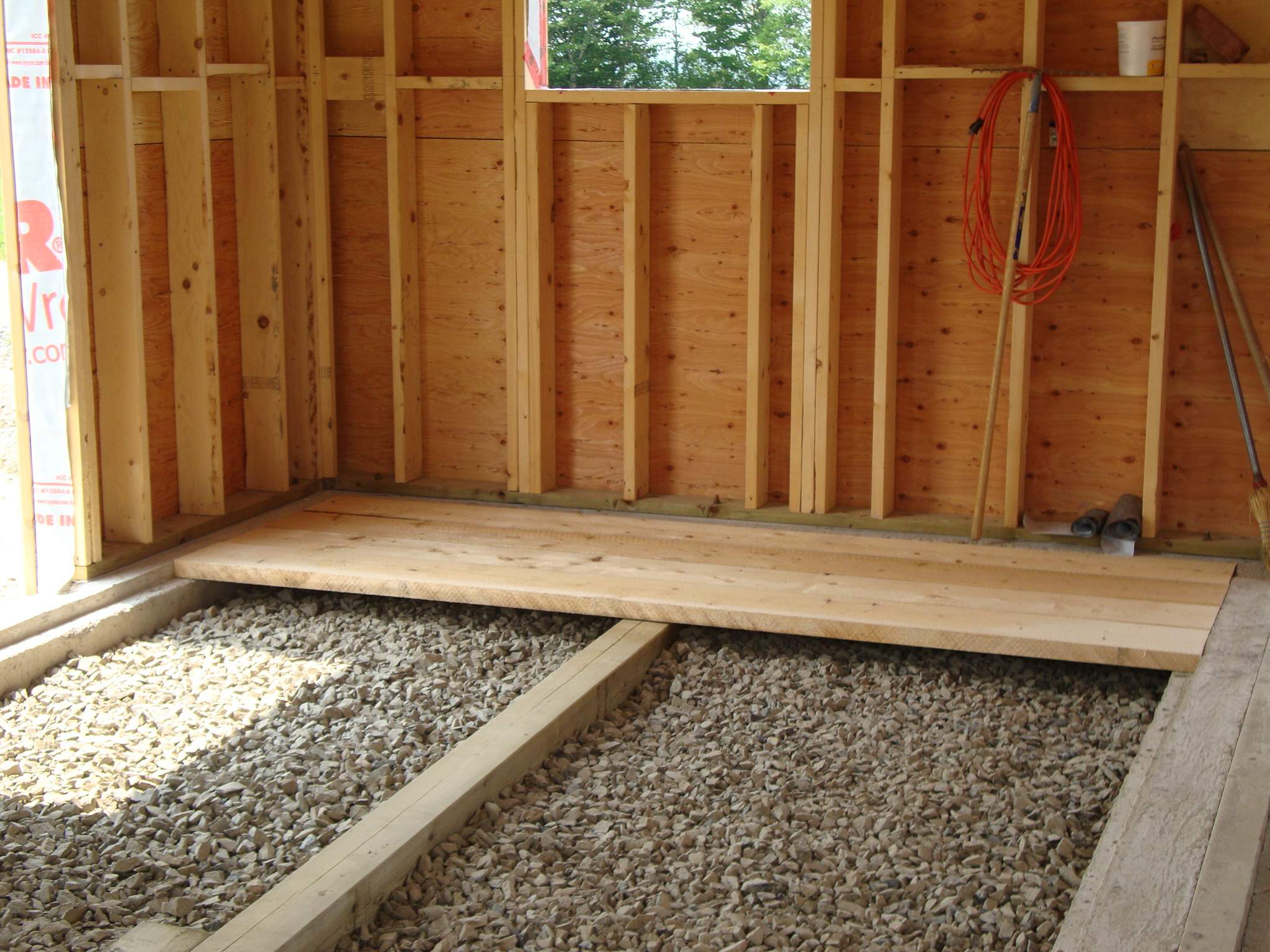

We finished the suspended floor yesterday, tonight my wife let her horse try it out, with her in the saddle too! Hardly any deflection at all, so it's definitely strong enough. We wanted the ceiling to be high enough to ride in and out if we want to, no problems with headroom. Morgans aren't that tall (our's are about 15h 2 tall).
Things slow down a bit with only my wife and I working on it, we're expecting the electrician next week to wire it and hook up power from the house.

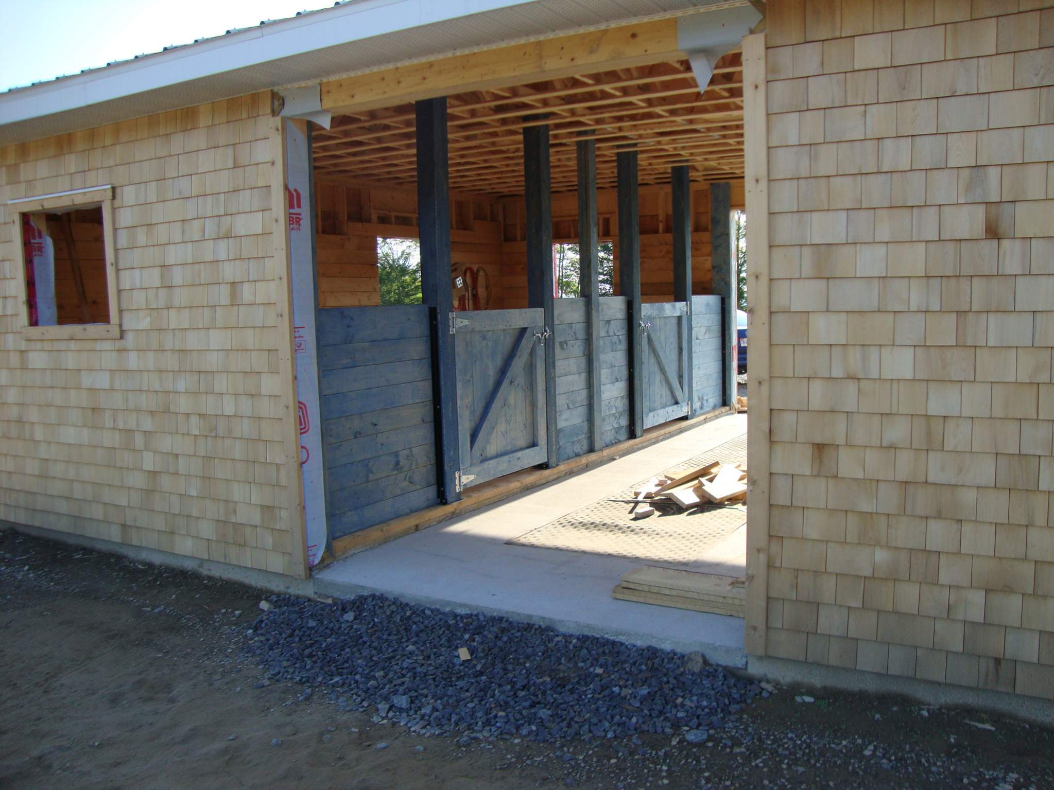

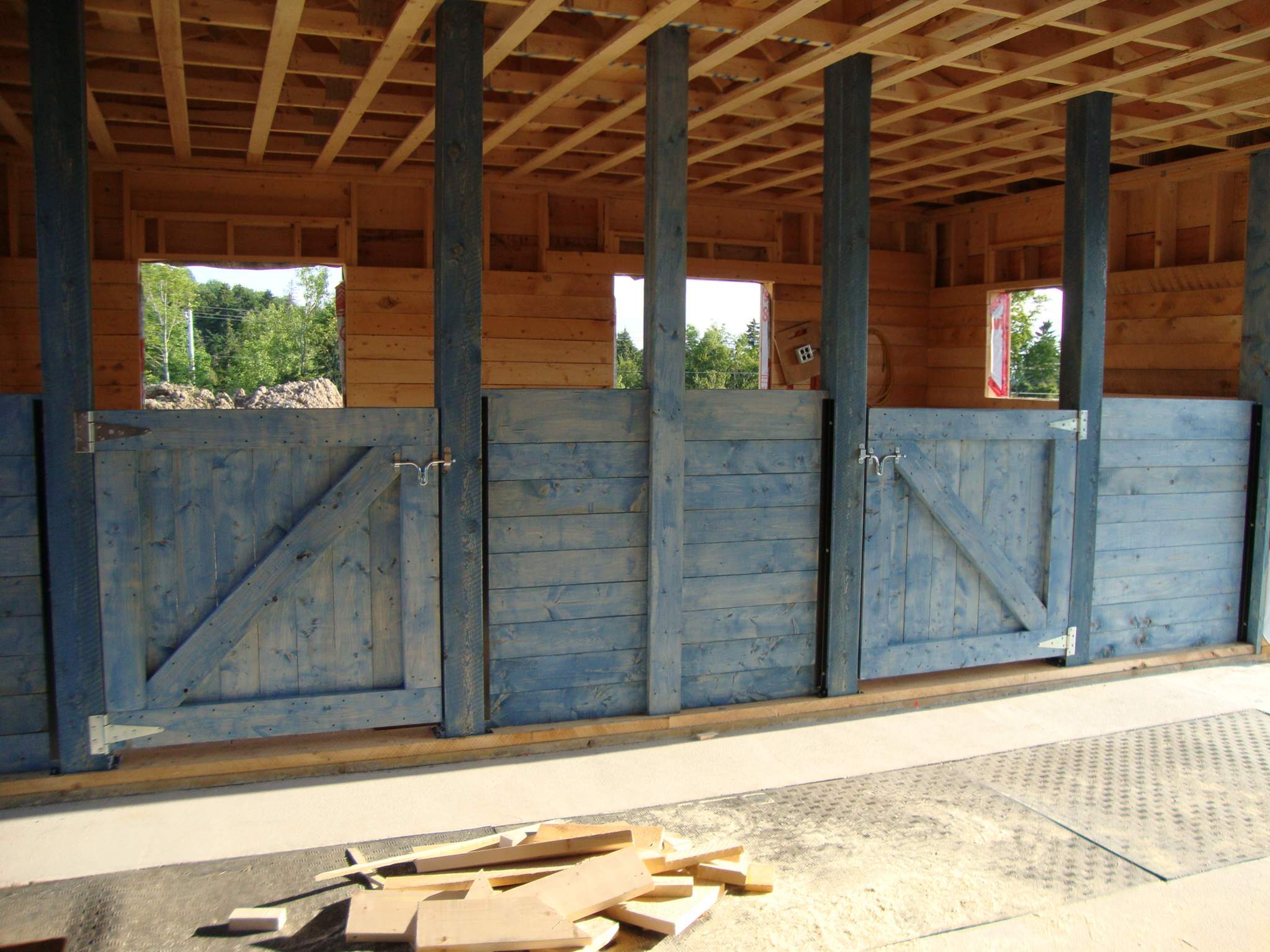

The stall fronts are finished, we're working on boarding in the interior walls in a few places now, dry-walling the tack room. Second coat of mud went on today, by Tuesday night we should be ready for paint.
