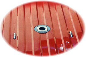

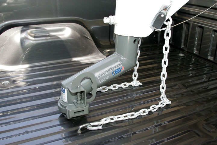

Eddie, click to learn about the Turnoverball GN hitch: Gooseneck Hitch | B & W Trailer Hitches
If you have a 5.5' short bed F150, you will need these.
The 4" offset ball.
When not using the ball the bed is completely flat.
Pictures from Google Image Search.

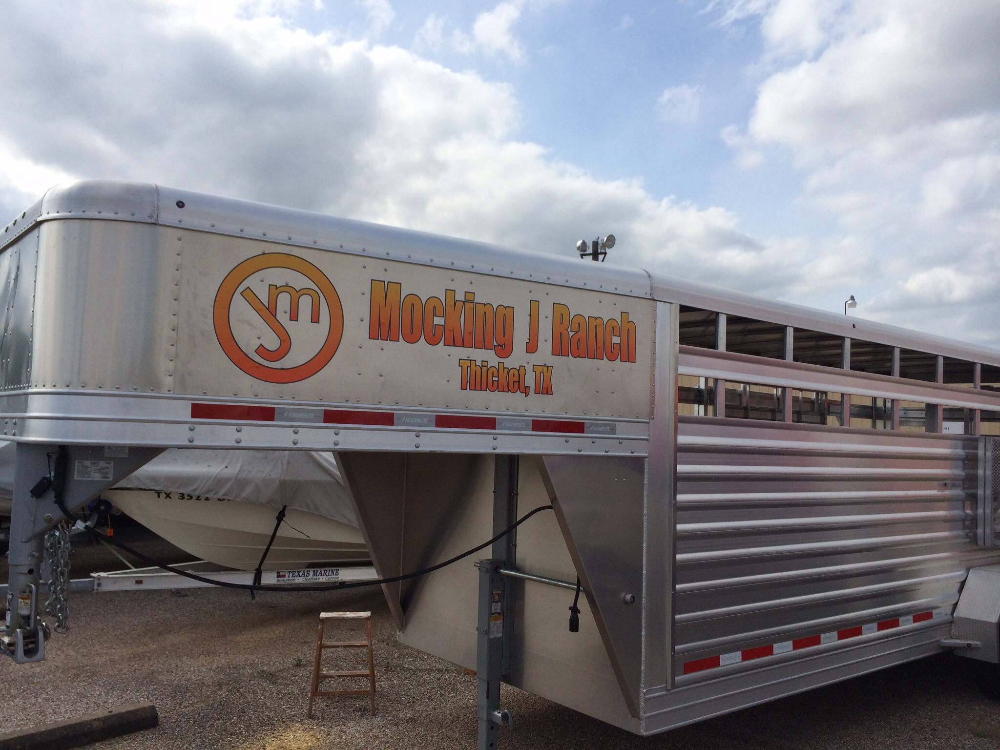

I will second the gooseneck! I am pulling with a 2013 Tundra and started with a 14' WW bumper pull steel stock trailer that my daughter won. I installed Firestone airbags to help smooth out the ride. Recently switched to a 20' Featherlite gooseneck. The gooseneck pulls so much smoother and does not through the truck around. I ended up installing a "pop-up" brand gooseneck and I do use a 6" extender. I had to use that brand since it's mounting bracket was the only one I could find that was compatable with the airbag brackets. Only took about 3 hr to install, including cutting the 3" hole in the bed.
I was looking for a 16' gooseneck, and found a couple 2012, new models in Dallas, but ended up getting a better deal on the 20' at the San Antonio Livestock show.
