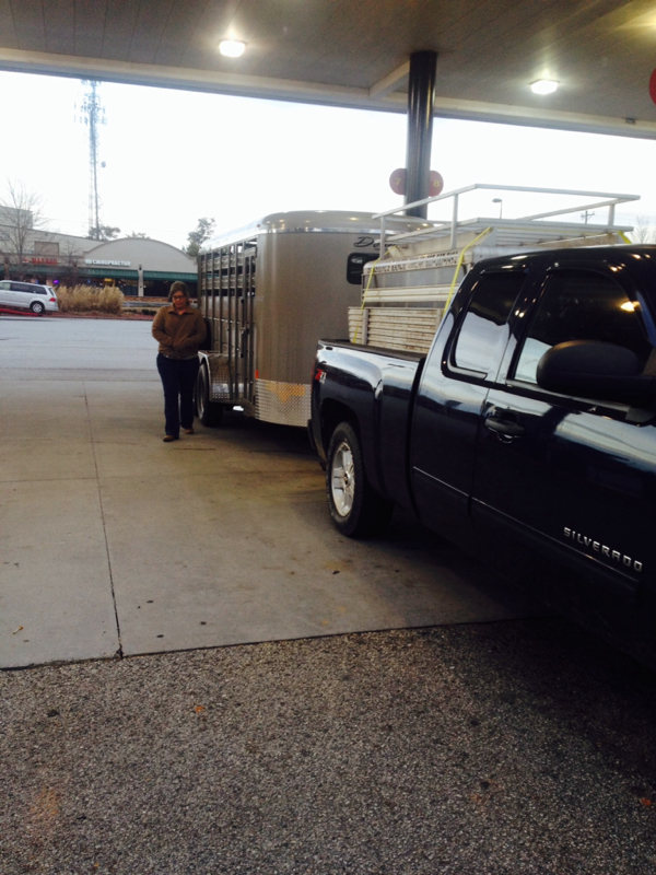

We just bought a new Delta stock trailer and I'm very pleased with it. Originally went to buy a WW, looked at a fine Neckover. First load of cattle on it in picture. Turbo messed up in my wife's truck, mine was in no shape for a trip, borrowed this 1/2 ton z71. 26 hours, 6 head, 1 boar hog, 0 trailer brakes.
