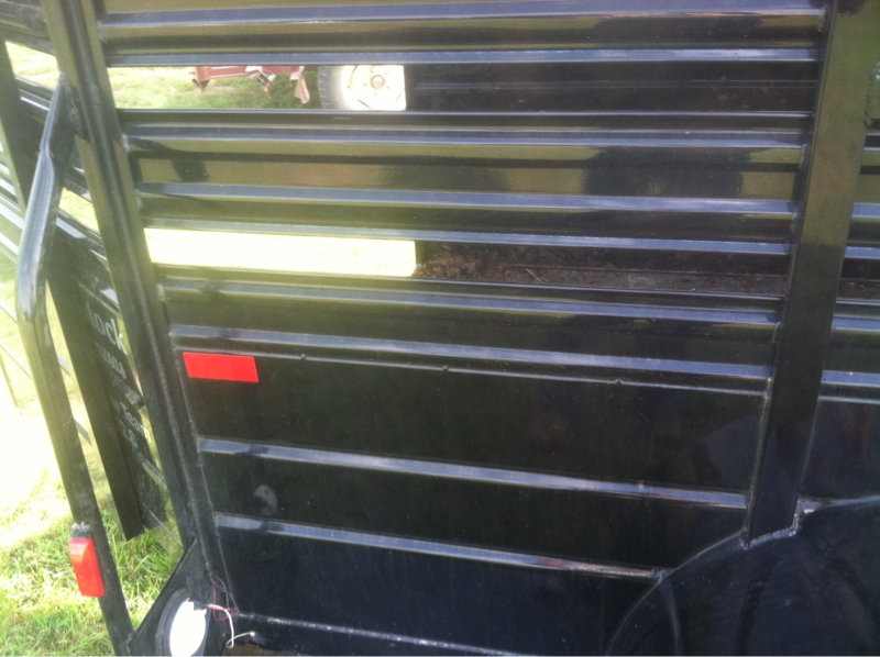

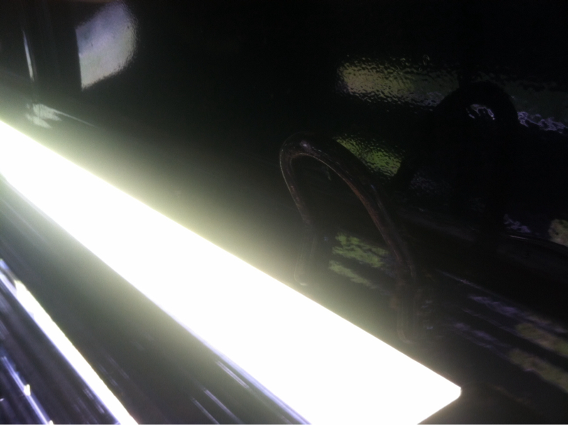

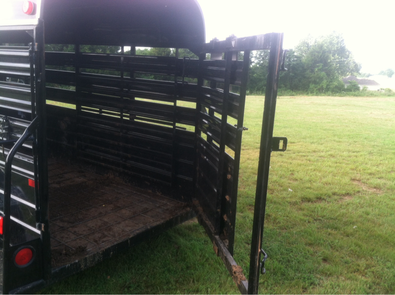

Hey Eddie sorry I'm late with the pics Here is a few. They show the back door that has the slider, the tie loops for tiying ur horse up, note the side are solid up so far, the tie loops an solid sides i the main things that separate a combo from a stick trailer. Also the little escape door. You want one. That is what this is. You don't want a straight horse trailer to haul livestock, especially a 2 horse can be done it's a pita. You can get combo trailers is a variety of lengths and heights with or without tack rooms up too 24 feet long on the bumper. No more than you plan on hauling and the trailer not being in use. I recommend something like mine n a 16 or 20. You can use it for double duty hauling. Do not buy a a straight up cattle hauler with open sides and a canvas top. That is something you will not like. The canvas eventually rots and has to be replaced. And I would stay away from a gooseneck for your use. This I a five wide in a 14 foot. It is fixn to b a straight pig trailer. For hauling out pigs. I payed 3800 cash out the door. Brakes on both axles, pretty diamond plate rock guards. And it's well lighted. We have pulled all I've the country with now issues. It's a WW. If I was gonna look into a long bumper pull, I would get a featherlite. With a tack room. Thy are only a little a steel trailer that's comparable. But will last a lifetime. That are aluminum. Exiss, and Wilson also make superb aluminum trailers. LUTT
