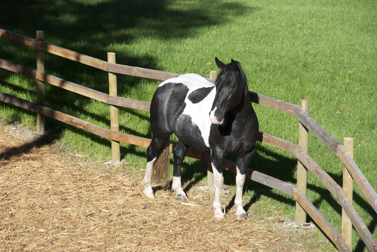

Our solution for this is a material called spaghetti hog but trying to hog an area of 2 - 3 acres would be expensive. Spaghetti hog is a forest by product, wood chippings in long strands that weave together to form a mat. We winter our two horses in a smaller area, about half an acre, where we have spaghetti hog throughout to a depth of about 3". Cost initially was around $2400 and we need an additional load per year for maintenance which costs around $600 delivered.
The stuff provides a soft surface for the horses to run around in, stops the area from turning to mud and mush.
We've also put the hog throughout our riding ring and on the surface of the access road up to it. I've attached a shot that shows the material.
