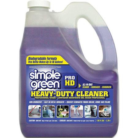

You might also get a jug of the Simple Green Pro degreaser. This stuff works great and is bio-degradeable. I buy it at Home Depot and it is not expensive.
Put it in a hand pump sprayer and soak the affected areas. Let it sit for a while then wash it down with water. If you do use a pressure washer be careful.
