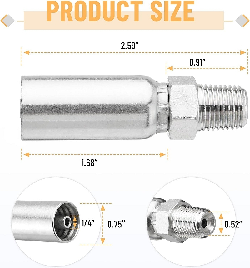

I'm no expert either but they're as common as JIC fittings. Nearly all the premade lines from places like TSC and Surplus Center come with NPT ends unless you order otherwise. I stock the ends myself. Shown below are 1/4" NPT.

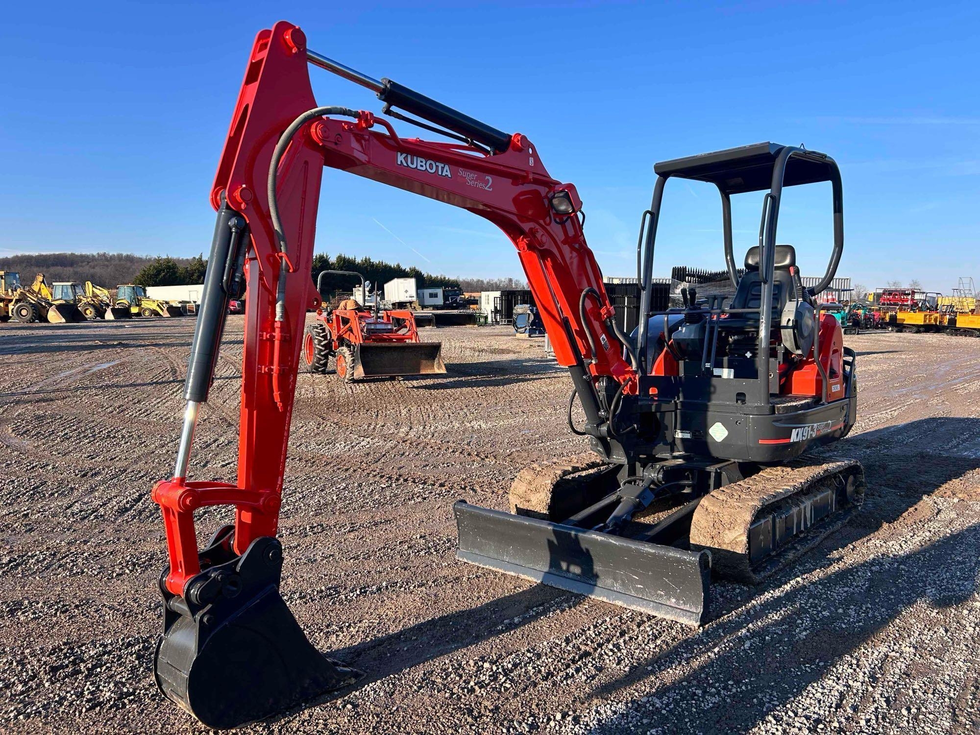

A lot of Kubota's, even newer ones, use NPT. As mentioned pretty much every consumer grade log splitters use NPT as well.
