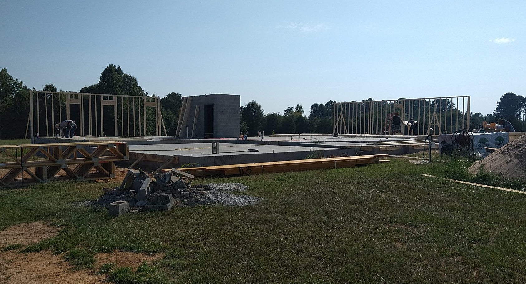

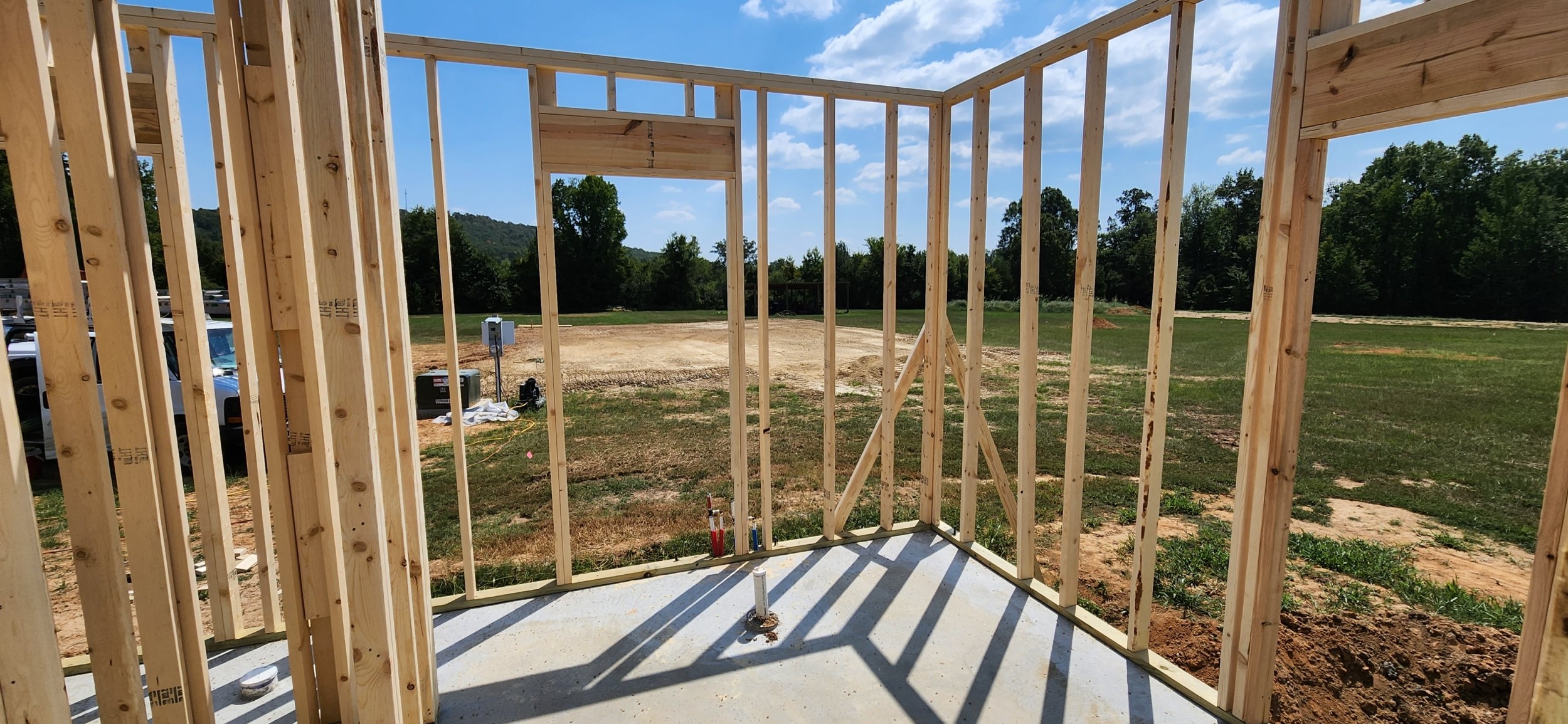

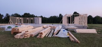

Ok let's get some framing pictures going. Like I had said a few posts ago, framing started 3 days earlier than expected. The slab was poured on Friday. Monday my builder sent the first picture below around lunch. There had not even been any material when I left for work. These 3 were from far l day 1.
