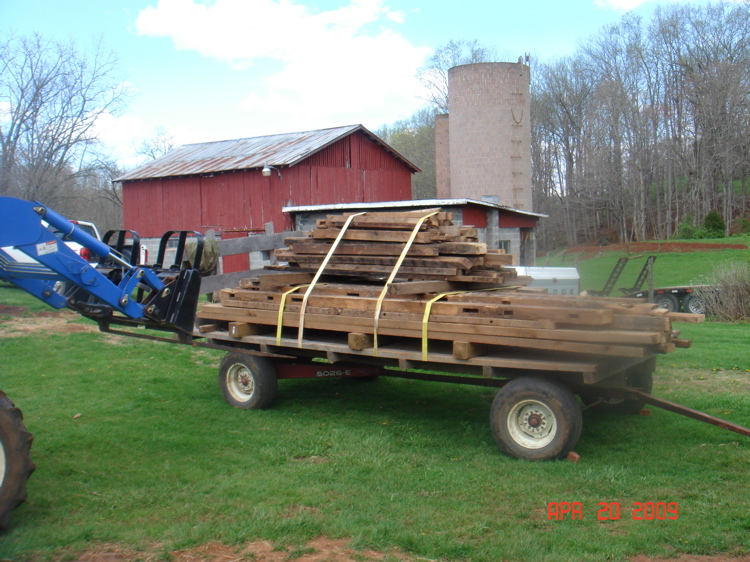

Some real nice timbers in there. I'll take some close ups of the brick this weekend. Someone told me that a lot of them appear to be "sun dried" as opposed to kiln dried. The bricks on the outside of the chimney look as though they are much harder and more uniform than the brick from the inside of the chimney.

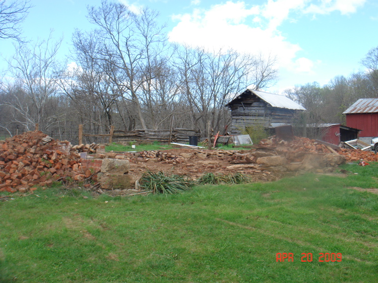

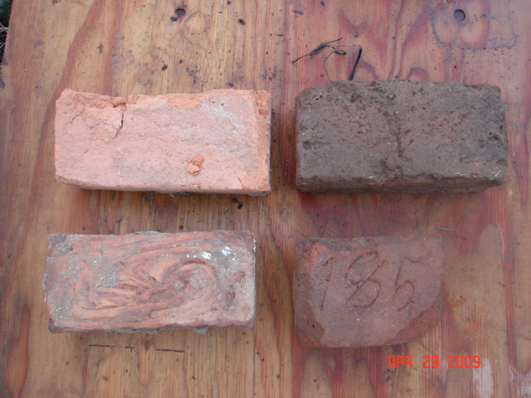

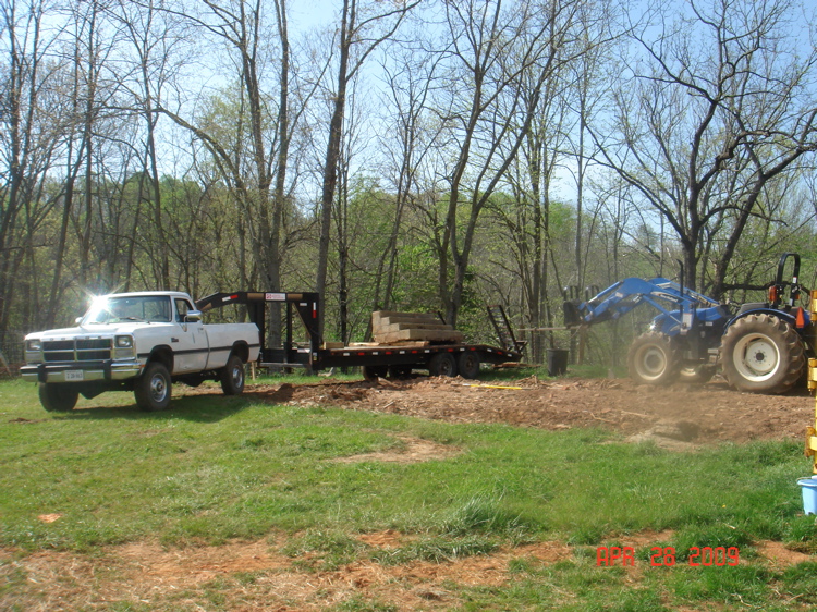

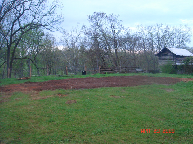

Got the project done in the last few days. Here are a few pictures of the progress. First is the HEAVY set of concrete steps that I found someone to take. Next is the site after a few passes with the box blade. Last are some of the different types of brick I found. The orange bricks broke into powder, the others were much harder. The one in the lower right was found at the base of the chimney, not sure if it is part of a date built or not. Fun project, but glad it is done, now on the large play fort that will be built on the site

Stoney, nice project, I am glad you shared it with us. Years ago I helped take down an old tobacco barn and it is a lot of work.
The roman numerals cut into the rafter and the grease pencil markings, like a shipping label, on floor boards has me wondering if the whole house, trading post, was brought in as a kit by train. That would explain why the construction was unique for the area. Anyone know if kit houses were being made in the 1860's?

Bricks definitely look hand made/home made.
The orange ones are usually softer, indicates less heat during the firing process, bulging blistered bricks are typically over cooked.
If they all vary in size,shape and hardness like that it would be hard to incorporate them into a project. Maybe interior veneer work with a good sealer on them to keep the dust down.
Seeing the cleaned up house site, it's hard to imagine there was ever a house there. Erased from history except for the pictures.

stoneyfork, interesting read. I noticed we have the same hay wagons. I've been trying to identify the weight rating on it for a couple years now with no luck. Do you know what yours is?

Negligence - I don't know the rating on mine either, bought it used, seems pretty stout though.

I would say it is a 8 ton
If you posted more pics I could tell you for sure
