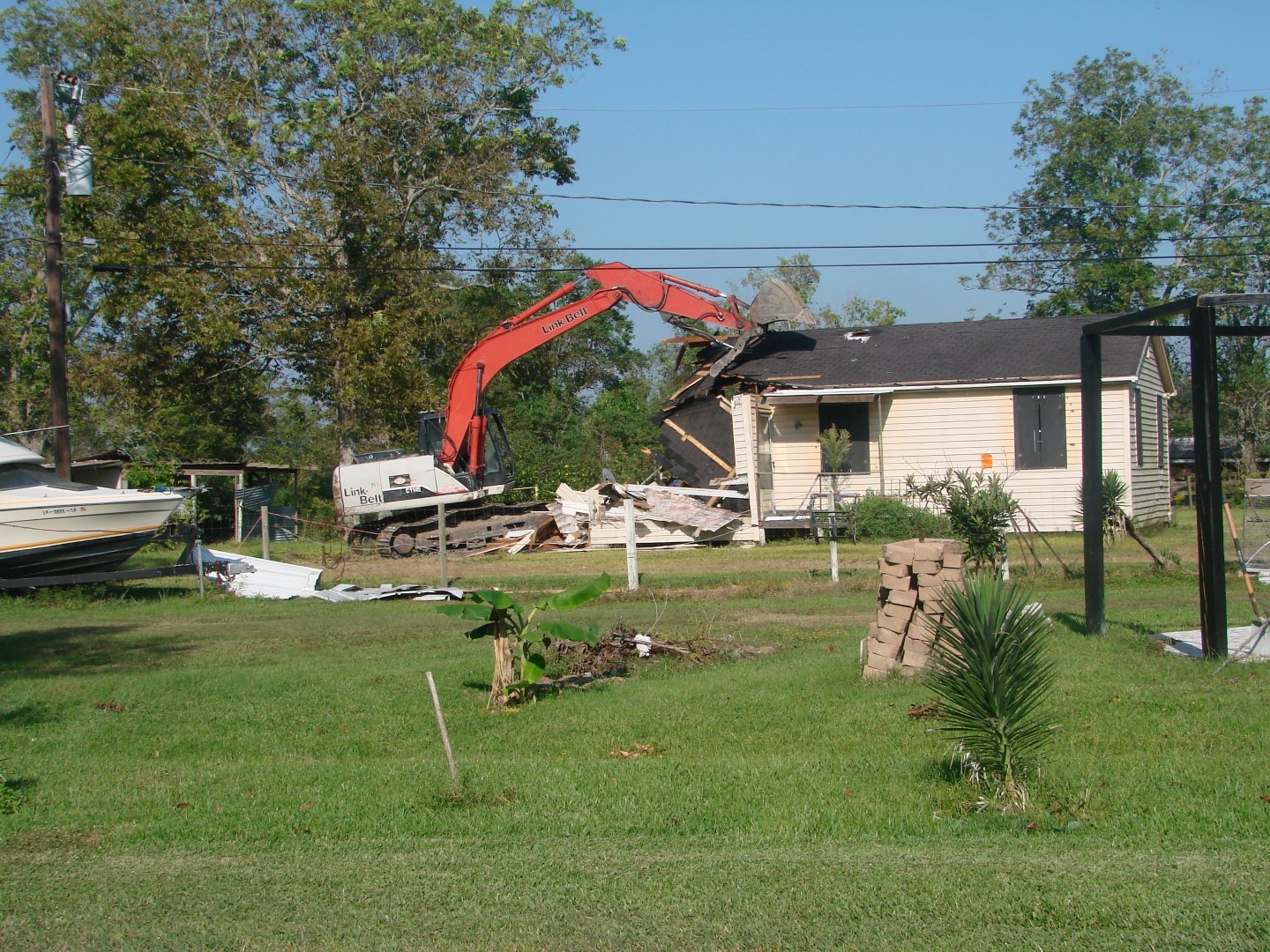

I have experience demolishing a few houses...
House 1:
The first was an old house built in the 1960's which was 24 x 40. I used a small excavator (#34,000 pound class) to knock it down which took about 45 minutes. It took another 3 hours to clean up the debris and put it into big steel dumpsters. That took (2 more) than the one we intended to use, and yes I mashed every bit down that I could to get more room. The volume of a house is staggering, so plan ahead. Also, the truck driver would not allow anything outside the metal body, nor anything over the sides of the dumpster. Rental on an excavator that size is about $500 per day, add in $150 for diesel fuel, and then dumpster costs.

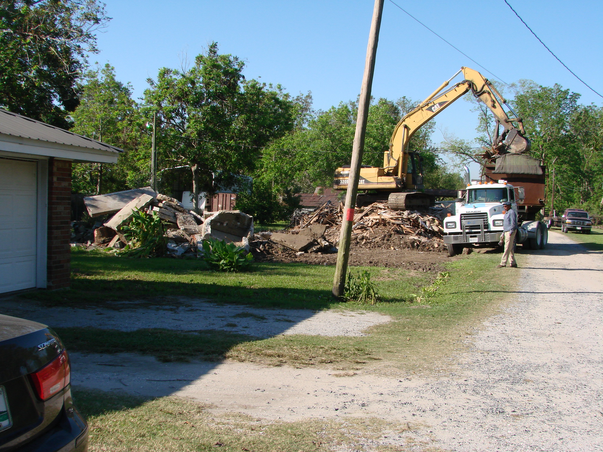

I had 2 houses torn down on property that I bought within the last few years. A cheap permit consisted of having the utility companies come out and unhook the phone, electric and gas lines at no charge and having the septic tank pumped out, filled with sand, then dug up when the house was demolished.
I was charged $4000 for the larger house and $3000 for the smaller one.
Both jobs were done in one day each. The excavator operator was skilled in smashing down the material completely so it would fit in the least amount of disposal units to cart off.
