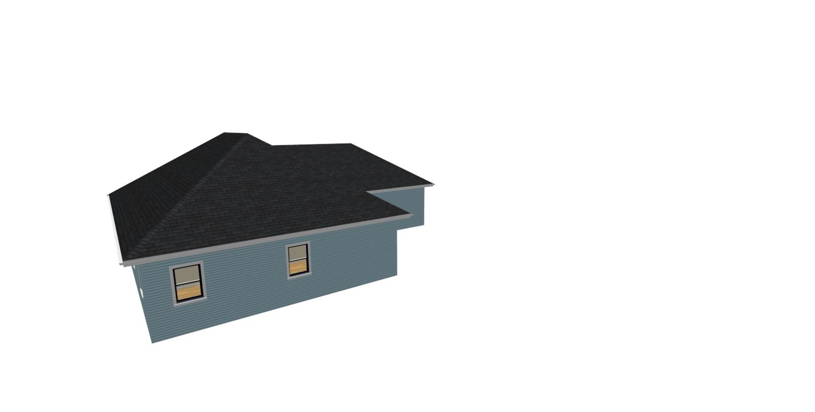

You are tearing off the existing trusses when the weather gets better? Visit the good lumber yard or truss company for ideas. Hips an valleys are opportunities for expense and leaks.
On our house I have a 30x36 footprint with the rafters spanning the 30 foot. 36 is east to west. The 22x22 too small garage attaches on the west side of the 36 wide with a setback at the front of the house. Front porch is 36'. North wall is 48 feet long. If I ever commit to building a proper garage the 22x22 becomes a great room with hopefully a laundry room and a half bath. That frees up the former laundry room to become a closet.
You are correct (full gut and new roof).... 35 year old house with the chicken coop metal roof- I don't like valleys either but will have to to opposite intersecting roof-lines.

If you stay with the same pitch on both the house and garage, the house ridge line will be higher due to the width of the structure. I added hip roofs all around as it looked a bit better to my eye but gables would work as well. Scissor trusses can be designed to give you the interior pick you require.
I am digging your solution... varying the pitch would solve the (bump out) depicted in your image.
