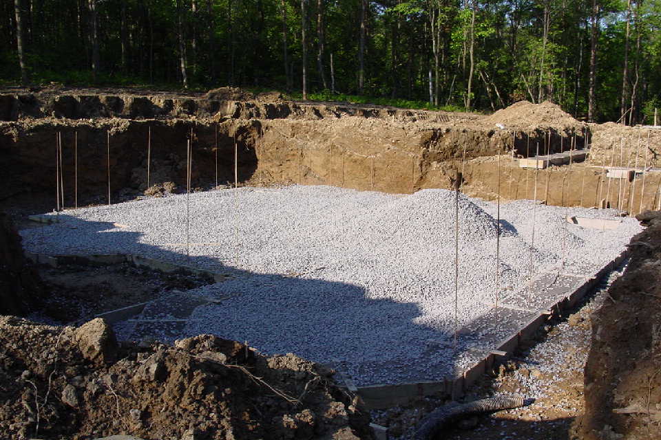

Those are some wide footings. It also has an interesting footprint. I'll be interested in seeing the final product.

It's pretty sandy alright. We found several layers of sand and one layer of clay as we cut into the hill. One sand layer is pure beach sand (know locally as sugar sand). Several feet further down are the clay layers, several colors. We bought the property from a clay company when they decided not to mine the clay.

They are very wide - four foot. They'll support the wall (16 in thick x 10 ft 6 in height) and go under the concrete slab floor. Definitely not the norm for local construction. House is being built to the latest 2002 international codes. Foreman told me that they poured 47 yards into the footings yesterday. He is estimating 100+ yards for the foundation walls. We were going to have a 12 inch wall with a ledge protruding at the top for siding materials (stone) but it turned out to be cheaper to pour 16 inch walls and make a simple step for the ledge. I'm sure that the basement will be the coolest location in the house during summer with that much mass.

I know what you mean. They did pour the footings today. I stopped out at lunch time and got so caught up it I 45 minutes late getting back. Nice group of guys. The excavation team (father & son) were helping out the cement team. It was four guys, two young summer help types for back muscle and the two guys who I figure own the company. They have been pouring foundations for over 25 years.
They are going to get working on setting up the walls and plan to pour next Thursday (rain forecasted so far) so we will see how it goes. I plan to take the day off and watch it brings back the childhood days of suburbia and watching all the houses going up.
Took some new pics and this one is the basement with the footings poured and the stone in place. They left a pile of stone since the excavators have a small area to dig out due mud moving.
They are going to put extra stone in before they backfill after the walls are in on the side and front right corner. This will help with drainage and water issues.

Plans call for a poly vapor barrier (probably Tyvek) on the walls overlapping the "membrane water proofing system" on the foundation walls. This membrane is then covered with a "hydrostatic pressure relief system" (Enkadrain) to the bottom of the footing. There is also a 2 ft by 3 ft gravel bed around a 4" perforated drain at the base of the foundation wall to remove any water from the hillside. The house has a granite sill with cultured stone veneer as a wainscoating. Above this is a mixture of brick and wood siding dependent upon location. Thanks for the tip. I'll quiz the contractor about this potential problem area.
