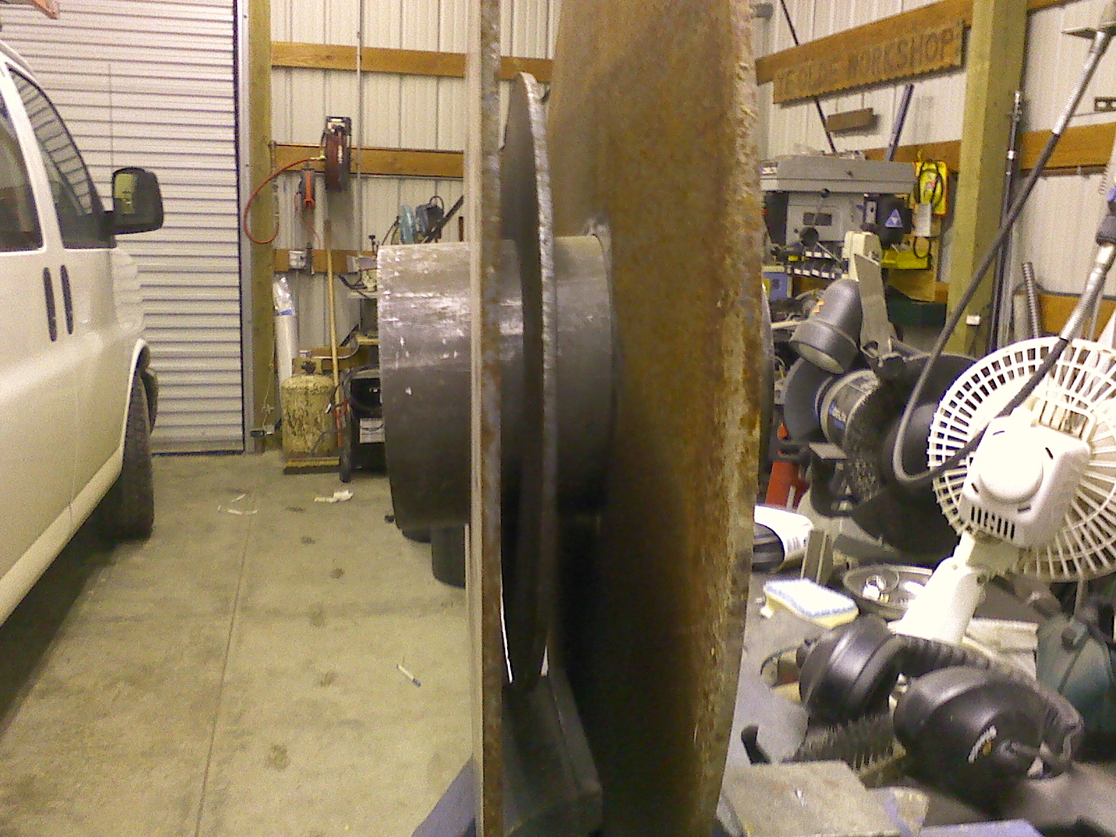

Thanks for all the replies. I did the outside ears a year ago and left the inside ears as a stiffener. Now I have a QT loader so the other ears need to go. I don't recall this being fun. I used a torch, but I suck with a torch. I thought maybe a plasma might make it less painful. After looking a the pic again the fillets look small so maybe a cutting disc is the way to go as rjmack mentioned. I think I have some for my electric grinder.
A plasma cutter I think is easier to use than a torch if you're not use to using either. But if you don't own a plasma cutter I wouldn't buy one unless you have use for one to do multiple jobs or or future plans. For a couple of bucks each you can buy a lot of cut off wheels for the cost of a plasma cutter.

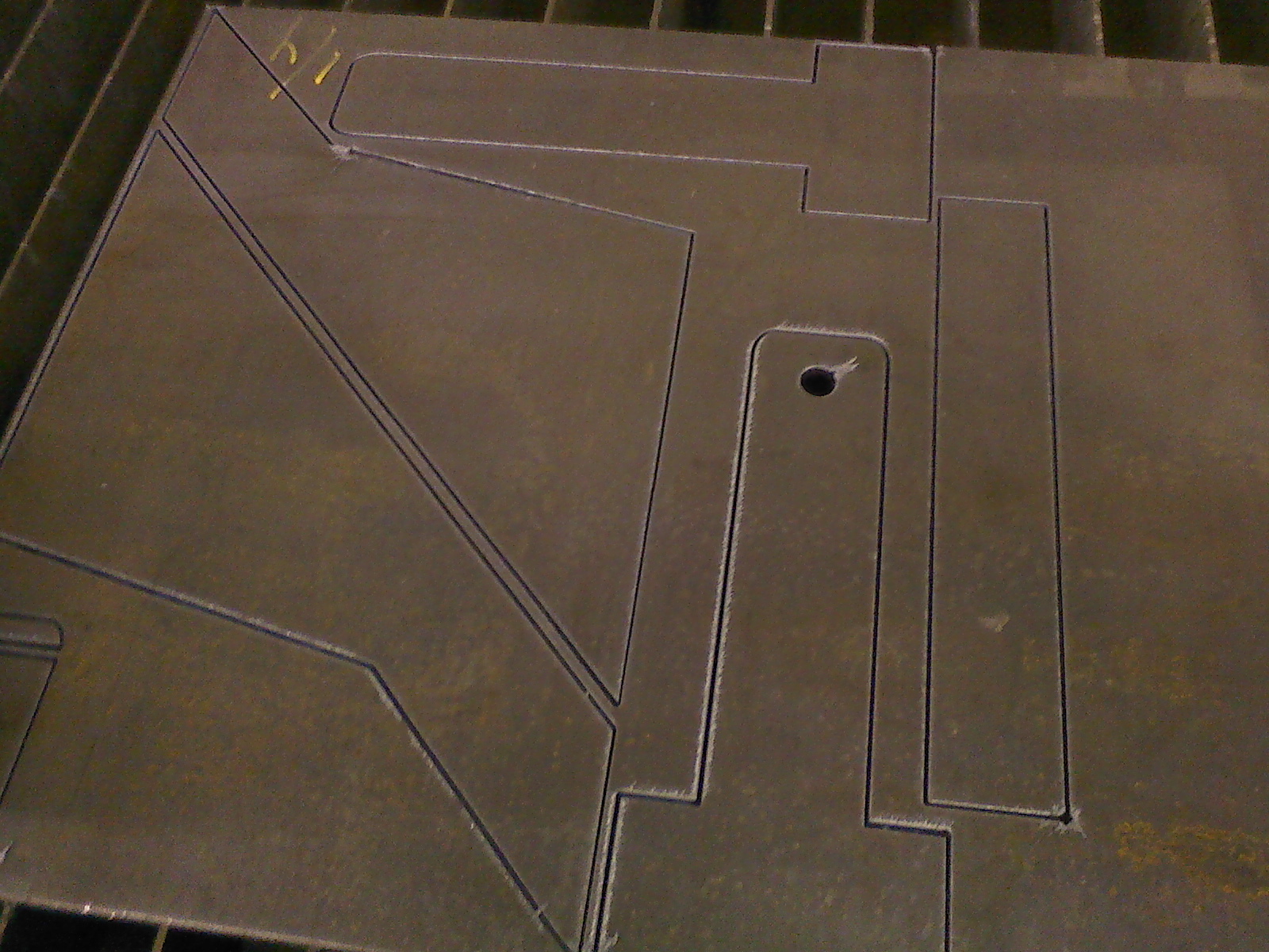

No use for Plasma in the Metal Fab World? Plasma " Should " cut as well as a saw with more accuracy than a cut off wheel. You can turn it up or down. Man..What Brand are you using??
   / How close to flush will a plasma cut? #16
i have a hypertherm 1000 and i cut aluminum checkerplate all the time. does a great job and no distortion.
MInd you mines on a cnc table moving at a fast clip. maybe your moving too slow.
I get very nice percision in metal fab work. This is in some 3/16 and 1/4" stock

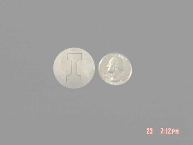

Here's some nifty cutting my brother-n-law did.
