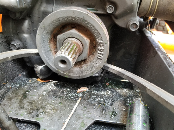

With the radiator out and the sheet metal and fan out, I finally got a really good look and a photo.
The damage isn't limited to the hole, which is small. The front cover cracked, and the cracks are pretty long. I contacted the dealer for a service call.

I believe I told the story of the hole earlier, but in case I did not, it happened while the steering cylinder was being installed by yours truly. To get the cylinder into place and to bleed the hydraulics, I moved the steering wheel, and the rear end of the steering cylinder rod rammed the gear case cover.
Kubota put this cylinder inside the frame, so it's in front of the engine.

He confirmed that I can jack the tractor by the oil pan, and he said taking the engine out was not going to work. He said I might be able to remove the frame from the engine and slide the front mess forward to get access to the screws.
I took a look at it, and while the frame is screwed to the engine, and the so is the loader, it appears there are other screws that attach the transmission to the loader, and they can be left in place when the front frame is detached. That would hold the loader up while I slide the frame forward.
It appears to be a matter of 4 screws on one side and 5 on the other. I may be able to handle that.
He also said they are willing to attach the cover and leave the rest of the work to me, as long as I understand they can't warranty it. That would save me a lot.

Thanks for reply. I was unable to find any indication in thread as to why the hole occurred.
Since you know the steering cylinder ram pushed the hole into the cover, I would be concerned about metal debris being pushed inside the engine and potentially becoming cause of even greater damage. Timing chain and sprocket, valves if timing chain jumps teeth, and ultimately collision between valve and piston head. Diesel compression engines when piston at top dead center have very small cylinder volumes to gain the high compression and that could mean valve/ piston collision.

I have to replace the front cover on my Kubota myself because the guy who said he would do it has disappeared. I got the radiator and other obstacles off. Now I have to remove the nut on the front end of the crank.
This appears to be a 45mm nut. My biggest impact socket is 23. My biggest crescent wrench is about 44.
How do I get this off? Are they insanely overtorqued like just about every other fastener on the Kubota?
I don't even know if I can immobilize the crank. This tractor has HST. Also, I'm not sure whether I could get the impact wrench in there if I managed to find a deep socket.
