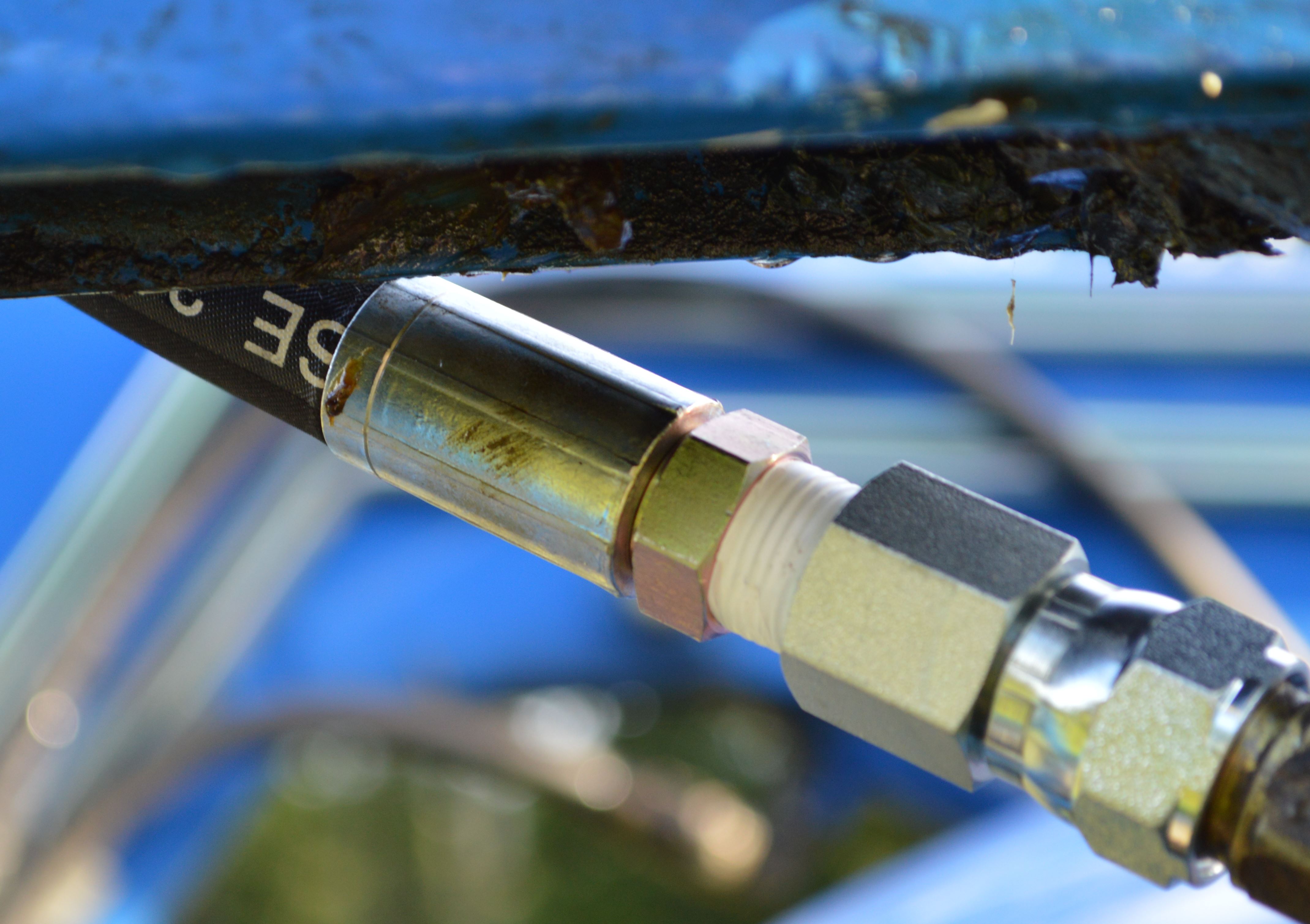

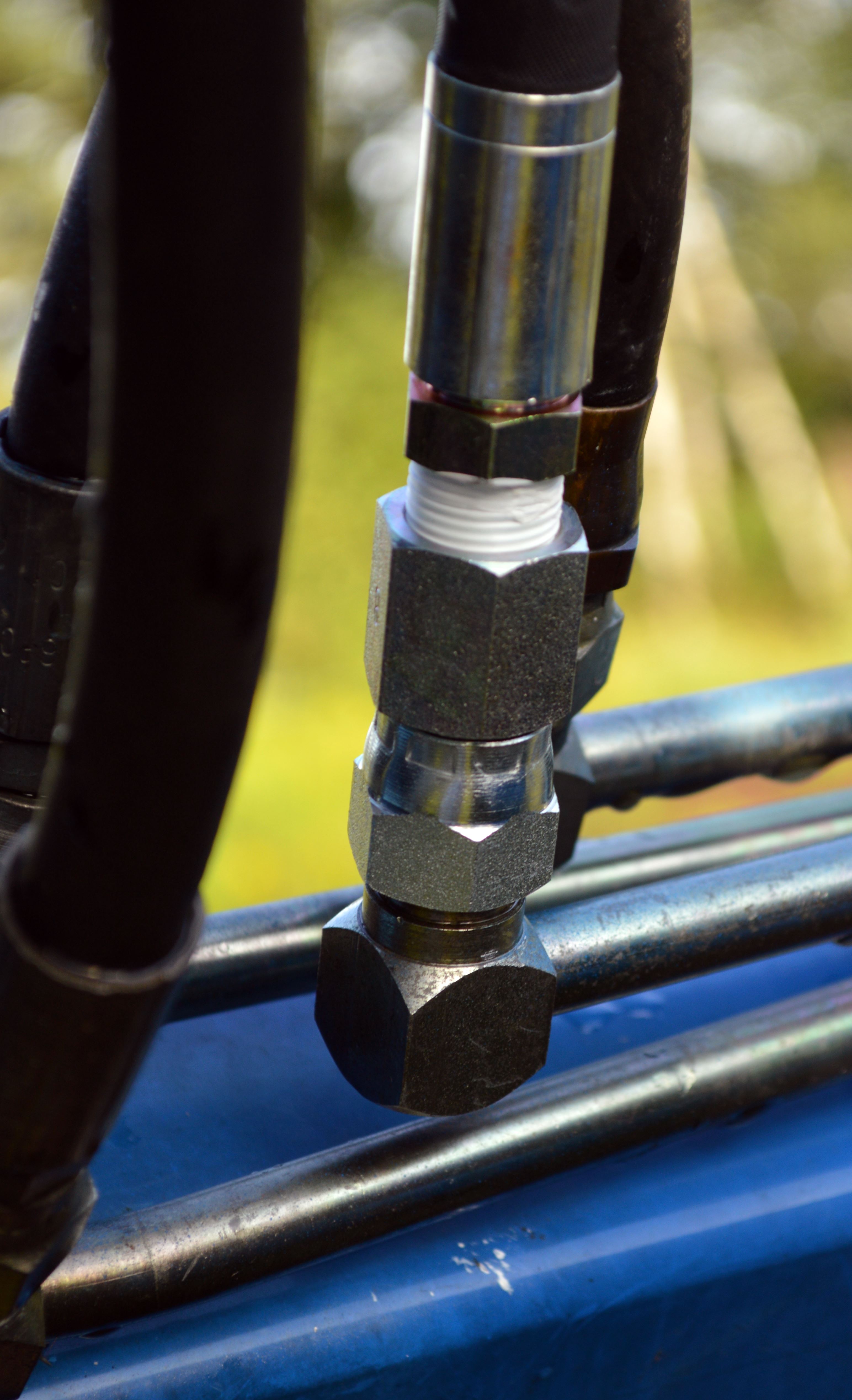

A replacement I did back in 2014. I used plain old PTFE teflon tape. I used 21/2 wraps and kept it back up from the first two threads on the male end of the hose, and I screwed on the adapter. Finger tight, grip tight (wrench), and then a little extra. I pulled the new leaky hose off and put this one on - no leaks.
The thread sealer paste did not work for me.
Been 3 years - all is good.
