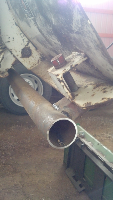

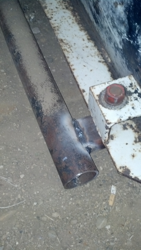

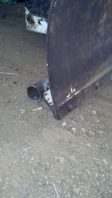

I put a slotted piece of 2" pipe on the cutting edge of my rear blade. It works very well. However, I drive the first snowfall into the gravel with my tires. The snow usually melts into the gravel, sort of leveling it out, then freezes. If the gravel is still soft I lengthen the top link to rock the blade back onto the skid shoes leaving about an inch gap. Once the gravel base is frozen solid I shorten the top link and run the pipe flat on the ground. Hardly no gravel in my lawn come spring.
   / How do I keep gravel out of my yard when plowing snow?? #62
This is what we came up with. Keeps the blade off of the gravel, but can be tipped forward the use the cutting edge.

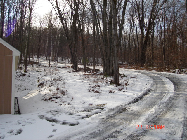

If I buy skid shoes for my blade will that fix my problem? Winter is just around the corner and I know I will be plowing my driveway unfortunately it is gravel and come spring I will spend hours trying to pick all the gravel out of my yard, I try not and drop the blade all the way down but my drive is not perfectly smooth so I have problems. Any ideas?
Pack the driveway with newly fallen snow and let about 1" of ice form over the gravel before you plow. In Eastern Ontario that ice pack will last all winter. Mind you, the underlying mud will be waiting for the unwary snow removal guy during spring breakup.
   / How do I keep gravel out of my yard when plowing snow?? #64
Ditto to the "leave the first couple of storms in place" school of thought.... I now have a paved driveway, but for the 20 or so years before that I would use wife's car, a 4WD Matrix with 50-series tires, or my old '72 Blazer, to drive back & forth, up & down, to pack down the first few storms. I usually ended up with a nice, solid base as a result, about 2-3 inches thick. I used to use a walk-behind blower, but now have my tractor with a front-mount blower.:thumbsup:
Yes, it did occasionally ice up; I just kept some sand in plastic bags on hand (still do!), and hand-spread when necessary. My drive is about 250 feet, uphill to the road, steep in parts, and on a north-facing slope. I know, not good planning, but it is what it is.
The solid base worked well for me to minimize rock-picking in the spring; not 100%, but tolerable, and far better than paying a local teenage hot rod to plow it with a pick-up truck! (Can you visualize "lawn sod furrow"?:laughing:)
When we do get icing of our south-facing hill on the driveway, we spread wood ash either mixed 50/50 with halide (rock salt) or by itself, and it really helps to keep the slipping and sliding to a minimum. They also seem to help bind the gravel tighter in the dirveway.
