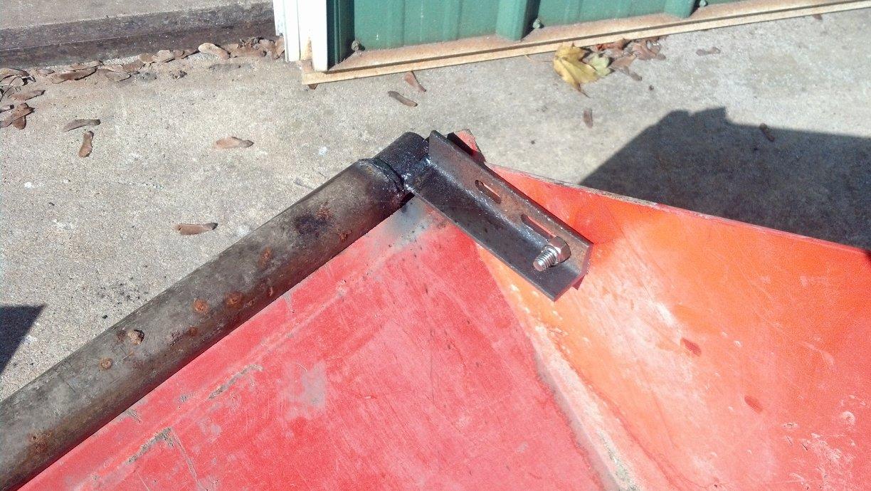

I used my Loader bucket with a pipe guard on the cutting edge. Didn't cost much to make and works well. Thought you might like to see some pics.
I like the hook on your bucket.
   / How do I keep gravel out of my yard when plowing snow?? #53
timster2 thanks. I was inspired to make that on TBN. I use it move my brush hog around. The hook lifts the top link pin, then I lift a little and bucket rests against the front of the brush hog. It really works great to move my Brush Hog around with the front loader in my garage. I've tried loader Forks, but this seems to be the best way to move it around.
Its nice to see someone actually build something based on a post I made a while back. When I saw the hook you made my day.:thumbsup:

Im hoping this will prevent at least a few stones from climbing into the bucket.
Its made up from scrap so its more functionstone guard.jpgstone guard 1.jpg than beauty.

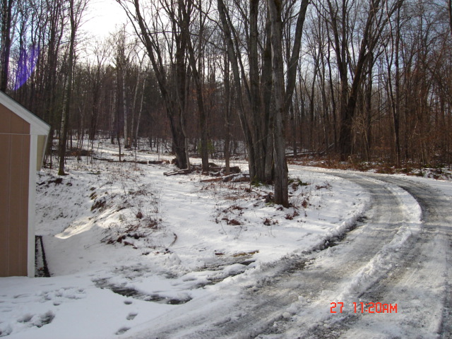

Ditto to the "leave the first couple of storms in place" school of thought.... I now have a paved driveway, but for the 20 or so years before that I would use wife's car, a 4WD Matrix with 50-series tires, or my old '72 Blazer, to drive back & forth, up & down, to pack down the first few storms. I usually ended up with a nice, solid base as a result, about 2-3 inches thick. I used to use a walk-behind blower, but now have my tractor with a front-mount blower.:thumbsup:
Yes, it did occasionally ice up; I just kept some sand in plastic bags on hand (still do!), and hand-spread when necessary. My drive is about 250 feet, uphill to the road, steep in parts, and on a north-facing slope. I know, not good planning, but it is what it is.
The solid base worked well for me to minimize rock-picking in the spring; not 100%, but tolerable, and far better than paying a local teenage hot rod to plow it with a pick-up truck! (Can you visualize "lawn sod furrow"?:laughing:)
