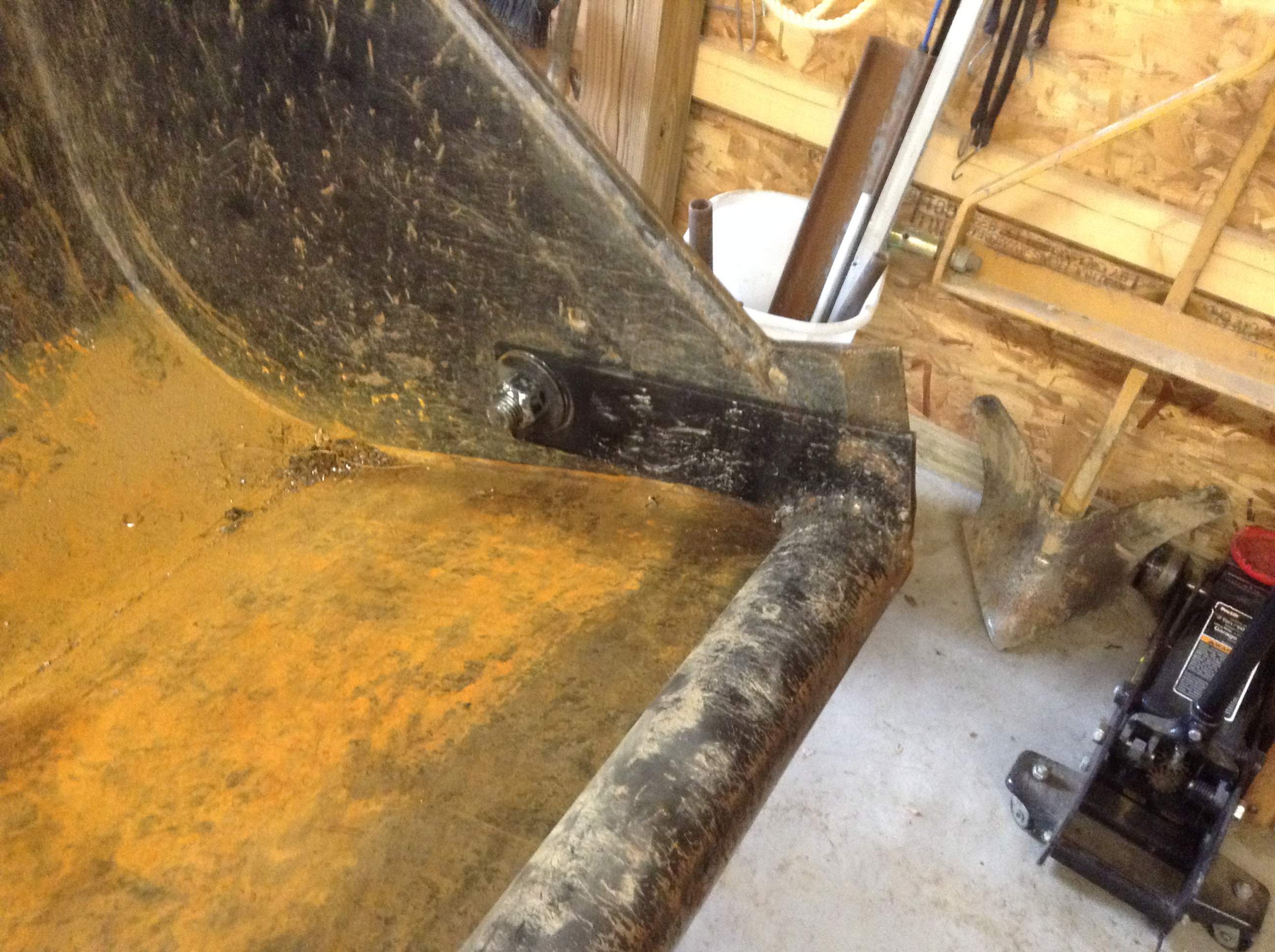

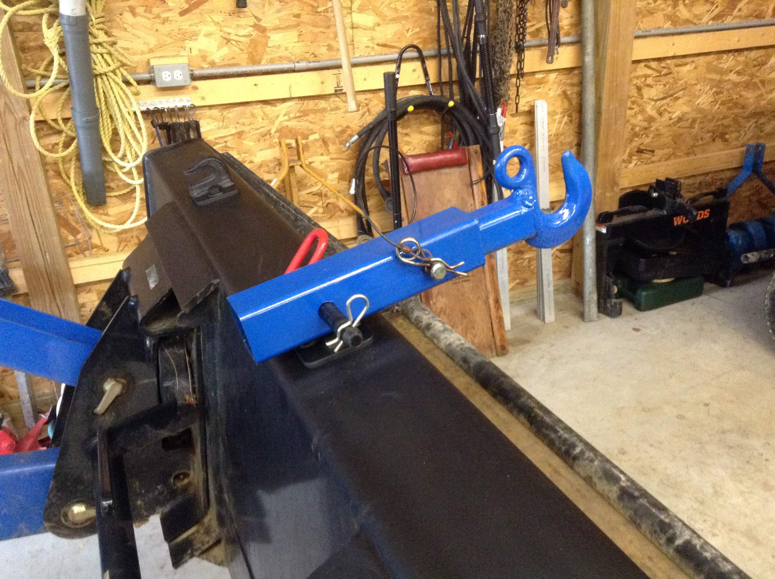

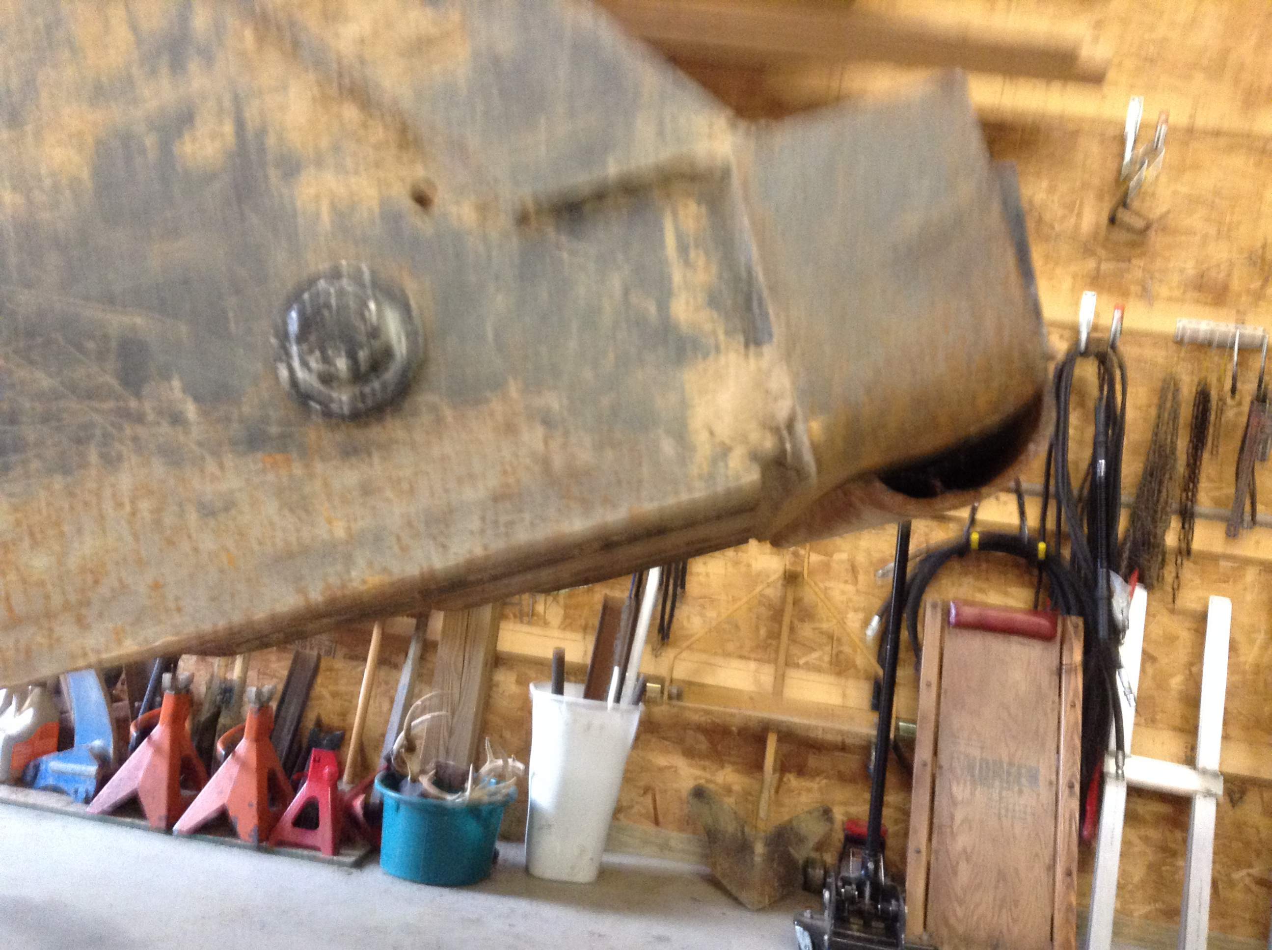

I used my Loader bucket with a pipe guard on the cutting edge. Didn't cost much to make and works well. Thought you might like to see some pics.

Thanks for the photos...very helpful. I like the manner by which you attached/welded the pipe using side bar stock and bolting to the side of the bucket as you can clear forward and back plow without having the pipe come off.

Thanks gaheadrick! Happy to hear the photos help. I wasn't sure how well it would hold up when I did it. Last winter was my Beta test. The pipe hangs on there nice and tight in both directions when plowing. Someone on TBN gave me the idea a couple years ago, so I used a 6 foot piece of pipe some 1/4" scrap pieces I had in the garage to make it. If you split the pipe in half with set of torches, the slot naturally opens up enough to slip it on the cutting edge. Then a couple taps with the small sledge and it fits like a glove.

Thanks six dogs. It works very well. as long as I keep the down pressure under control it floats really well over the gravel. It was very frustrating in the spring trying to get the gravel out of the grass before the last of the snow melts and the gravel drops. This tool has saved me hours and hours of raking gravel. It's fantastic after the ground get hard and frozen.
