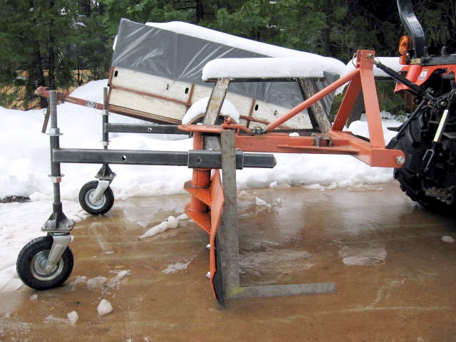

What with snow, plowing, and wildblue hassles I never got the chance today to experiment with lowering the top link connection....maybe this week end as well as trying a wider side arm stance. But I did take a few moments for more photos.
This is where I'd like to be the "happy medium" setting of the blade. Note the framing square showing the blade perpendicular to the ground (plumb). At this setting I have 2" threads showing on the top link.
At this top link setting (2" threads) I have 7" total lift.

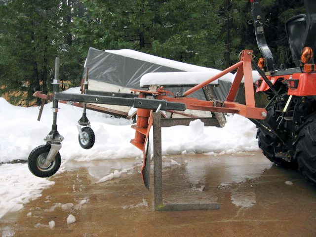

Here I have tightened up the top link, no threads showing. Note the out-of-perp blade. This blade is 2 1/2" out of plumb. Here the cutting edge is not cutting as well as the "happy Medium" setting
At this top link setting (no threads) I have 16 1/2" total lift.

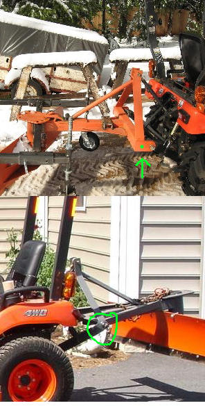

I have posted a picture of the differnce.
I added a green dot to your picture at the point the pins attach on SkunkWerx blade. You can see yours are mounted on those tabs or ears.
OK, Now I see! Absolutely correct, the blades have major different mountings! And here I thought I was always good at that "what's different in these two pictures" in the 5th grade!
I see this now as yet another spot to experiment with a different mounting of my blade. Since I can't get my lower pins to mount as ShunkWerX's because the tube is there, maybe if I extent the implement top link connection toward the tractor, putting it in vertical alignment with the lower pins, I'll have a similar configuration (and results).
Thanks for looking so closely and taking time to point it out so even I could understand. Crow tastes good sometimes!

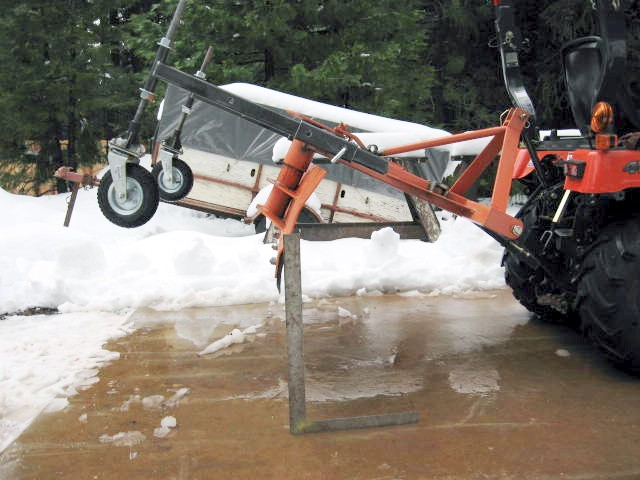

Good suggestion PILOON, Nothing beats a mock-up for understanding how variations in pivot points and attachment points can affect the geometry. I've resorted to mock-ups many times in the past and may well end up here too. While you were posting I was doing a couple of experiments.
Limited success! Not great yet but an improvement.
First I brought the implement top link pivot in line vertically above the implement lower link pins. They were offset 3 1/4"! This is the adjustment Mundy pointed out. With top link adjusted so blade edges were still plumb this increased my lift height 1 1/2", now 8 1/2 total above ground.
Then, including the above adjustment, I shifted the side link pins to point outward. This in effect moves the implement closer to the tractor. I needed to adjust the top link to zero threads showing and still could not get the blade edges quite plumb but this adjustment bought another 2" of lift, now for a total of 10 1/2" above ground.
I'm not there yet but progress in the right direction is promising. I'm thinking that adding a Carter type quick connect, which in effect lowers the side links, while all else remains the same, I may gain some top link adjustment length and also raise the blade a couple/few more inches. The good news was that neither of the experiments substantially changed the blade in the "working" position so my other accessories will likely still function as designed.
