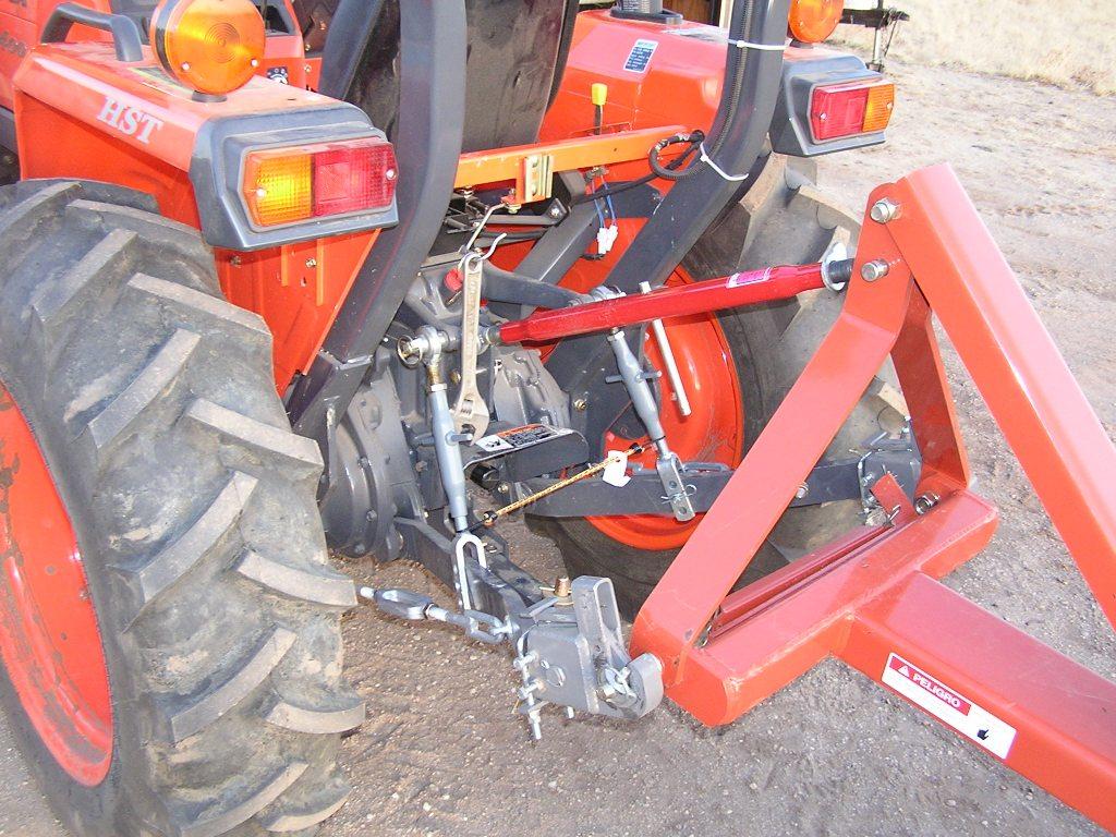

My new lifting links showed up. This was quick. I ordered them on Monday and they are here on Thursday. They look nice. They will shorten the lifting arm by 5-6 inches which will really raise the blade.:)
The don't fit.:mad:
The forked end is too skinny. It is 13/16 wide and I need 1 inch. If 13/16 will work for you then go for it. The ball end worked fine.
I will be calling them tomorrow to see what we can do.

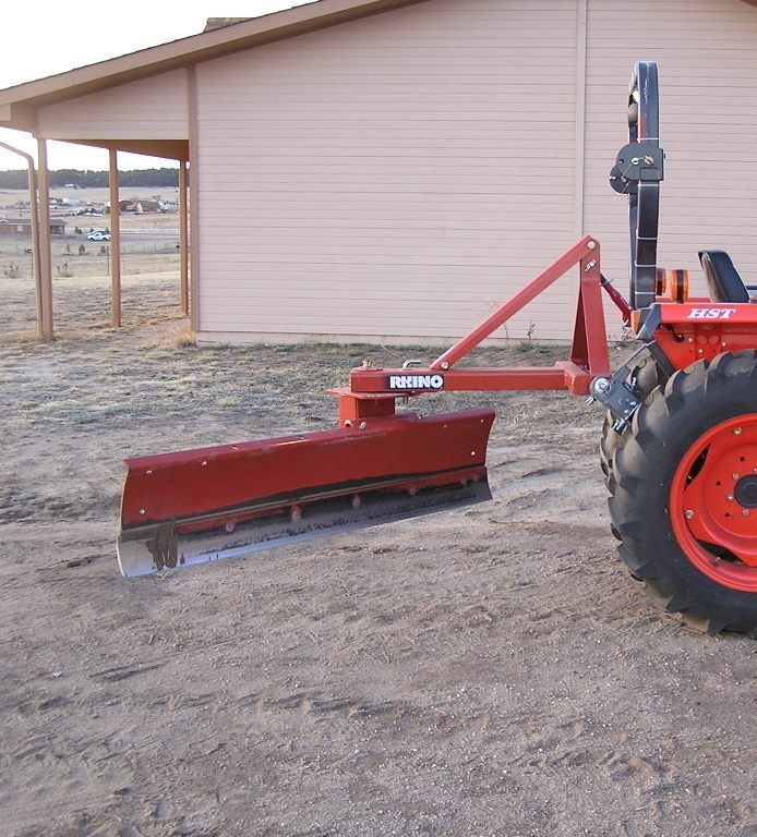

Time for an update. I machined the fork end so it will fit over the lifting arms. Very successful. :)
Here are a couple of pictures. The blade is about 2 feet off of the ground.

Here is another picture. The new photo system only uploaded one picture.

Great work Stan.
I'll bet that makes you happy.
BTW, you clickable thumbnails don't open up in a separate window automatically like a Photobucket account. I see you are doing it our of a TBN. I didn't know you could do that.
