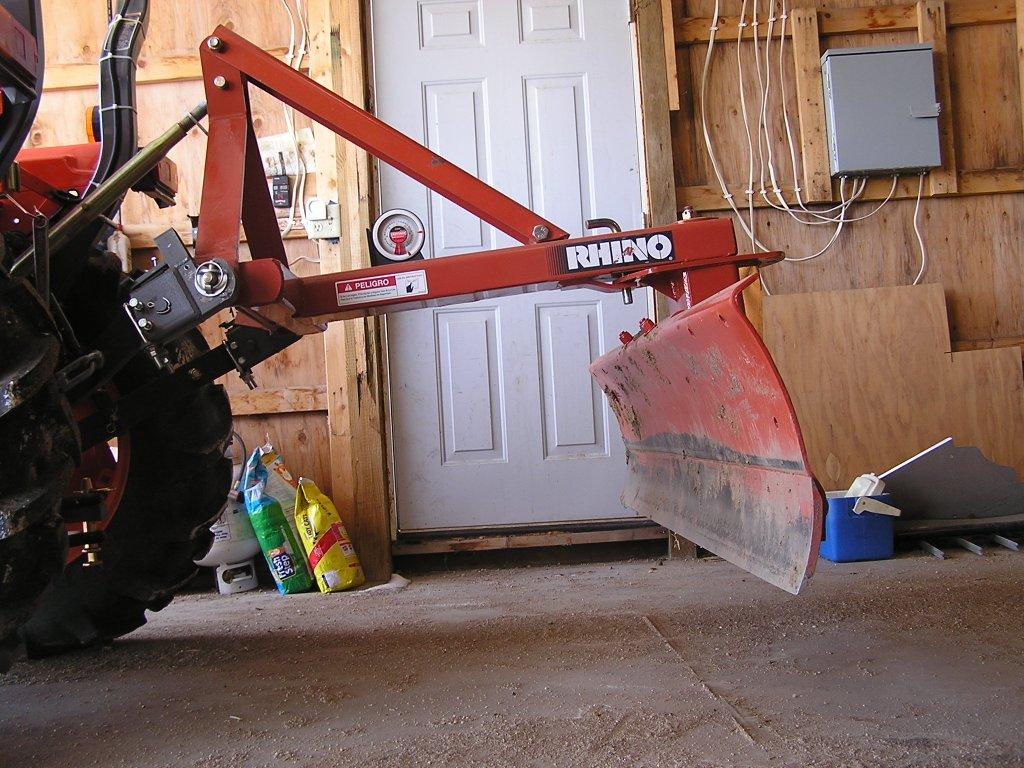

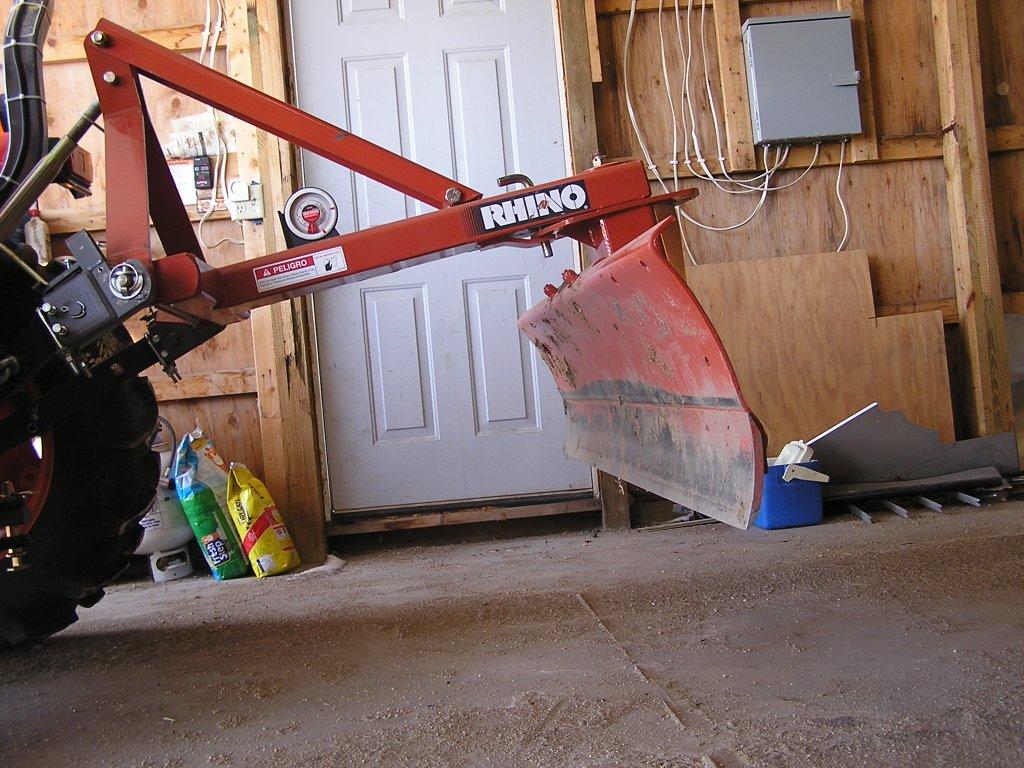

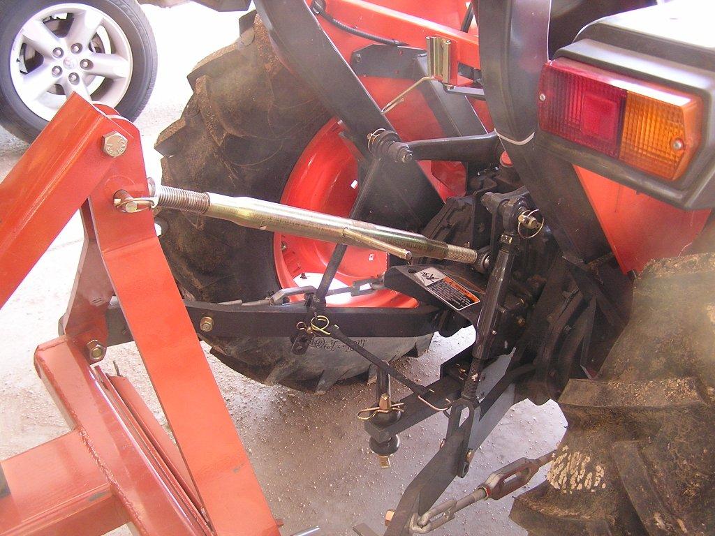

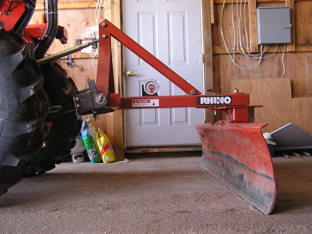

Red,

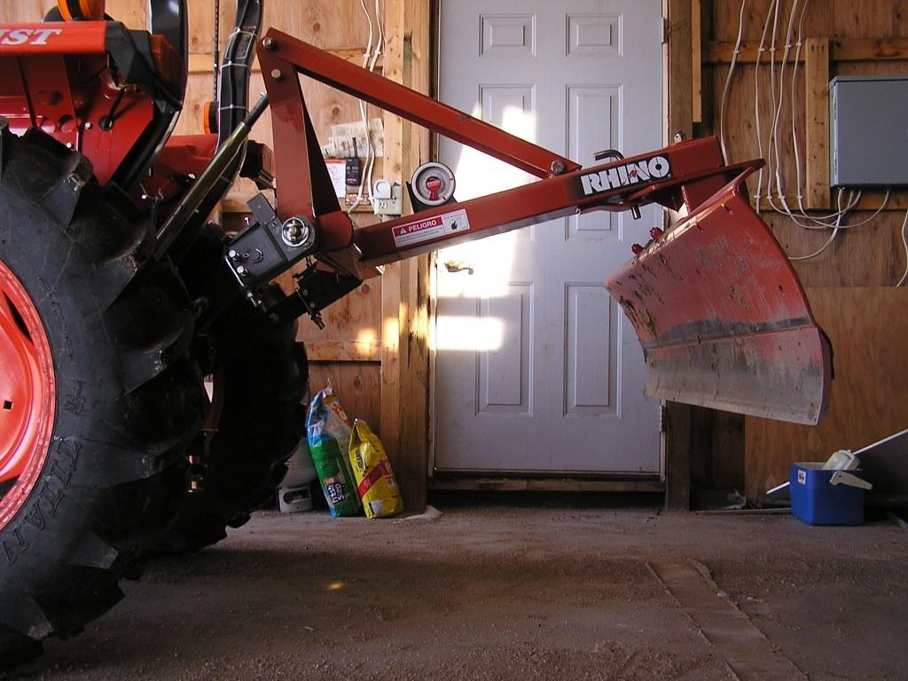

I did some testing this weekend and here are the results.
You had worked with the location where the top link attaches to the tractor. So did I. I started with the blade level (square) and the top link in the upper hole on the tractor. (1st picture)
I raised the blade and it came up 11 inches. (pictures 2 and 3)
I then put the top link in the lower hole and kept the blade level. It raised 13 3/4 inches. Gained 2 3/4 inches. (pictures 4 and 5)
RedDirt said:
But I think the links would be lengthened not shortened. You want your side arms lower to the ground in the working position so there is more lift height available.
The lower arms will be at the same angle for a given blade cutting angle and blade depth. Shortening the lifting links will lower the arms attached to the 3ph cylinder giving more upward travel.
My lifting links came with 2 height adjustment holes where they attach to the lower arms. I added a 3rd on the fixed lenght arm and adjusted the other to match. :) This combo raised the blade 20 iches. :D (pictures 6 and 7)
A word of caution though. The left hand linkage is starting to bind in the down position. :(

   / How do I raise the 3ph higher? #35
bx23barry said:
You could also drill new holes in the lower 3pt arms closer to the tractor. That seems to be the way to go on the bx.
Another pending experiment! Barry, have you done this on your tractor?
Racer,
Your tractor has many more adjustment options than the bx. We have only one pivot point choice for the top link at the tractor. I was experimenting moving the top link pivot point on the implement, not the tractor. And the bx lift arms/side links have only one connection point. Seeing your variety of hook-up options confirms there are many ways to arrive at an equitable solution.
If bxBarry's method works (for me) it may be the easiest solution of the ones investigated thus far.
   / How do I raise the 3ph higher? #36
RedDirt,
Mundy's picture was a good one, showing the different connection points, but, I do not believe the lower link connection is the cause.
Racers point is well taken. you could even rig up a scrap block of wood, place it behind your A-frame on your blade, connect your toplink and move it up and down with C-clamps to find the sweet spot.

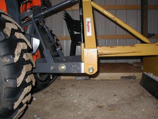

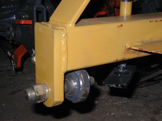

   / How do I raise the 3ph higher? #37
This is what I did with my 5' king cutter, cut off mounts with sawsall and weld back on pointing down, made a huge difference.

   / How do I raise the 3ph higher? #39
I've been gone a bit too.
Tim, Your solution was my first idea but my top of blade is only 1 3/4" below the "pulling arm". If I rotate the lower mounting flanges downward then I don't think I'll be able to rotate the blade 360 degrees because the blade would hit the turned down mounting flanges. From what I see in your photos my blade looks exactly the same. Are you still able to rotate 360 after you turned your side link mounts? I may need to resort to the Carter type quick connect to achieve this type of adjustment and still preserve the 360 rotation.
Skunk, I did try clamping a pivot point for the top link onto the a frame but I put the "new" pivot forward so that it aligned with the side link pins. See my earlier post, I gained a bit of elevation by doing this, but not substantial. Shifting the side link pins to point outward helped more but makes the implement much more difficult to hook up.
I know what you mean by my blade is built for a "taller " tractor. That, I'm sure, is the root of the problem. I'm going to price out a adjustable side link and try that on the left side (adjustable links on each side) if it is not too expensive. Or build a solid, but shorter, side link. I may also try boring new side link pivot holes in the lower arms as suggested by bx23barry.
