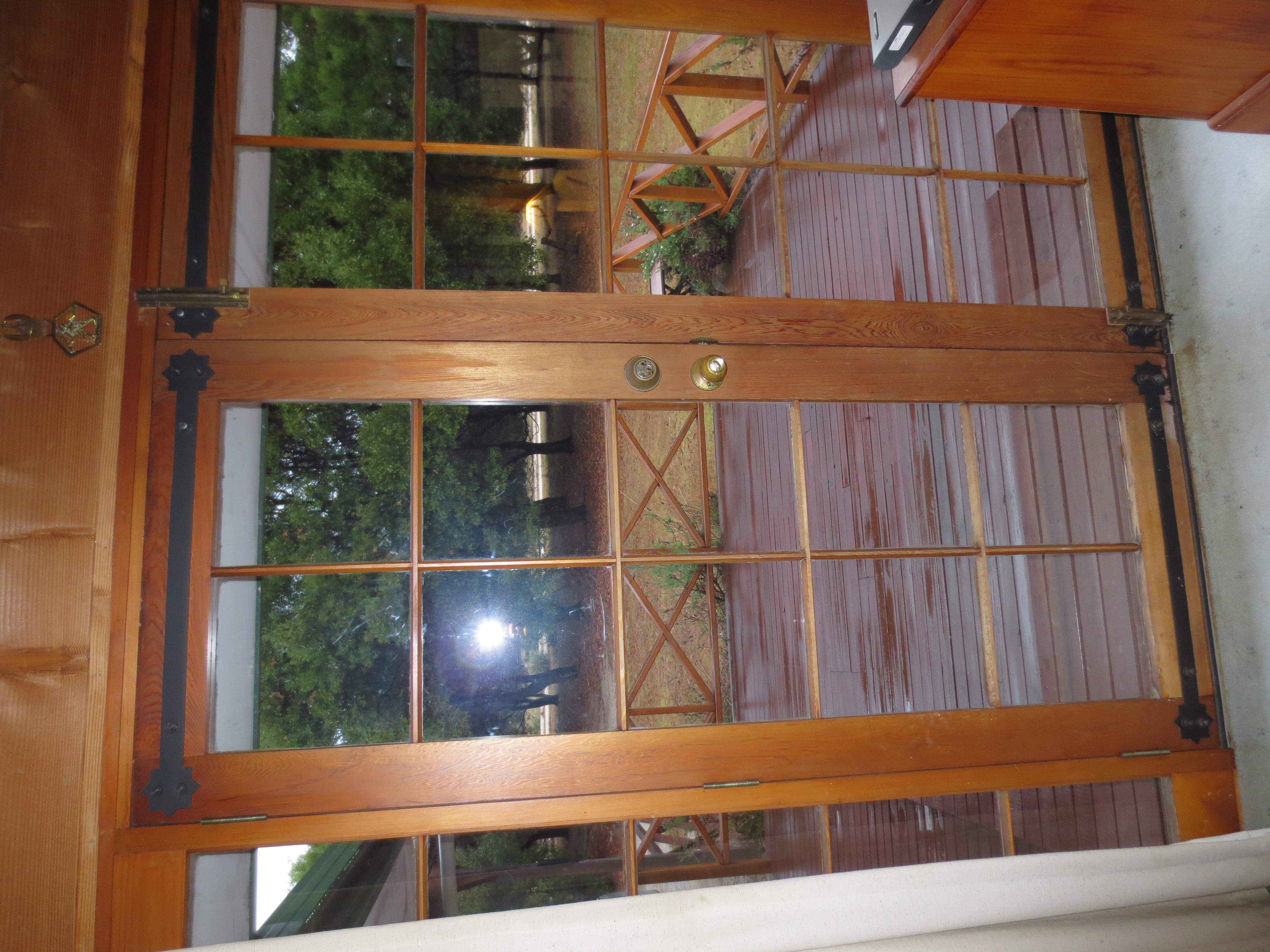

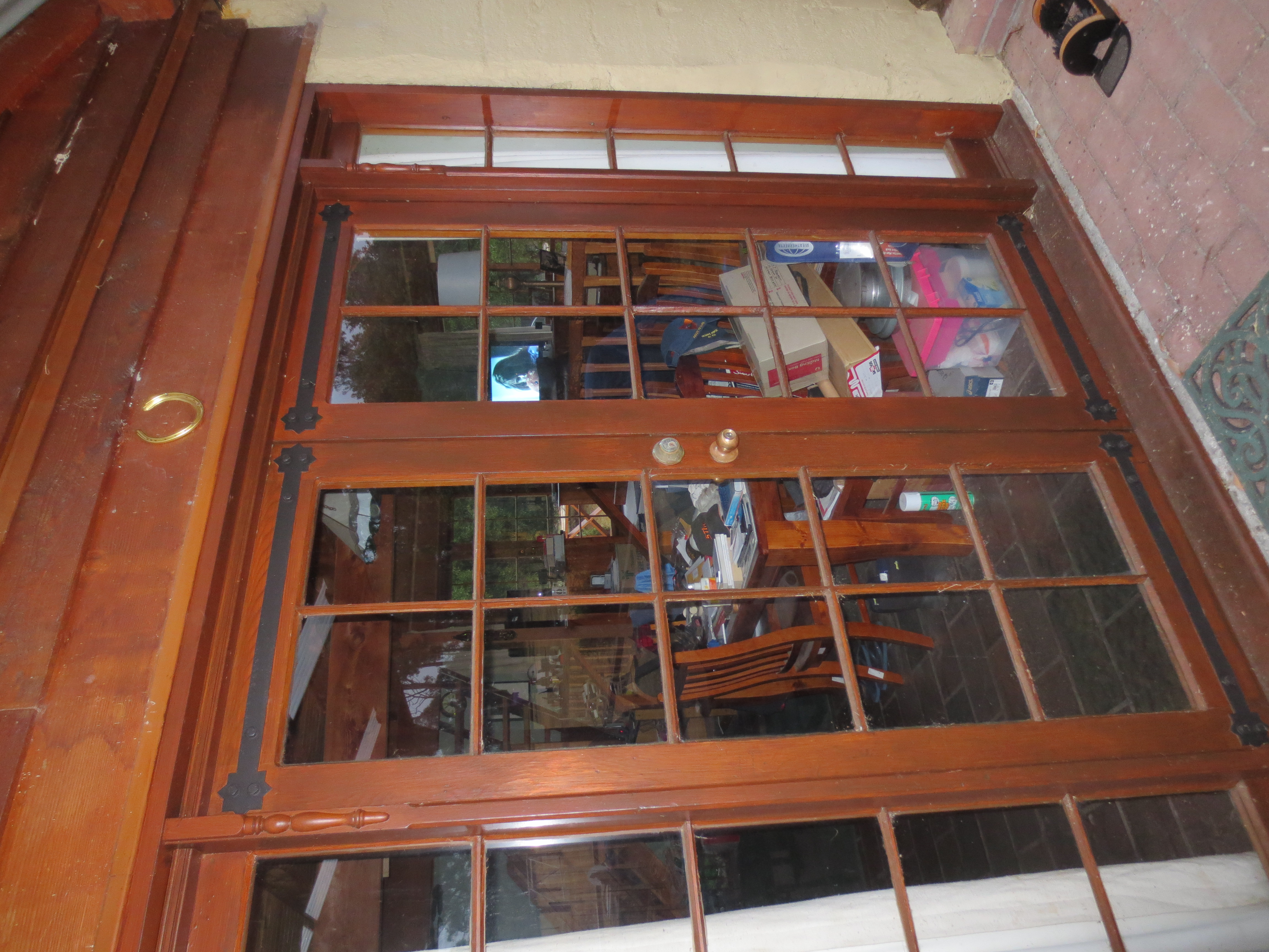

Lord what a pain in the arse! I figured out how to upload the pictures from the camera but it used to do it 'automatically'. Arrgg!
O course the photos are sideways!!! Mind you, that's how I took'em so that you could see the top & bottom of the doors. The first is an outside shot, second is inside. No 'warping' in the 12 years since I had it done. Oh, and thy're simply painted flat black to look like wrought iron.

The pics are right side up even though you are upside down. :D. Looks good!
