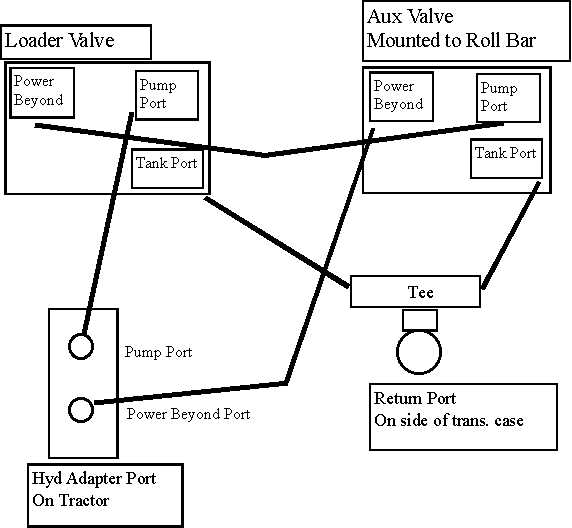

Junkman, You own a Kubota so why use a closed center valve on an open center system? Checkout the attachment for how two open center valves should plumbed.

That is exactly how my auxiliary valve is plumbed and mounted on my ROPS. /forums/images/graemlins/grin.gif

<font color="blue"> Junkman, You own a Kubota so why use a closed center valve on an open center system? Checkout the attachment for how two open center valves should plumbed.
</font>
That's what was supplied to Junk as part of his grapple package if I'm not mistaken.

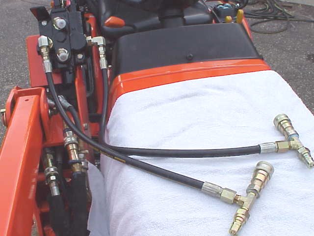

Junk I lightened your picture and I'm only seeing two hoses off your valve are you sure that you are connected the same as the diagram?
   / How do you adjust a hydraulic valve? #40
It might have just two hoses off of the last valve in the group. There is only two hoses needed for the last valve in a open center system, a PBY is not required.
