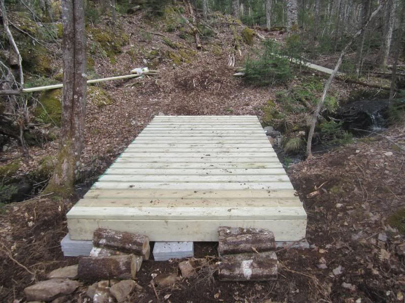

I'm in the same boat, but I want it to drive my Jeep over. My stream's about 4-5' wide and shallow. I asked my engineer buddy and he said 4-2X8 per beam would support the Jeep. I'll put 2 in the center to keep the bounce out of the decking when walking or passing with the 4-wheeler. So it'll be 10X14', with three beams, and 2x4 decking.
Since the cost is close to the same I would use wider deck boards such as 2x8 instead of 2x4.

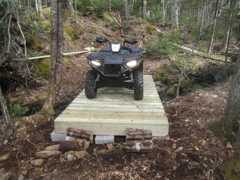

...oh, and the Jeep's sold, so this is only for the wheeler so it got scaled down. 6' wide, 12' long.
