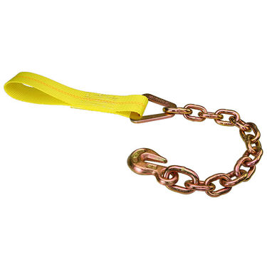

Is the short end stitched to the ratchet handle? The 2" straps that we have all use a bolt to connect the short end to the ratchet.
Aaron Z
29030-2-x2-fixed-end-w-chain-extension-and-bolt-loop_1_375.jpg 12.99 Maybe this will work

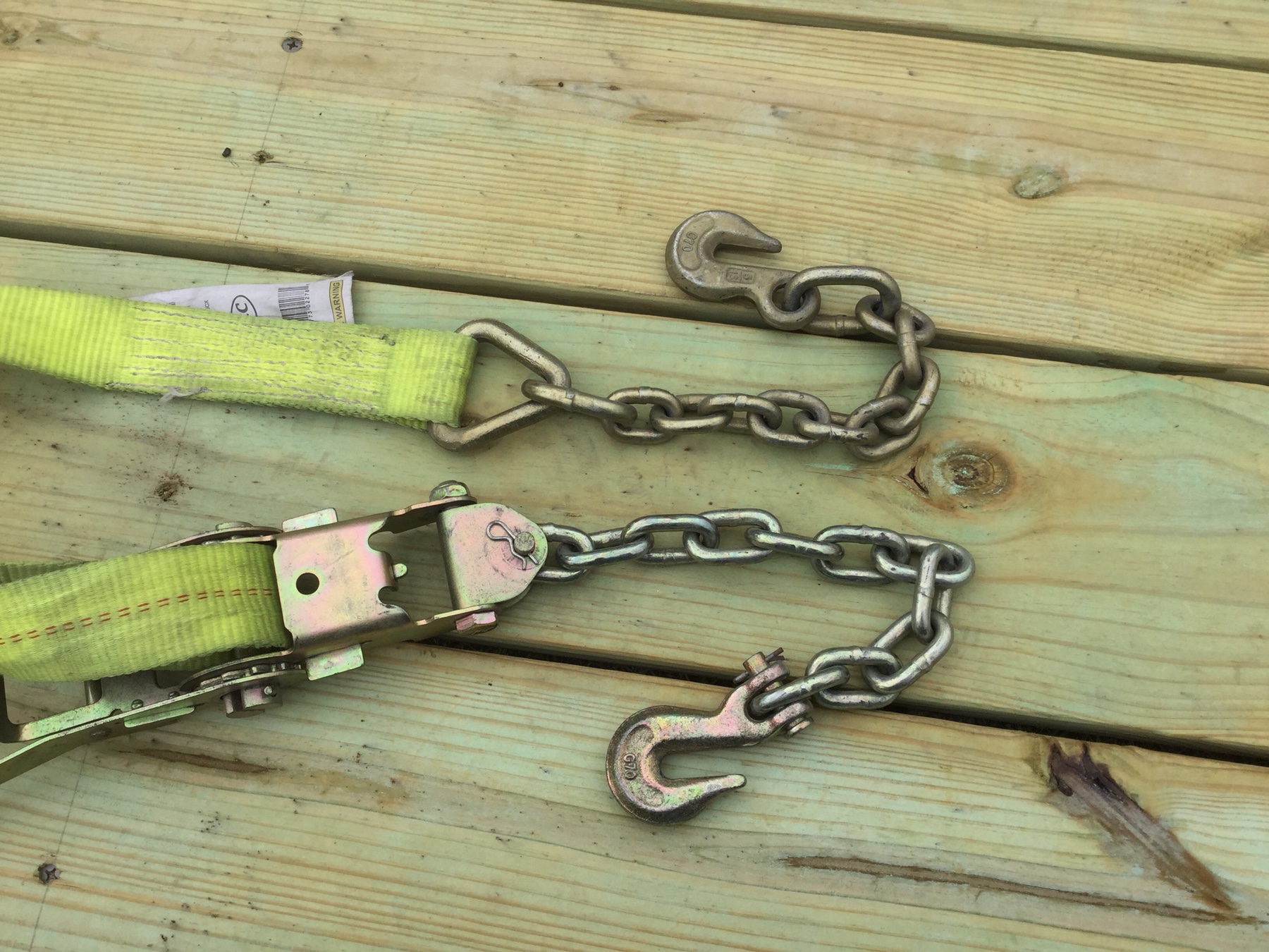

My 2” ratchet straps have no “straps” on ratchet end. They have 16” chain connected to ratchet with a removable pin.
