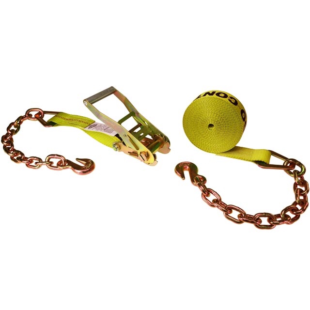

I use ratchet straps that have chain ends on them for aux. equipment securement.
Use them to secure our John Deere Zero Turn on trailer as well.
I have seen those and they look appealing, but how does the strap hold up? Sometimes my strap goes across equipment and while it's not a sharp edge ,cwill damage the strap. Then I'm out the $$.

I have some old straps with high quality ratchet handles but bad webbing. How do I get new webbing installed on these? Seems like you would need a heck of a sewing machine. Who fixes these?

You don't 'fix' them, you replace them and use the old webbing for protection from sharp edges.

I agree. No fixing the straps. Get some good straps, heavy enough for your intended use. As noted above, my go to straps are 2” with chain ends. The chains / hooks prevent abrasion of straps where you tie down.
I buy some canvas strap protectors that go over straps and slide to any area where your strap crosses a sharp edge. Guess you could use sections of inner tube but these protectors work well and not expensive.

Wow, I did not know about strap protectors and will get some. Great idea.
It's not that I want to fix straps but I have some older ratchet handles that are super heavy duty and in perfect condition, far better than anything today. I just figured I could re-web and have a much better product? Yes? No?

Doubtful.
