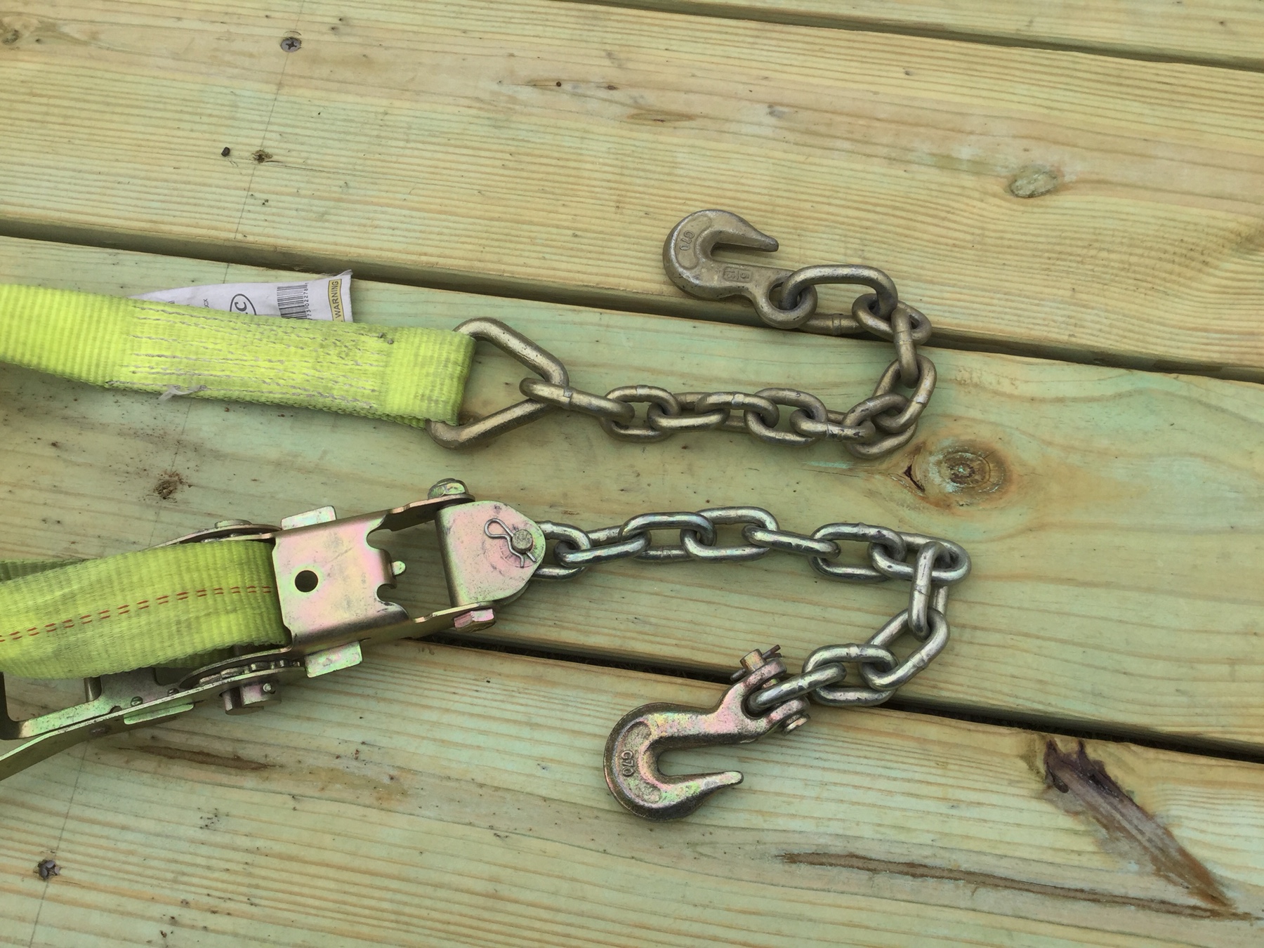

Nope. Remember that the long strap has hook on one end and other end just gets threaded thru the ratchet drum.
Yes, but hooks are stitched on both ends. One is on the long end as you mention. There is also the ratchet piece that has a short strap with one end stitched to the ratchet handle and the other to a hook. So to replace the strap portion, I need someone that does this before, knows what they are doing and has the ability to stitch double thicknesses of heavy strapping. Apparently, no on does this so I may have to just toss my metal ratchet ends and buy new straps.
As mentioned, the metal ratchet handle ends I have now are super heavy duty and I've had them for years. They have never been in the weather and are perfect. They would hold the Queen Mary in place and must have been used for some Herculean task. As well, the hook ends are longer and heavier than normal. The strap was so tough it's lasted for 25 years of intermittent use and I'd hate to give up without a fight.
   / How do you chain down your 50 HP tractor for transport? #102
the tow strap has hooks already stitched on BOTH ends. cut it to length feed it through the ratchet. on the other end you will need to get it stitched IF you want webbing on that end or you can weld a hook to that side or use chain with a hook. we have several where we welded a hook to a bushing/sleeve that is the bolted to the end of the ratchet where the shorter strap would be. there is also a local sailmaker who has stitched some for us

If you are anywhere near a big city there should be rigging shop. They sew lifting slings of any size and should be able to fix you up.
Is the short end stitched to the ratchet handle? The 2" straps that we have all use a bolt to connect the short end to the ratchet.
Aaron Z
   / How do you chain down your 50 HP tractor for transport? #106
Aaron Z

I have to look to see how they are stitched and they are in the distant barn so give a while to go there. A canvas, sail or rigging shop is the answer. Thank you.

Just put on a bit of chain for the short end, instead of a strap.
Bruce
   / How do you chain down your 50 HP tractor for transport? #110
My 2” ratchet straps have no “straps” on ratchet end. They have 16” chain connected to ratchet with a removable pin.

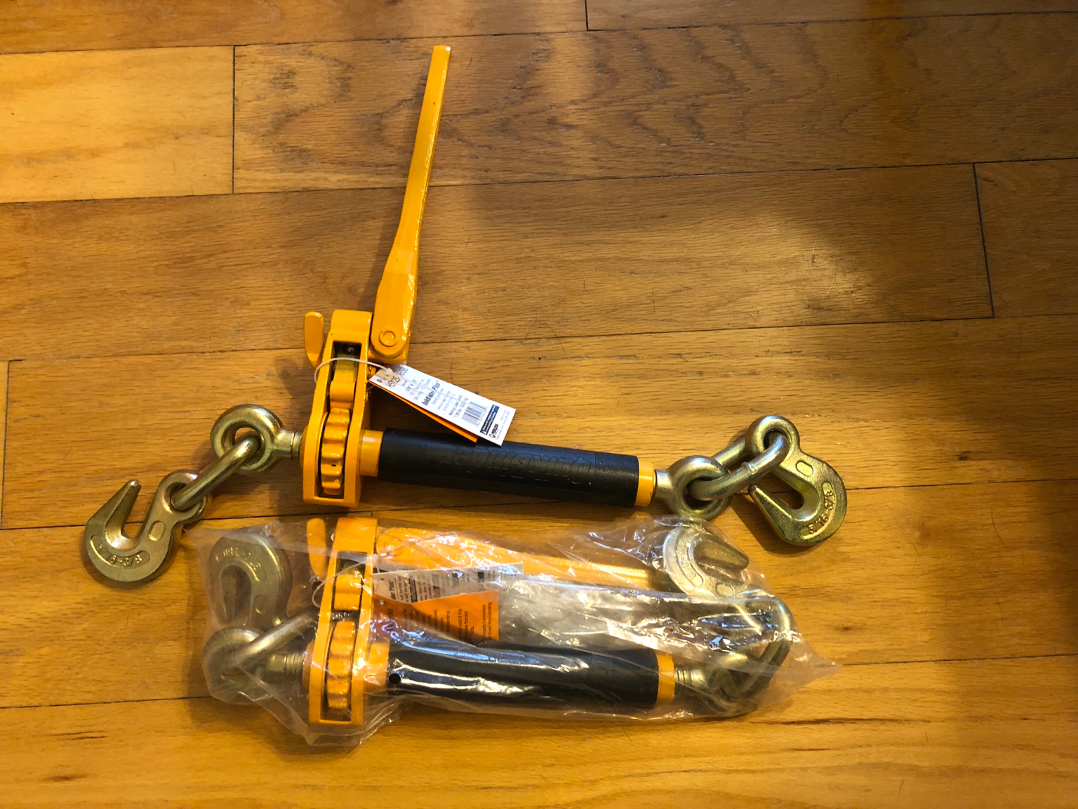

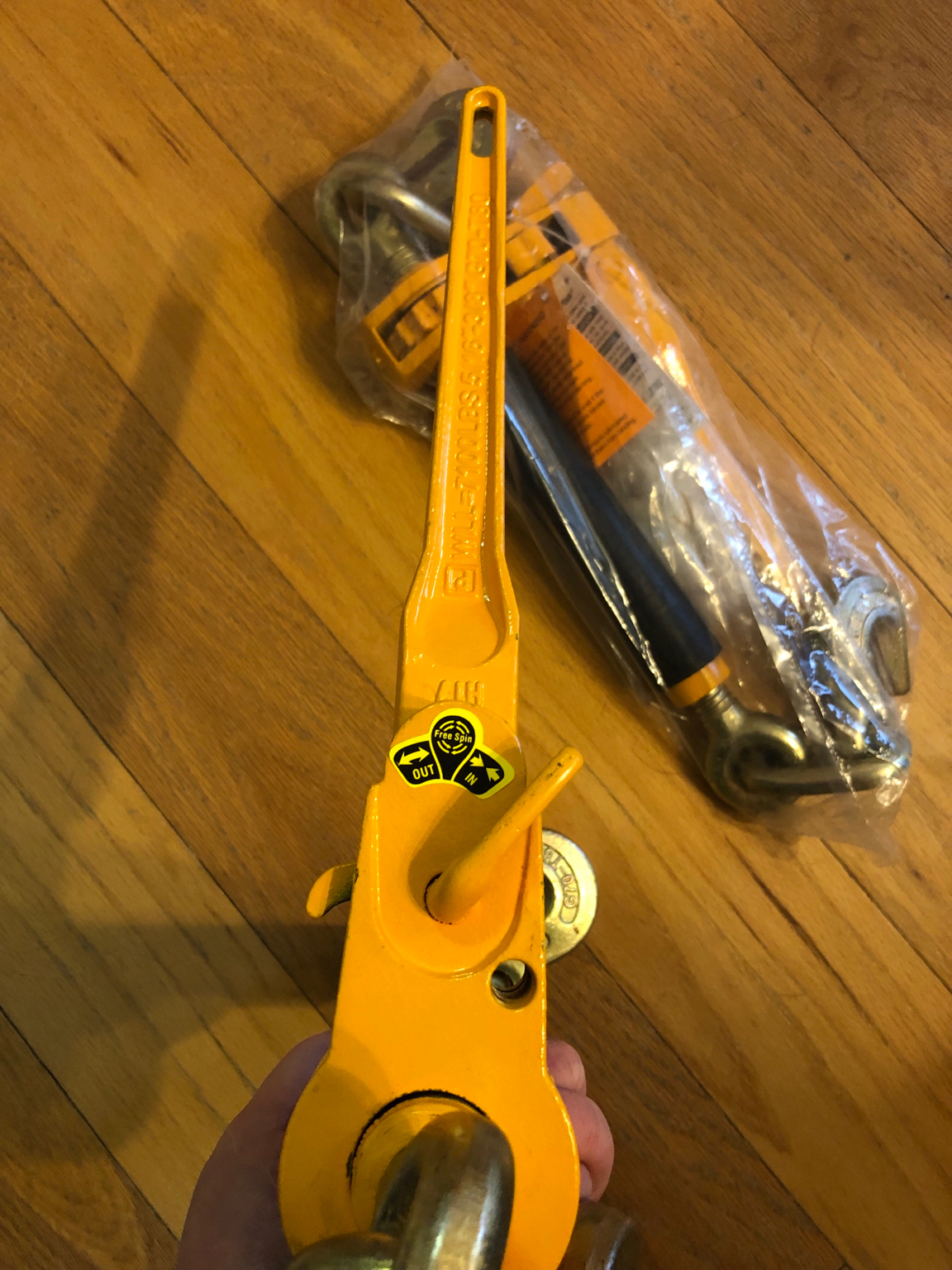

More goodies showed up today, these things are sweet, I really like the rubbery grab handle to bypass the handle but still ratchet to quickly tighten slack. Will work great.
I can put it in free spin and very quickly spin the rubber part to clear slack. I can see if you had a lot to work these would save a ton of time.

View attachment 532117View attachment 532121
What was the price of those?

sixdogs, if the short end is attached with a bolt, you can buy replacement short ends for Truck n Tow. They make their own straps right here in Detroit. I have several of them and they are all quality items.
Short End Replacement Straps w/ Chain Anchors - Ratchet Strap Components - Cargo Control
I have towed for years but only with straps--no chain ends-- and am amazed I can buy replacements like this. Duh, I had no idea. Can you buy long ends with chains on or is it them time to buy a whole hew assy?
