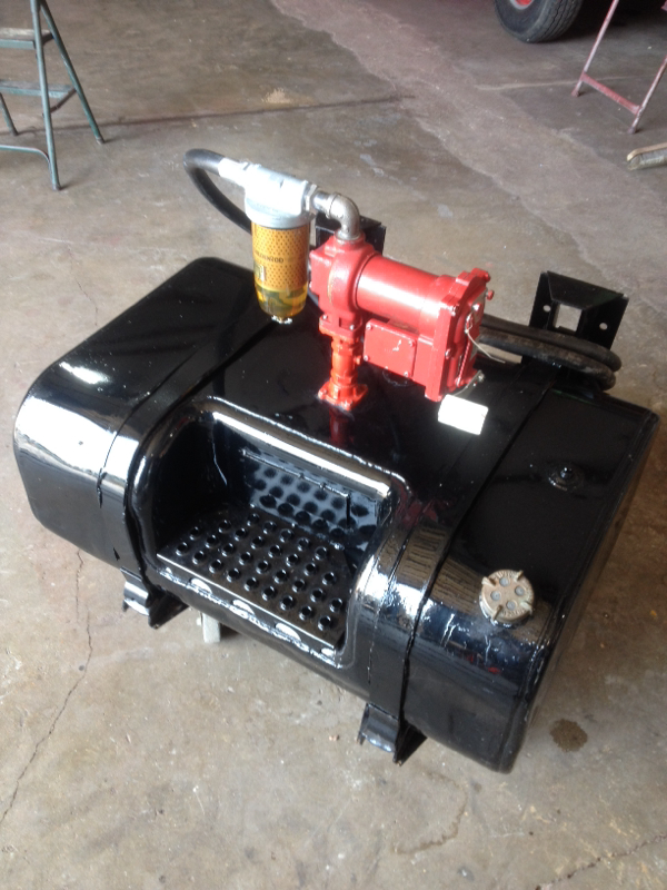

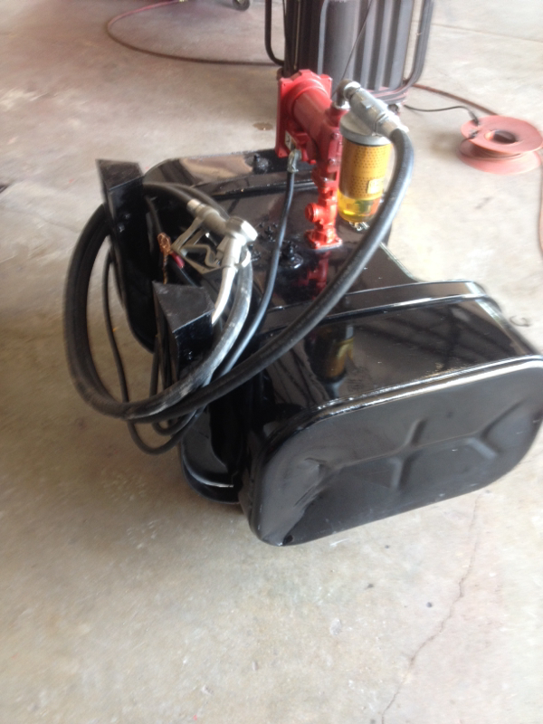

I took a 50 gallon rectangular fuel tank from a bob truck, mounted a 12 volt fill-rite pump to it I bought at a farm sale for 20 bucks. I left the tank mounted to the frame holder that came off the truck, that allows me to use my forks to load and unload the tank from a truck bed or trailer ect. I keep it setting on a furniture dolly in the shop and just roll it over to the tractor when needed.
Finally remembered to get a couple pics
