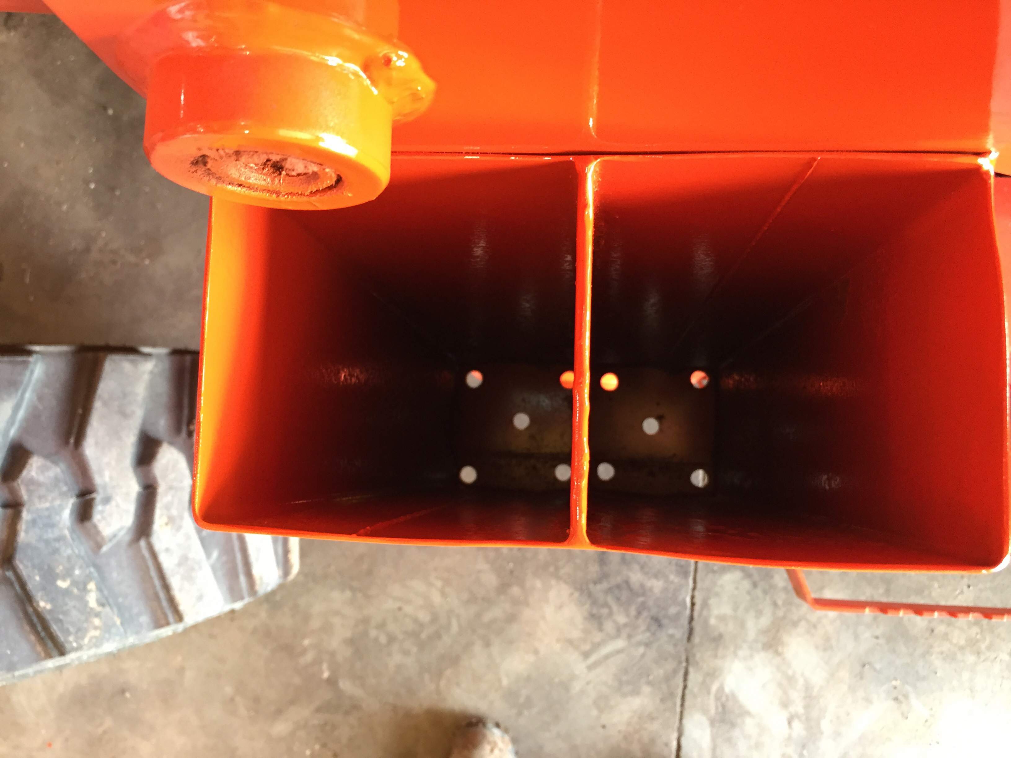

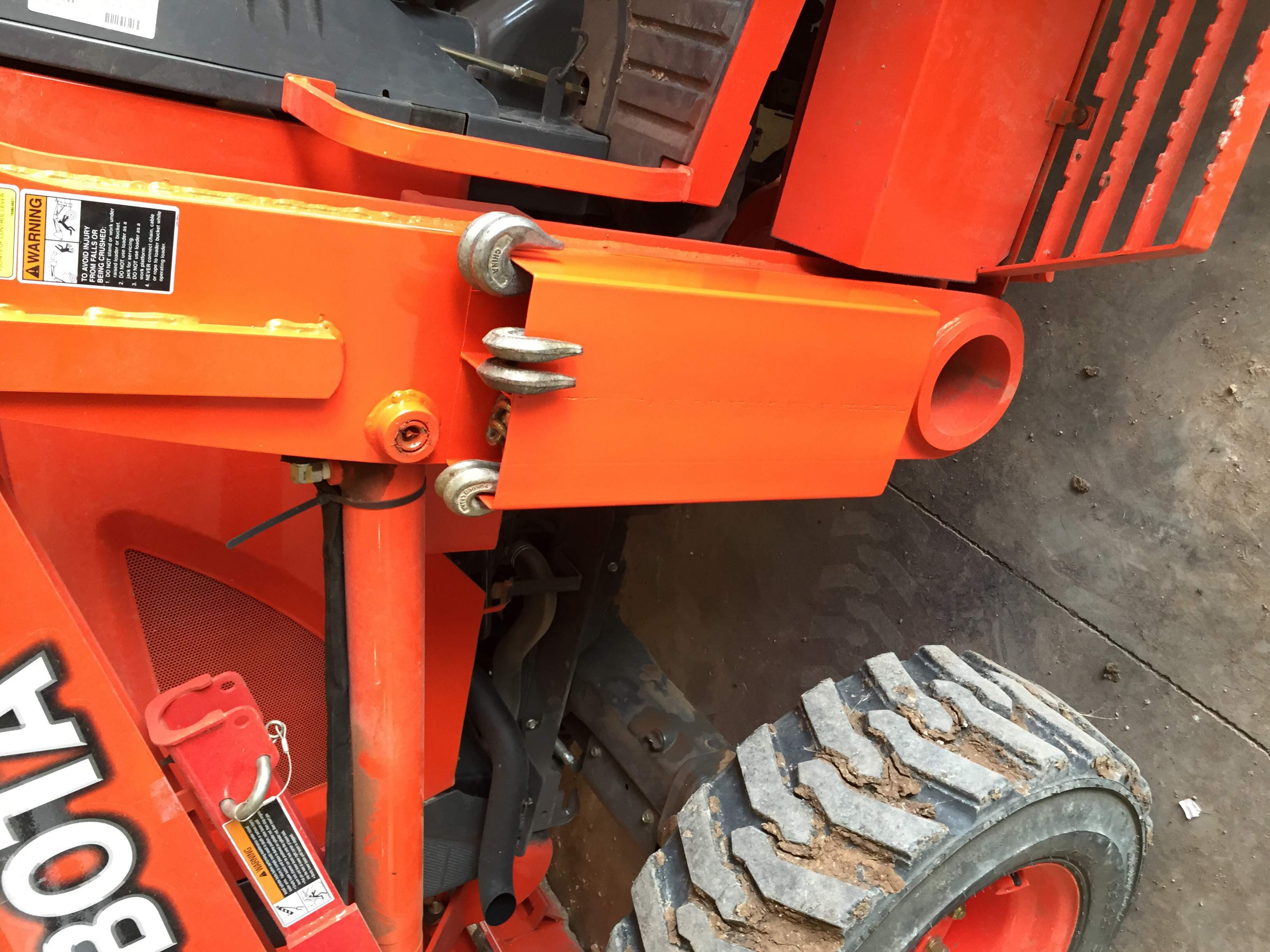

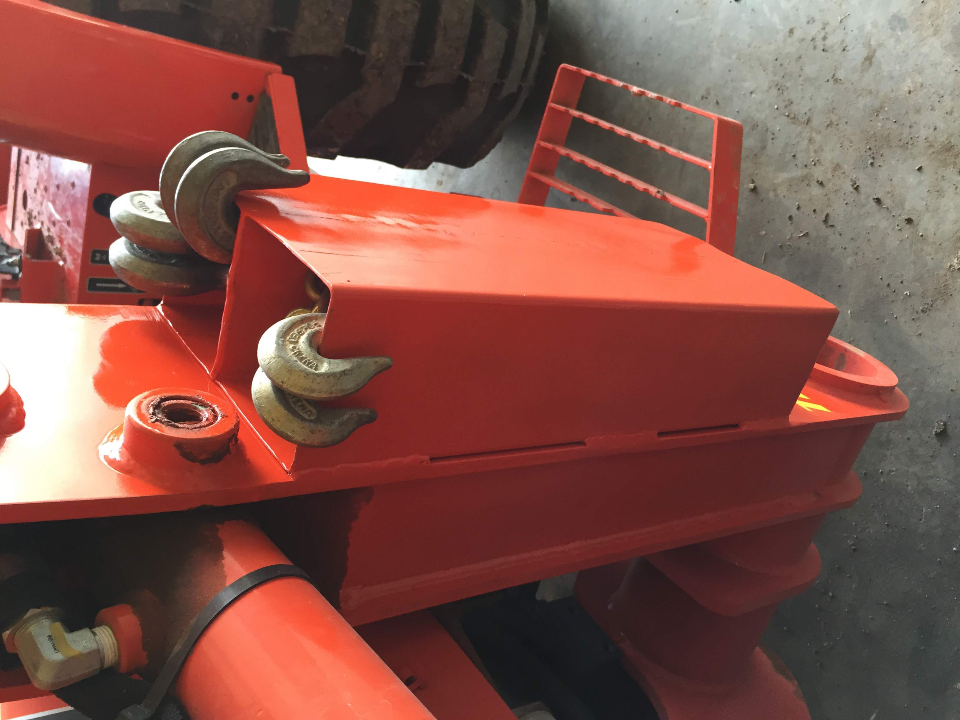

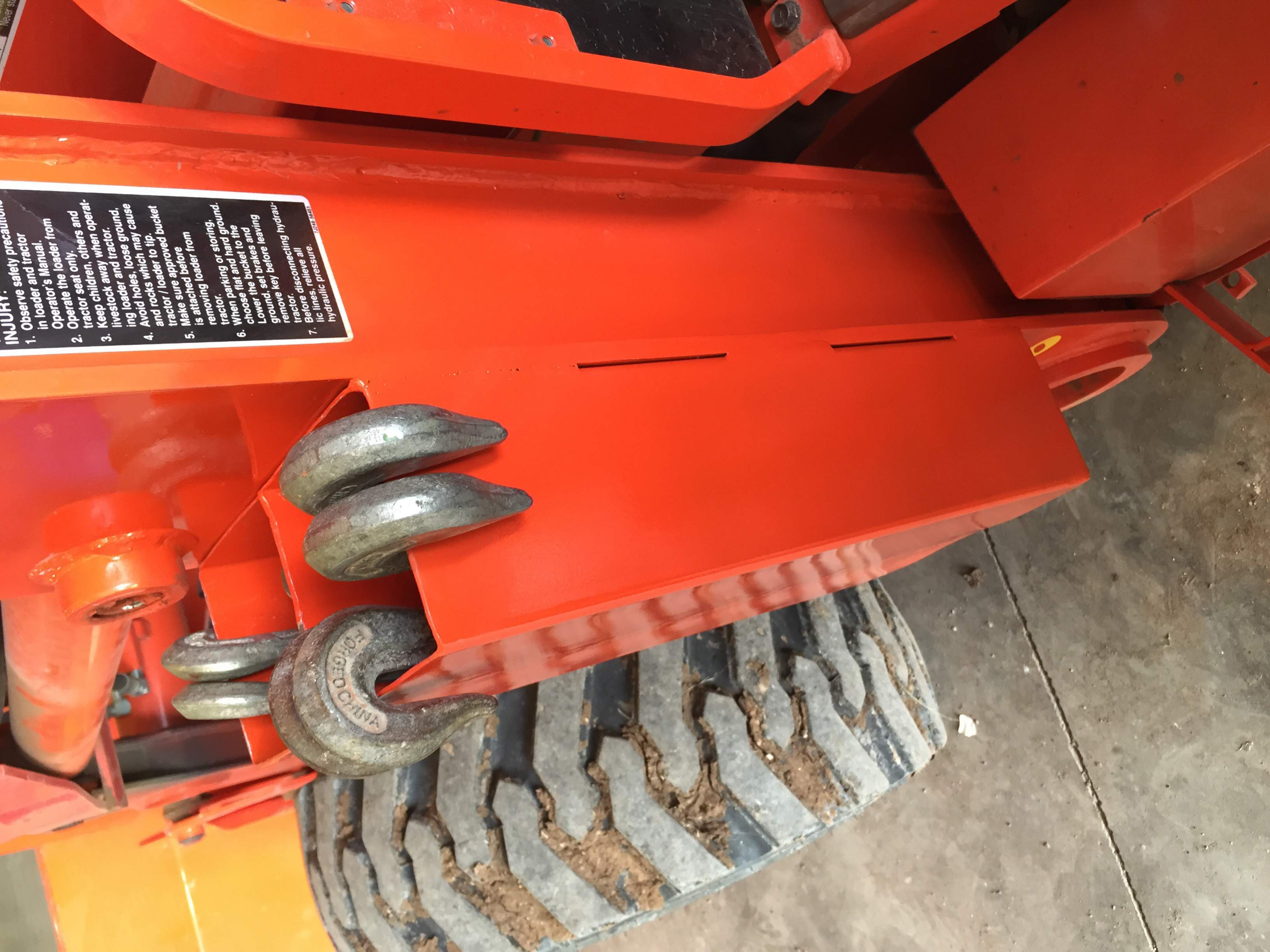

Well today I built my chain holder. Two 4" square tubes 18" long welded together. I think they were 14ga. I welded a cap across the bottom and drilled 5 holes in each side for drainage. I am pleased with it. The front tube has a 20' 5/16" chain and is full and the back tube has two 5/16" chains about 8-10' long and is also full. I mounted them on to the side of my loader with six small welds.
awesome! Exactly what I want to do!
   / How do you store you logging/tow chain? #259
Bdog, looks like a factory upgrade. Very nice.
   / How do you store you logging/tow chain? #260
You did good. Very nice looking, and very functional.
