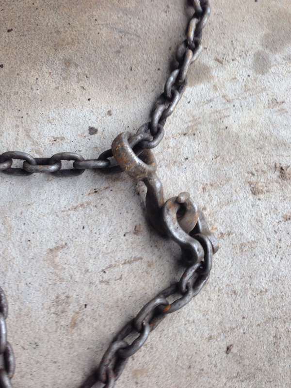

Speaking of chains,
I wanted to show off what I found at my local scrap iron place. At 20 cents a pound I got for less than $10. So I think I stole it. It has a metal tag on it that I can't read. I guess it belonged to a crane company or something like that and they took it out of service.

Speaking of chains,
I picked some chain from a commercial operation like that years ago and it turned out to be some sort of super strength alloy. Yeah, you stole it for 20 cents a pound.
