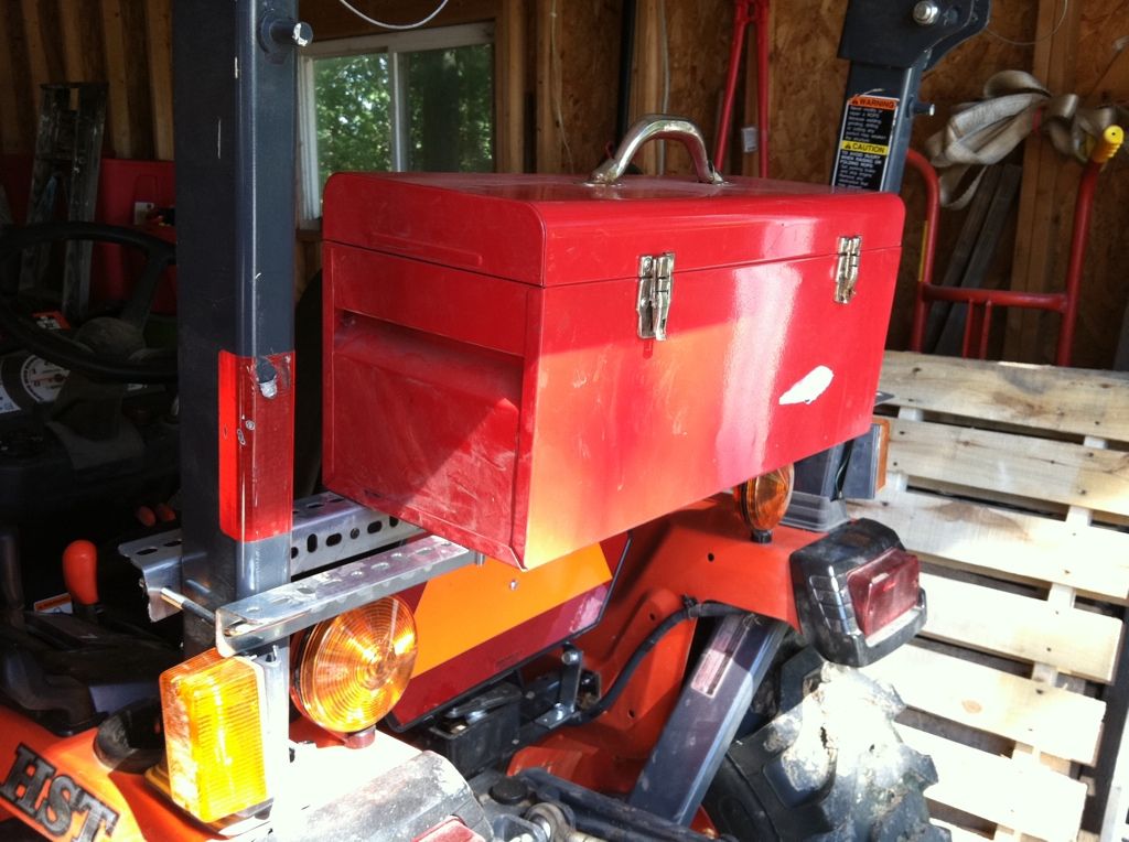

This is where I store chain, tow strap, hitch pins, shackles, and a few tools.
Couple pieces of slotted angle iron bolted to the ROPS with U bolts, and a cheap Harbor Freight steel toolbox bolted to this. I lined the inside with waffled rubber toolbox drawer liner to keep stuff from making too much noise.
Lots of weight way above CG.

That's a great idea! I don't have a step there, but have been wondering where I was going to put a box. That is the PERFECT place.
