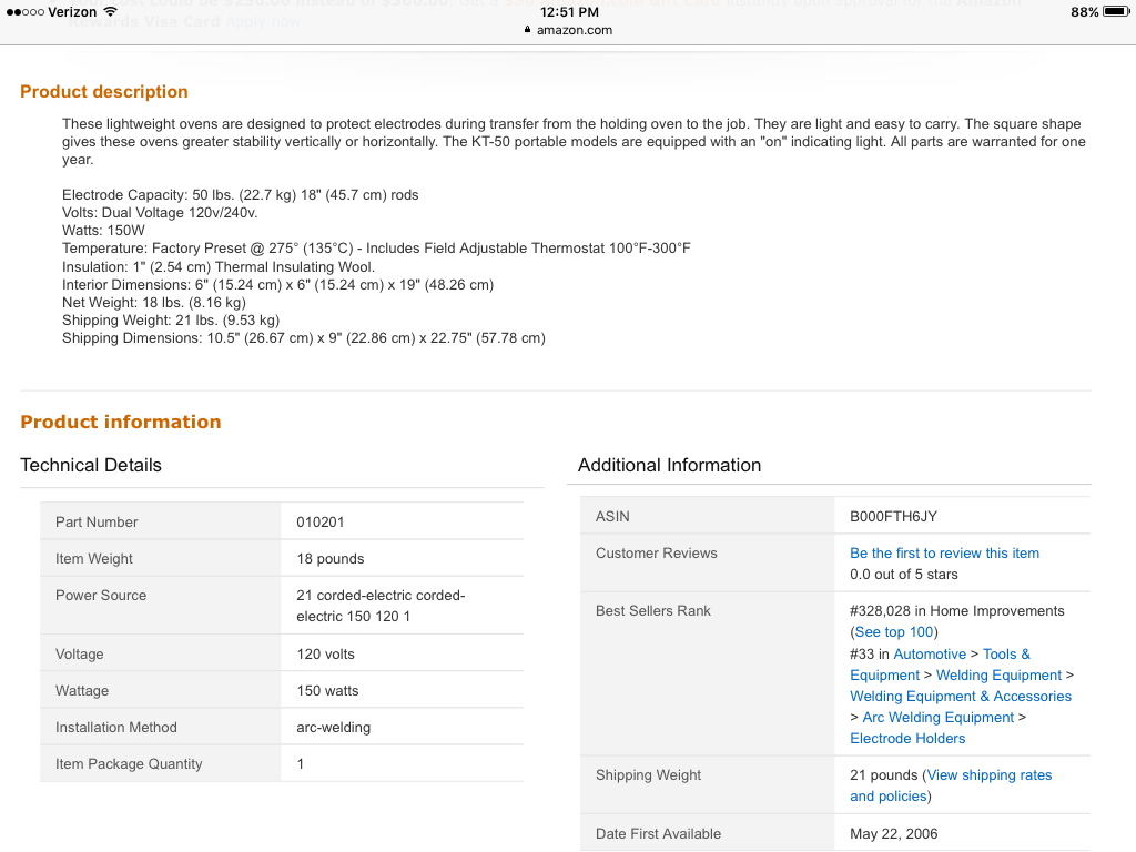

"the 50lb rod ovens like mine only have a 150 watt element and are thermostatically controlled." <<<I found it.....not, on second look, there's no such animal...
Keen KT-5 Holding Portable Welding Rod Oven (12V/24V) - Maintains up to 5 lbs (22.7 kg.) of 18" (45.7 cm) electrodes at optimum temperature. - Arc Welding Equipment - Amazon.com
I'm confused, you found the right one - 150 watts, thermostat controlled.
I bought mine used for $75
   / how do you store your welding rods (7018) #59
Electrode Capacity: 50 lbs. (22.7 kg) 18" (45.7 cm) rods
Volts: Dual Voltage 120v/240v.
Watts: 150W
Temperature: Factory Preset @ 275° (135°C) - Includes Field Adjustable Thermostat 100°F-300°F
(Temperature Factory Preset)<<<This part threw me off, then it says>>> (Adjustable Thermostat) <<<That's how I got confused, because to me it's a confusing product description, cant make up it's mind, is it right left, up down, in out or hot cold. Sounds like we both got kunfused, atleast you straighten it out. $75.00, I'd buy that all day long.
