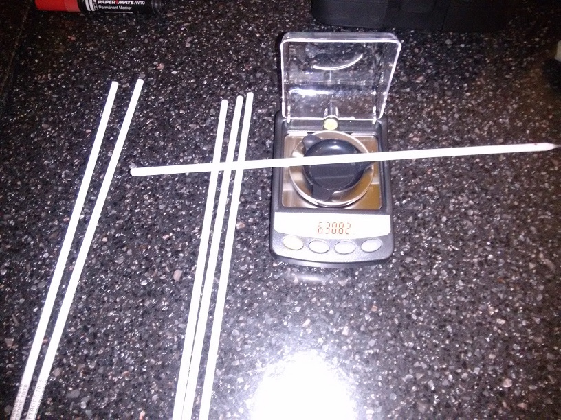

A week ago I put some recently opened 7018 in an oven to make sure they were completely dry. Afterwards, I took a few rods and marked, then weighed them. They then went back on the scales regularly to see how fast and how much water they took up from the air.

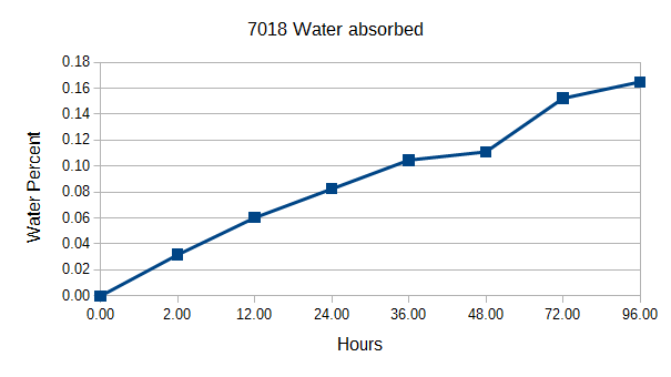

This is what happened to those that were kept open to the air inside the house (at this time of year the relative humidity in the house is 35-45 %)
Using the 0.4% max moisture content that Lincoln quote suggests that even after being exposed to the air for several days, these would still be fine for use for any application.

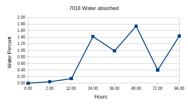

I also left some rods outside, but under cover from any rain. Weight gains (and losses !) on them tell a different story. I'll put some figures up later.

This shows how much water the 7018 rods took up when I left them outside. They were open to the air under a roof, so neither sun nor rain could get directly to them.
For the first 12 hours, although the moisture increased gradually, it was well below 0.4 percent. After that the weather changed and the moisture absorbed went up much higher.
What is interesting is that the moisture content doesn't stay permanently high, it goes up and down. If you look at the 72 hour point, it has actually gone back down to the Lincoln recommended figure of 0.4 percent. As Beezfun has said, this suggests that you don't necessarily need the elevated temperature in an oven to dry out a "damp" rod, all it takes is a drier atmosphere.
Shield Arc, when you showed us that picture, pouring water out of a can of rods, could that be because the air had cooled below the dew point, so when rods loose some moisture back to the atmosphere, it then condenses out on the inside of the cold can ?

An interesting experiment, thanks for doing it. I wonder if the .4% figure is based on the weight of the whole rod or just the flux. It's unclear to me in their literature. Maybe I'm overthinking it.
Yes, I think you could be well be right about subracting the weight of the steel core before calculating the 0.4% pass level.
Guess the only way I am going to do that is to strip off the coating and weigh the core. That means wasting the whole rod ! I am a real cheapskate and that is going against my better nature, but I suppose it's got to be done :)

That might also eliminate the possibility of contaminating the rod ends as you handle them, which could easily skew such minute data points.
