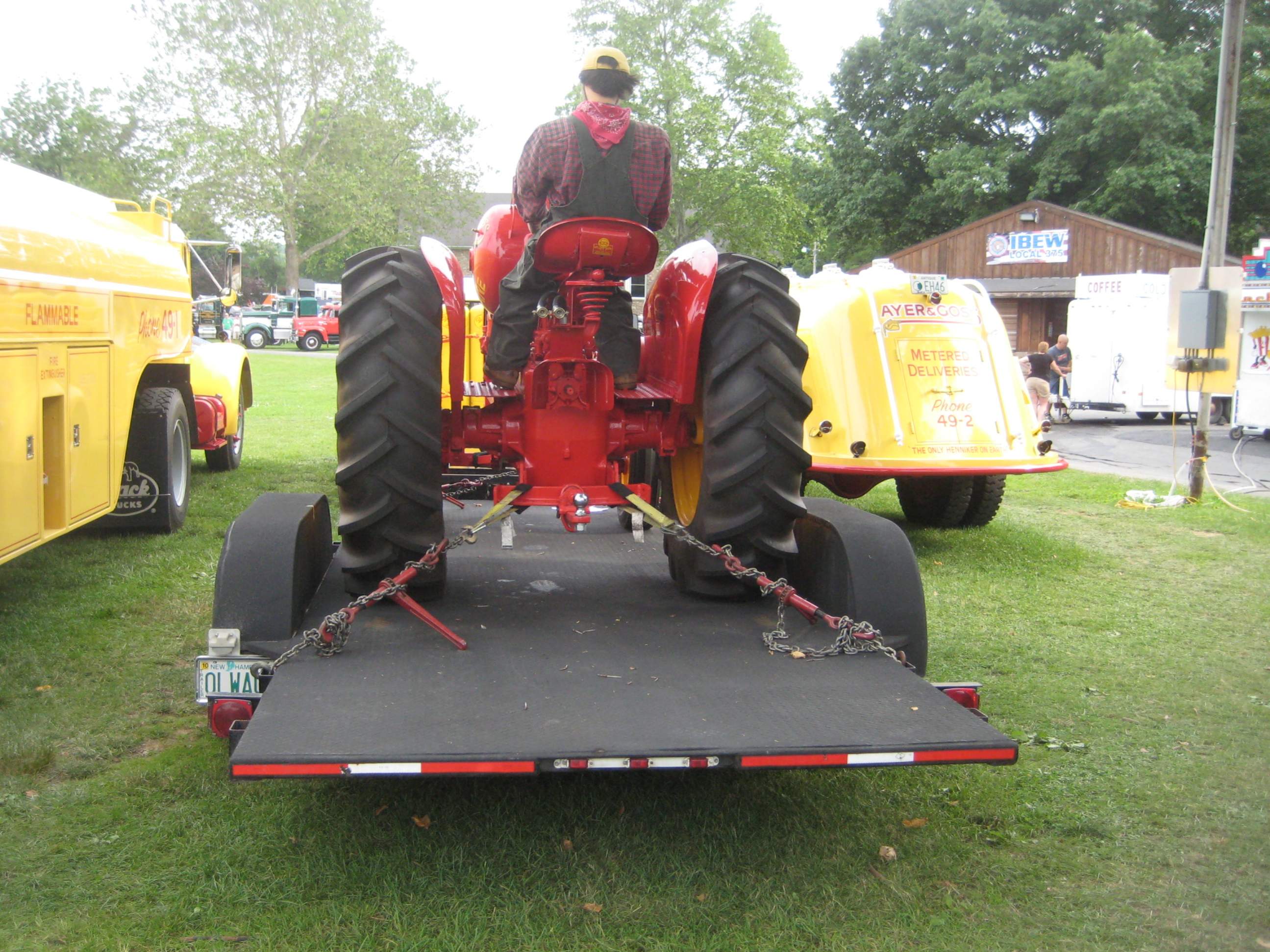

I am curious to know how various people do this -- I am looking into hauling a CUT on a 76"x14' landscape trailer (tandem axle with wood decking and rear gate). This trailer looks ideal for me, but doesn't have tiedowns, and of course with a wood deck there are no chain slots.
I know landscapers around here don't even tie their equipment down for local transport -- they drive on and set the brake.
Tie it down like its done in these pics that I took this past summer at a ATHS show in Macungie,PA.
