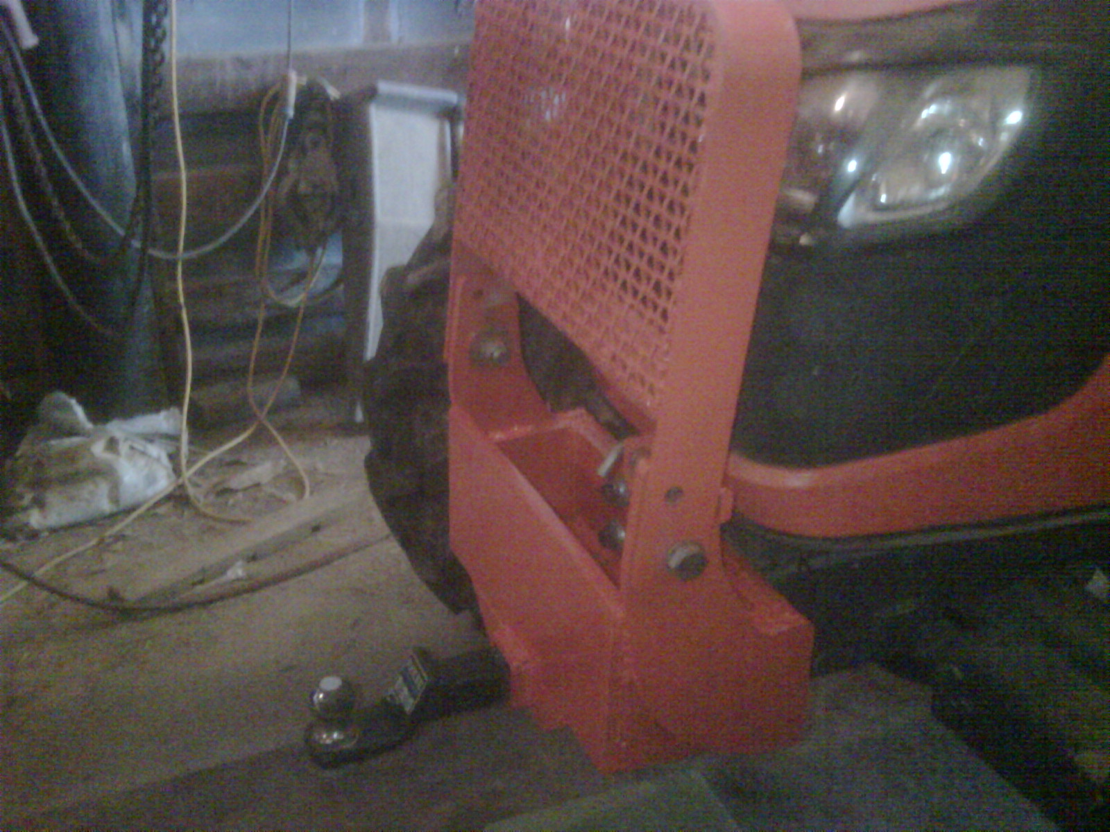

I have thought about welding a heavy duty D-ring or G70 hook or an eye for shackle on the sides of my customized brush gaurd. This would make it eaier to tie down with 2 chains on the front. Any negatives to doing that as long as I make good penatrating welds?

   / How do you tie down tractors when hauling on a trailer? #168
You might consider using that receiver tube like the guys that are using the draw bars in the back.
I would prefer 2 points out near the corner like you mentioned. A good weld on a structural member becomes part of that structure, like a D-ring on a trailer frame.
I wouldn't go up to far on that brush guard, but maybe where that bolt goes thru, you could find some kind of ring that you could put under that bolt?
Or drill a hole to install clevis shackles.
