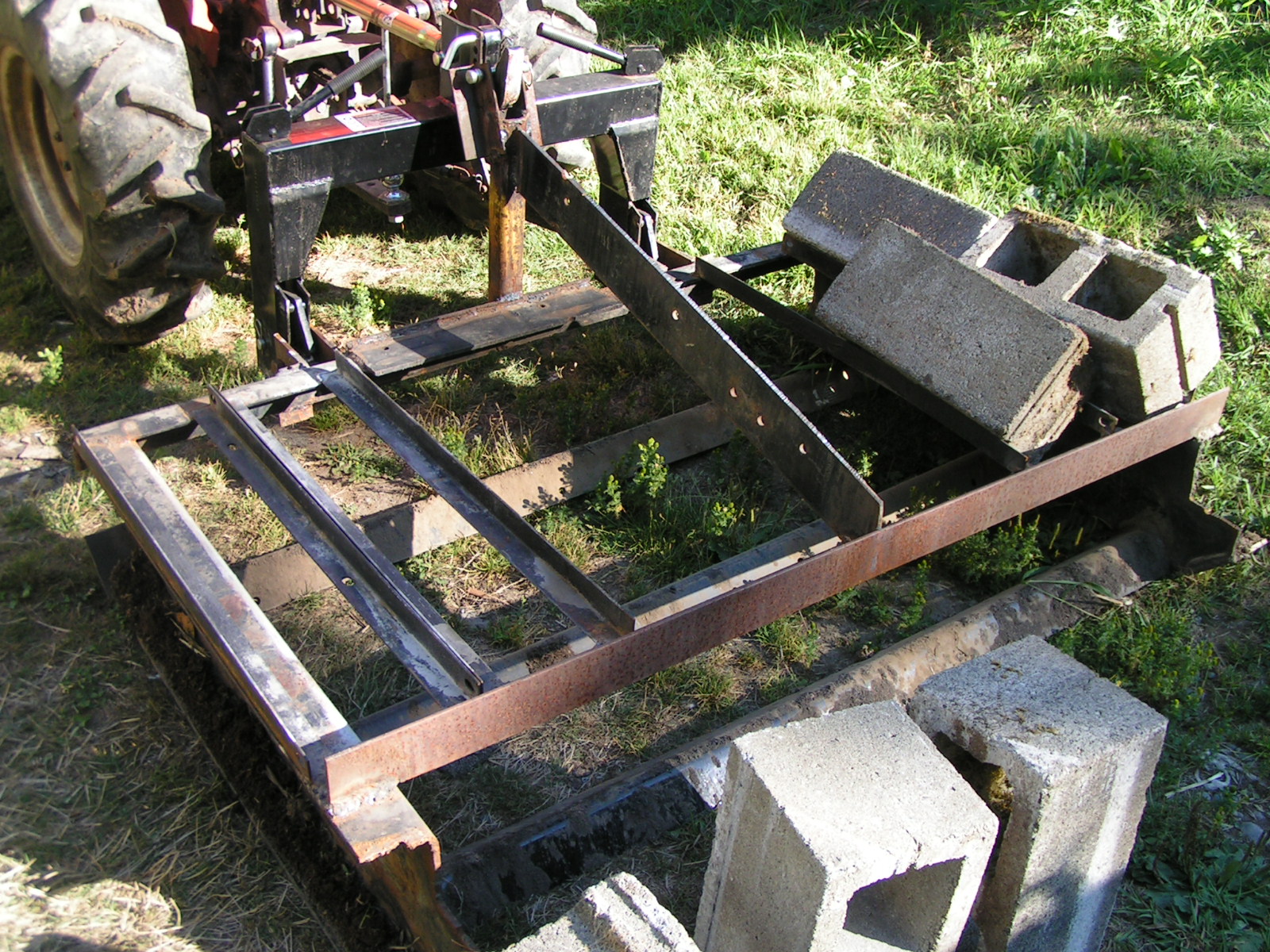

Fel's are not the tool to use on a driveway most of the time, here are a couple of pics of the driveway grader I built for around 60 bucks. Works great for me. Just drag and it lifts up the gravel and the fines, cuts the grass crown off, and fill the pot holes.
