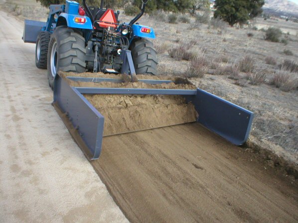

When the ground is damp, I can move way more material with my land-plane grader blade than with my box blade, both are 7' wide. The sides are 8' long and 2' tall. In the picture there is 50+ cubic feet of dirt being moved where as my box blade would be pretty much maxed out with about 30-35 cubic feet. This would not hold true for moving rock-pea gravel though.
