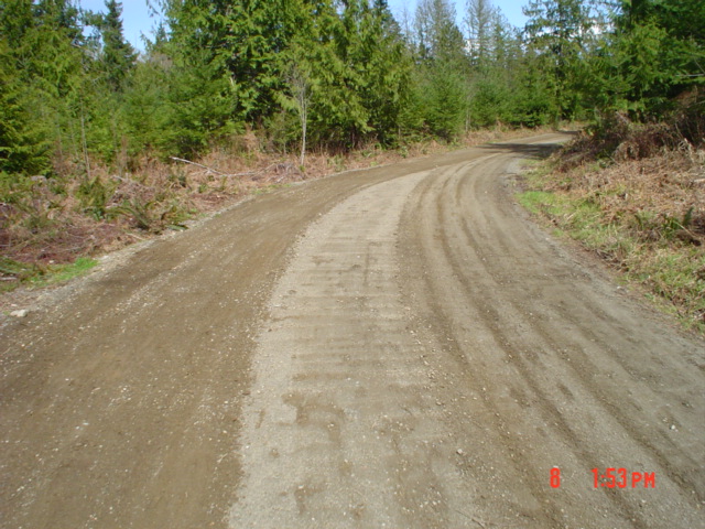

I bought a used box blade for doing our private road, does a great job. No way would the FEL be suitable for this job, our private road is about 3/4 mile long. It does pay to get the right tools for the job. :)

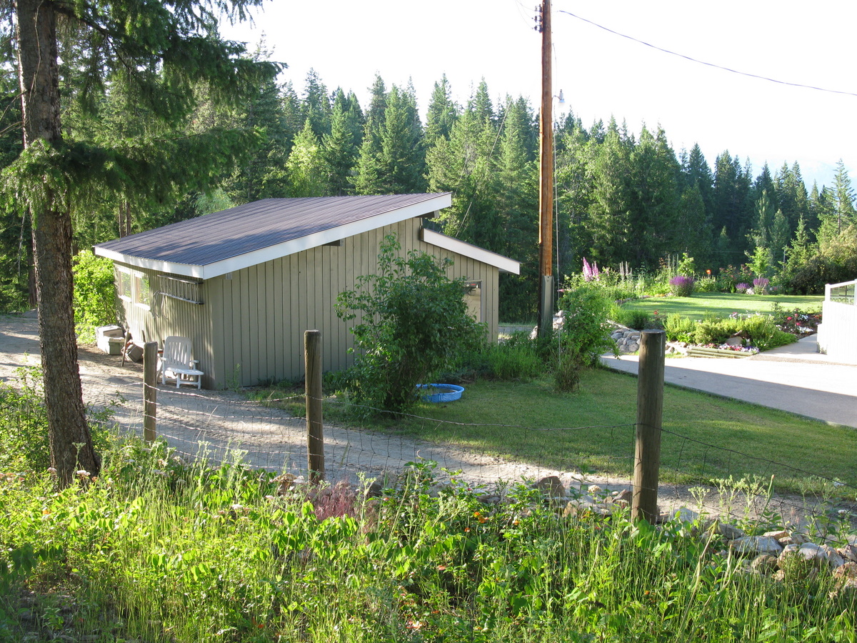

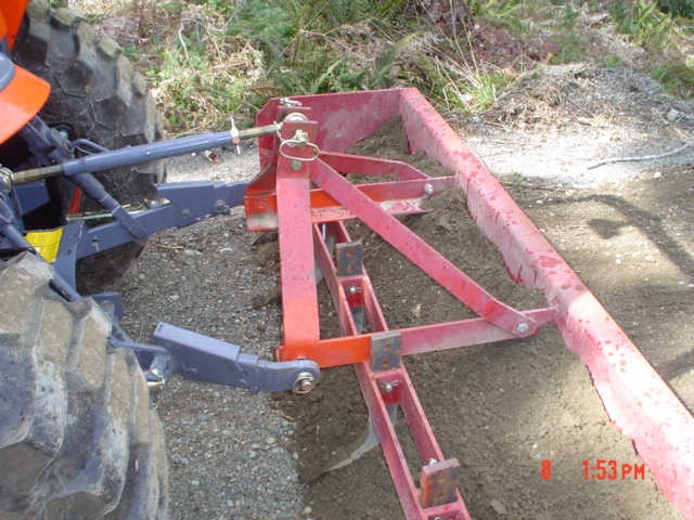

I find a landscape rake is excellent for maintaining my approximately 800' of gravel driveway and parking areas. I also have a rear blade if required and have used the cultivator as a ripper to shape new trails. A box blade and rippers would be best for more aggressive shaping. But once you have it in shape a decent base of small road gravel will be easy to maintain and re-shape with less aggressive equipment.
I am no expert, but I would not use a compact utility tractor's front end loader for road grading/shaping work. I think they are not meant for the repetitive shocks and stresses of that type of work.
I have a Farm King 6' rake without guage wheels which is good quality:
Farm King - Landscape Rake

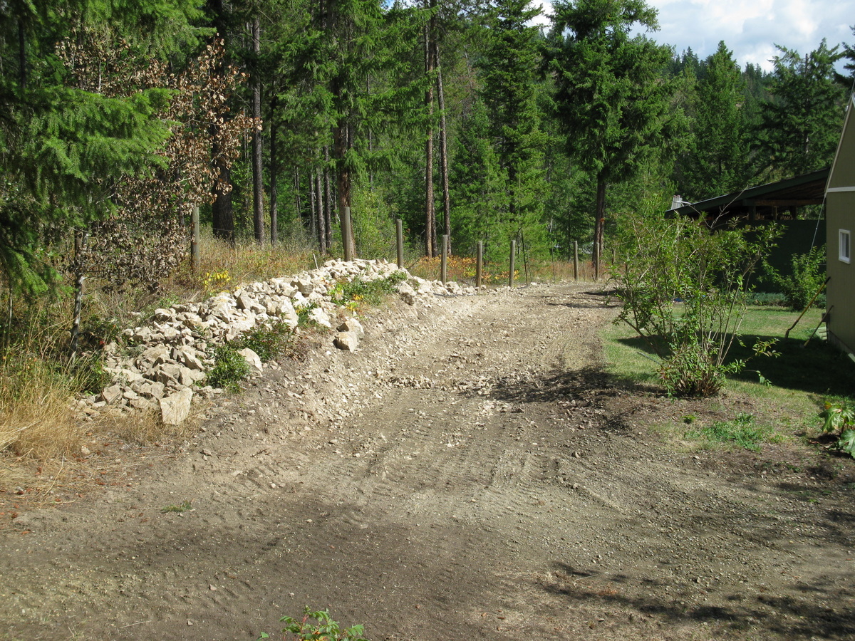

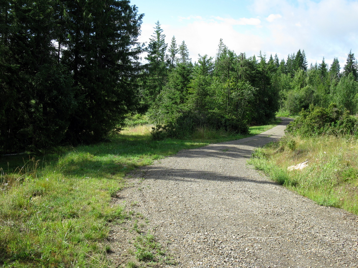

I've attached a photos showing:
- a section of my driveway that I maintain with the rake
- a section I cut down last year using a box blade, pick/shovel/sledgehammer and now maintain with the rake
- new driveway with added road gravel (plus I renovated the shed)
